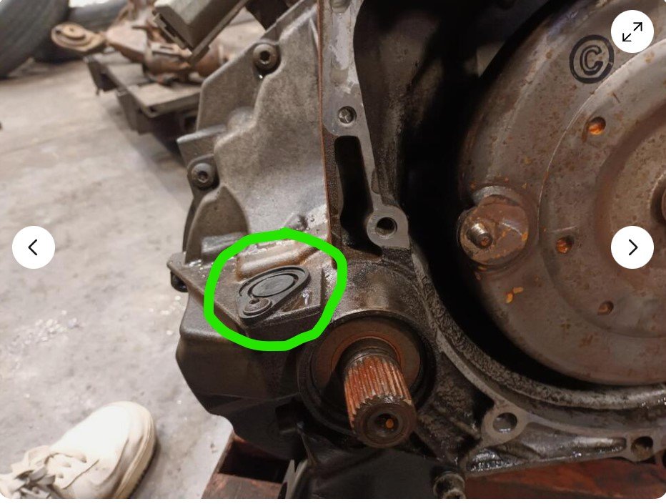

Think you may be looking at the wrong sensor, the road speed sensor has three wires & is located on the diff of the gearbox, its hall effect so you cant really resistance check it.oldbill wrote: 06 May 2024, 11:25
The speed sensor is located on the AL4 autobox just above the output shaft, its a two wire sensor with a resistance of 1.75k between the wires.
Should look like this > https://www.ebay.co.uk/itm/255138015912 ... 1&mkcid=28
The sensor is fitted here where this blanking plug is

wheeler
- Posts: 7932
- Joined: 21 Sep 2002, 19:07
- x 1056
Re: Peugeot 206 auto. Speedo goes off and lumpy gear change
Can you post a pic of the sensor you replaced?
The road speed sensor should be in that location & should be a 3 pin plug. Ignition live, earth & pulse output. All 12v & the signal is a square wave output.

wheeler
- Posts: 7932
- x 1056
Thats definitely not where the road speed info comes from, if it has a road speed sensor then its fitted where the blank is in the pic above, if your gearbox has a blank there then the road speed info comes from the ABS system.
I think the sensors you have changed is an internal speed sensor for the gearbox speed not vehicle speed.
