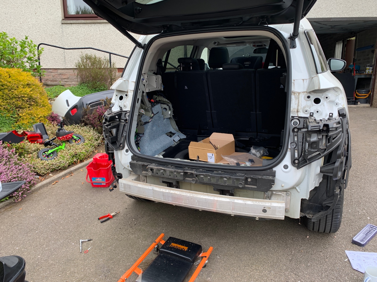

Make sure you cut enough bumper away around towbar - I was maybe a bit neat with it and it cost me time.
Rear foot sensor for boot needs ‘tweaked’ to fit once you cut the bumper for towbar. Some cable ties can help with that.
Be careful pulling bumper away around the rear light areas, lots of tabs etc that could break.

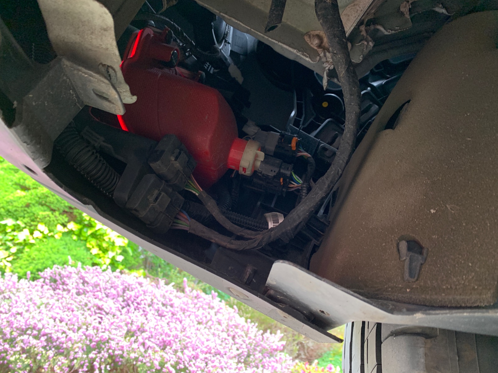

Check under passenger seat carpet for wiring loom connection - if its plugged in you probably have towing loom part installed. Also check up behind under rear bumper passenger side for the 2 plugs in my photo above. Will save you pulling interior apart. You will still need the boot panels taken off to install ecu etc.
