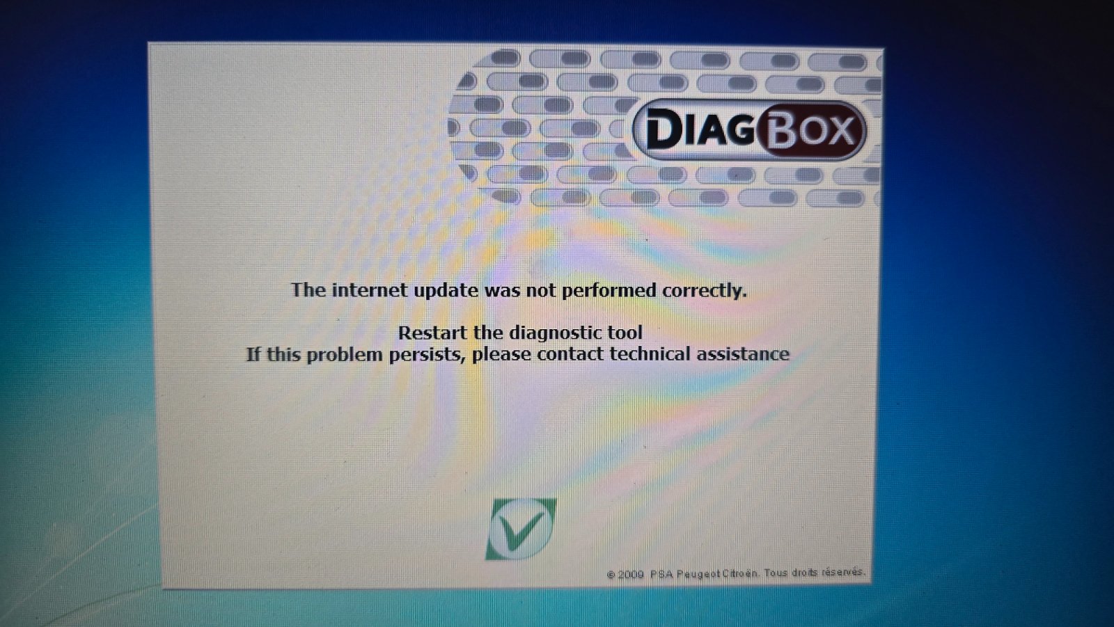

I've had this computer for years that has been working, however I tried to connect to a newer C4 Vactus and was experiencing problems, so attempted to Offline update it. I've now got the error as seen in the picture. Please advise on how I fix this. Thanks

This all depends on how you updated it? What version was it on to start with and what update version did you try and install?

Re: Diagbox Offline Update not Working
Hi, It was on Version 07.62 and I successfully updates it to 07.66 then tried to backdate it, and I'll be honest I've lost exactly where it is at now as I can't launch it.
Looks like it has deactivated. You'll probably need to locate your backup licence file and copy that over the current one.
If you've applied the update, restarted the system, the update should apply after it restarts when launched again.

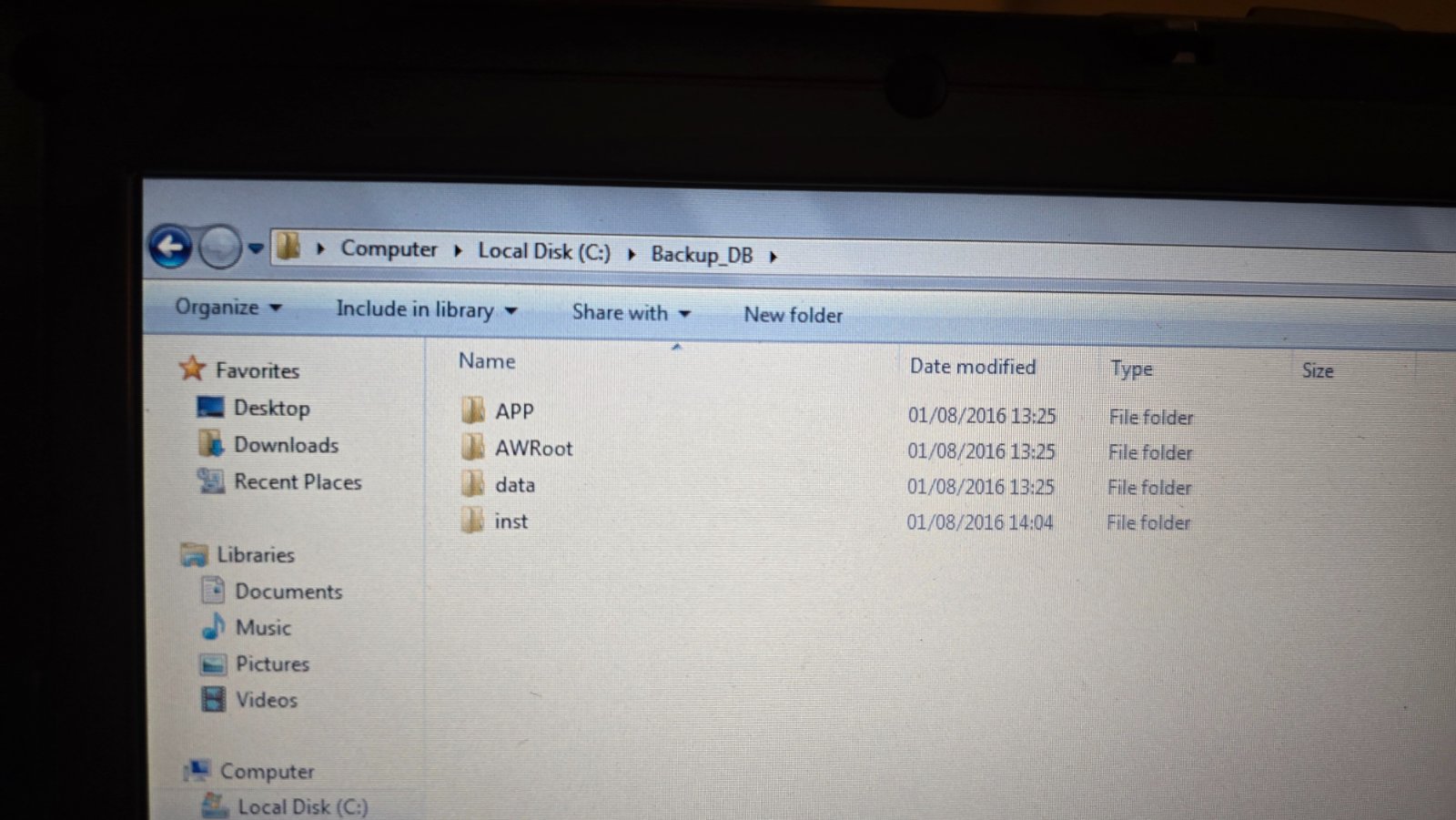

Evening, Thanks for your input so far. Would it he something in this file structure? Please could you advise how I do it. Thank you

Your backup licence is called: APPDIAG.SYS
You need to copy the backup taken of this file after you originally installed and activated Diagbox from wherever you backed it up to on your laptop and restore it to the following location:
c:\awroot\bin\fi\
and overwrite the destination file if prompted.
Then restart the laptop and try launching Diagbox. If it does not launch with an error, then the last update applied has not been installed correctly and needs to be reinstalled.
c:\awroot\bin\fi\
I've done a full search of my system and can't find the backup file, just the actual one. Do I have any other options? Cheers.
Try reinstalling the update again (the latest version you attempted previously) making sure you install it correctly:
Apply update and restart computer (do not try and launch Diagbox again after the update)
When computer restarts, launch Diagbox - the update will apply itself.
Wait until it has finished.
If this doesn't work, and the programme has deactivated, then without your licence file you will have to uninstall the whole programme, clean up all files and folders created, and the registry entries and reinstall from scratch.
The APPDIAG.SYS file is unique to each installation as it uses hardware identifier codes from your system to create a unique licence - so obtaining one from somebody else will not work.
Just to be completely clear, you, as the program installer, have to make the copy of APPDIAG.SYS for your own benefit in the future. It doesn't happen automatically. Instructions for doing this are normally included with the Diagbox kit when you buy it and there are videos on YouTube on how to do this.
I've had to copy the backup APPDIAG.SYS over the program's APPDIAG.SYS quite a few times so it's not a theoretical thing.
