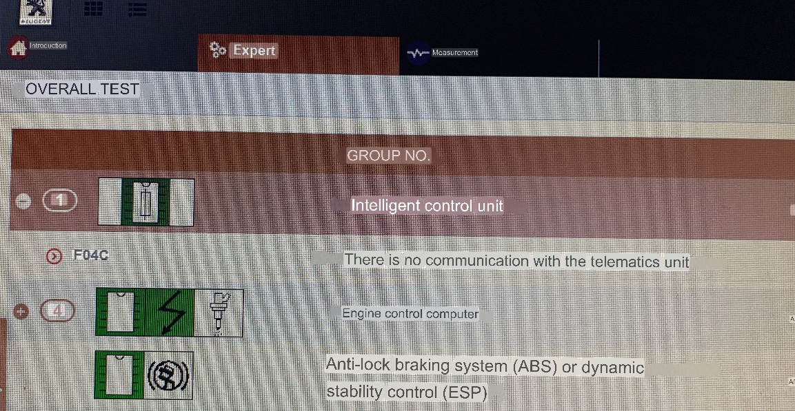

Hi ! I did a bit of investigating with diagnostic tool and the results are here:
1.I started by fault scanning nothing was there
So I played music and turn the car off scanned it again and there was fault in bsi F04C

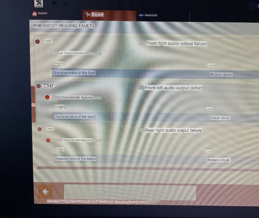

Scanning further i found 2 faults in amplifier CD2A and CD2C

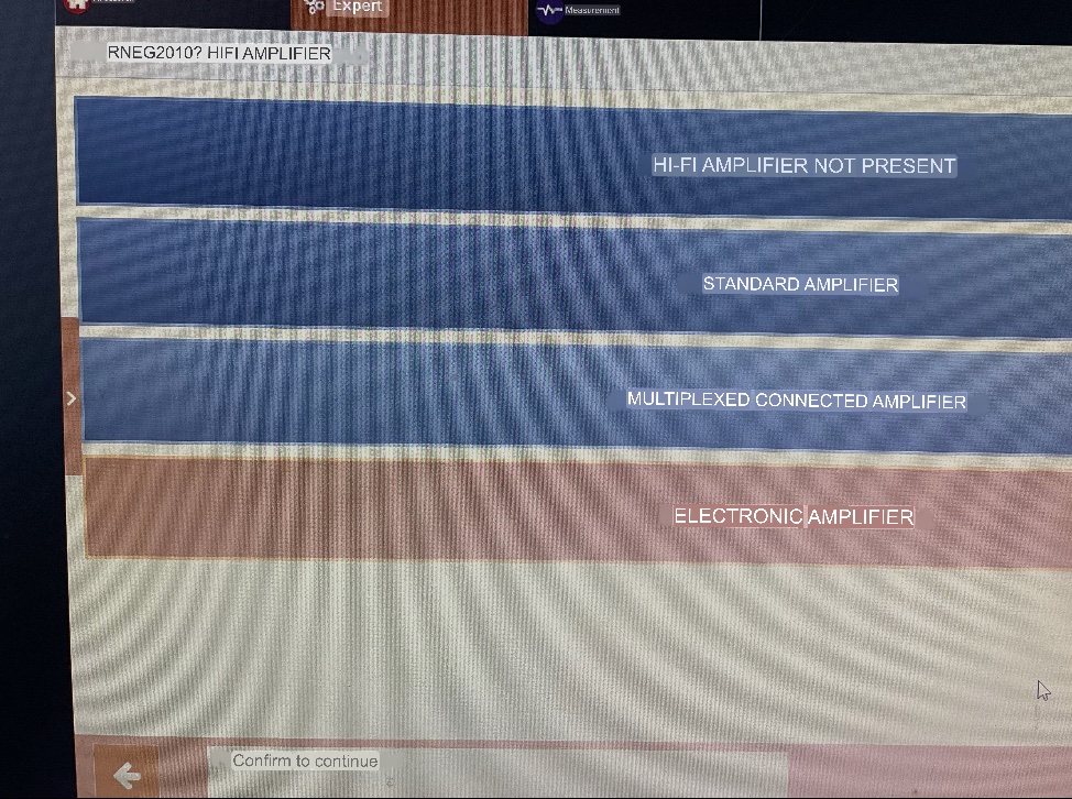

2.On one photo are amplifiers with you can choose but I don’t know what kind of I have so i tried to change the amplifier type to electronic one but that didn’t work and the faults in radio are after this configuration.Before that I didn’t had any fault in radio and it was set on multiplexed connected amplifier.

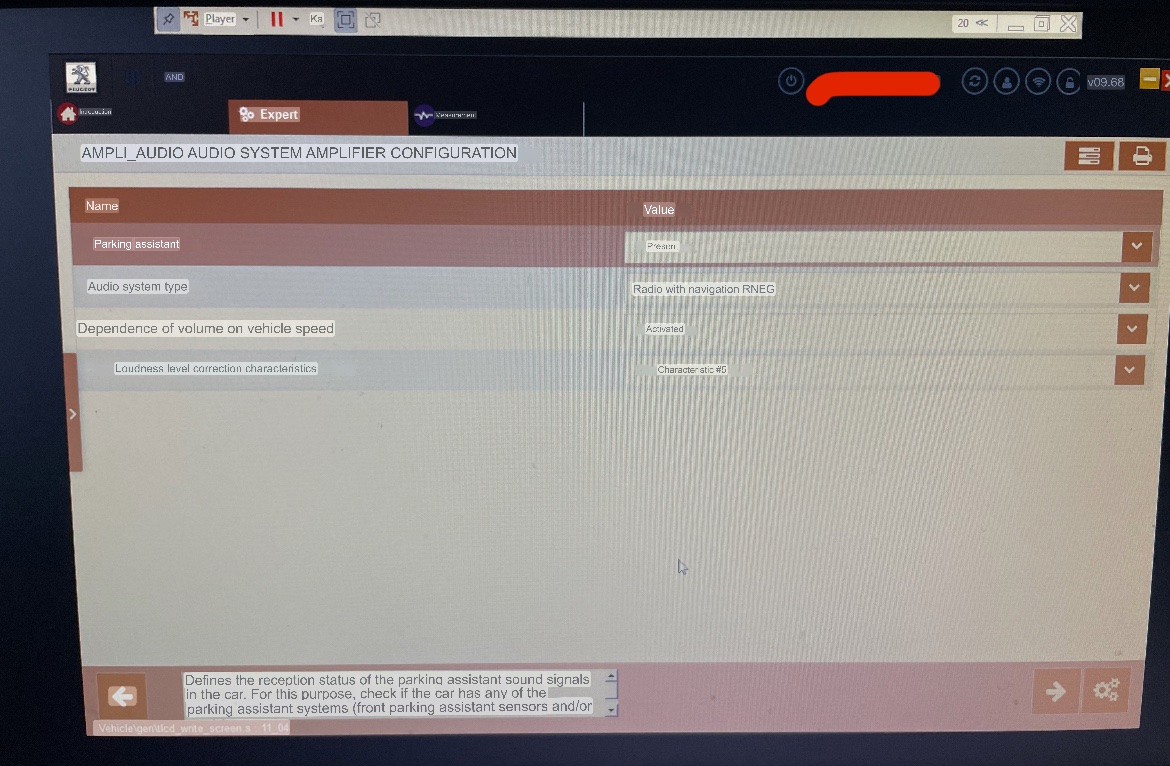

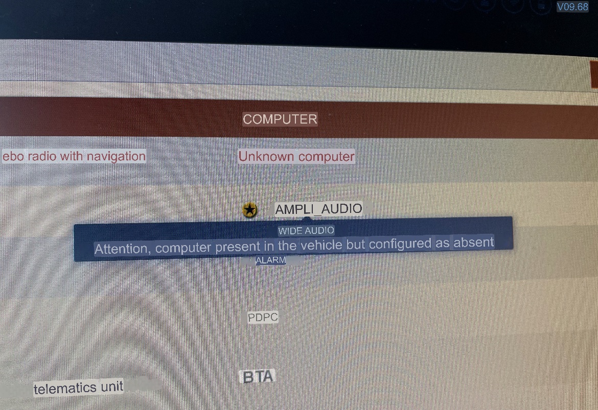

Hello opening this topic again i was changing the egr valve and I noticed this strange thing in diagbox
In with places amplifier needs to be coded ? I did it in radio and in bsi a setup equaliser

Yes there are settings for configuration / selection of an amplifier system in Diagbox, but these can be different types (multiplexed or non-multiplexed) and other types of amp, so this will affect operation. But be careful if you select the incorrect amp type as the system will expect the correct one to be present.

It only works as a multiplexed connected other types don’t work
