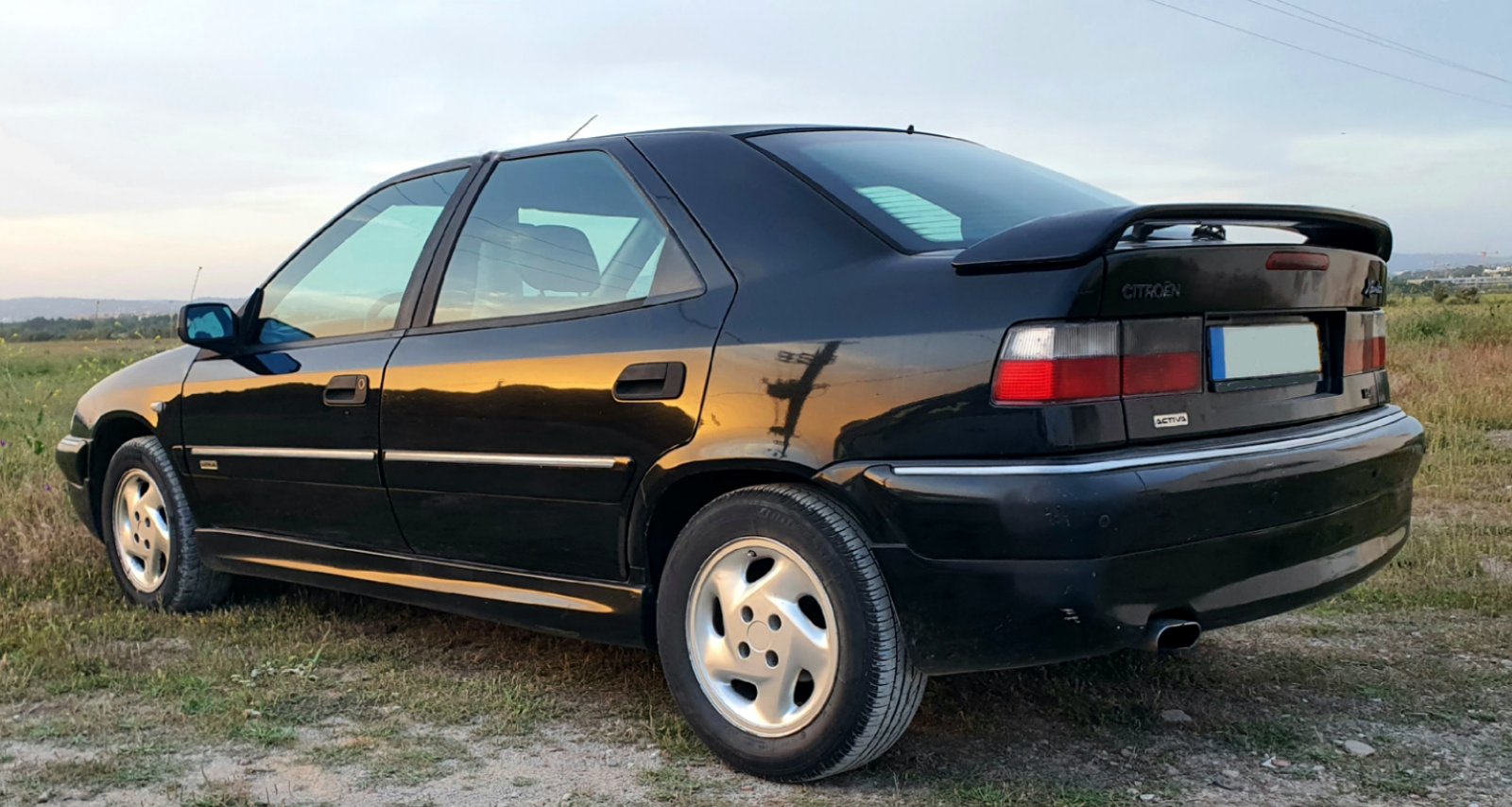

Here i leave the first photo of the (future) cornering machine:

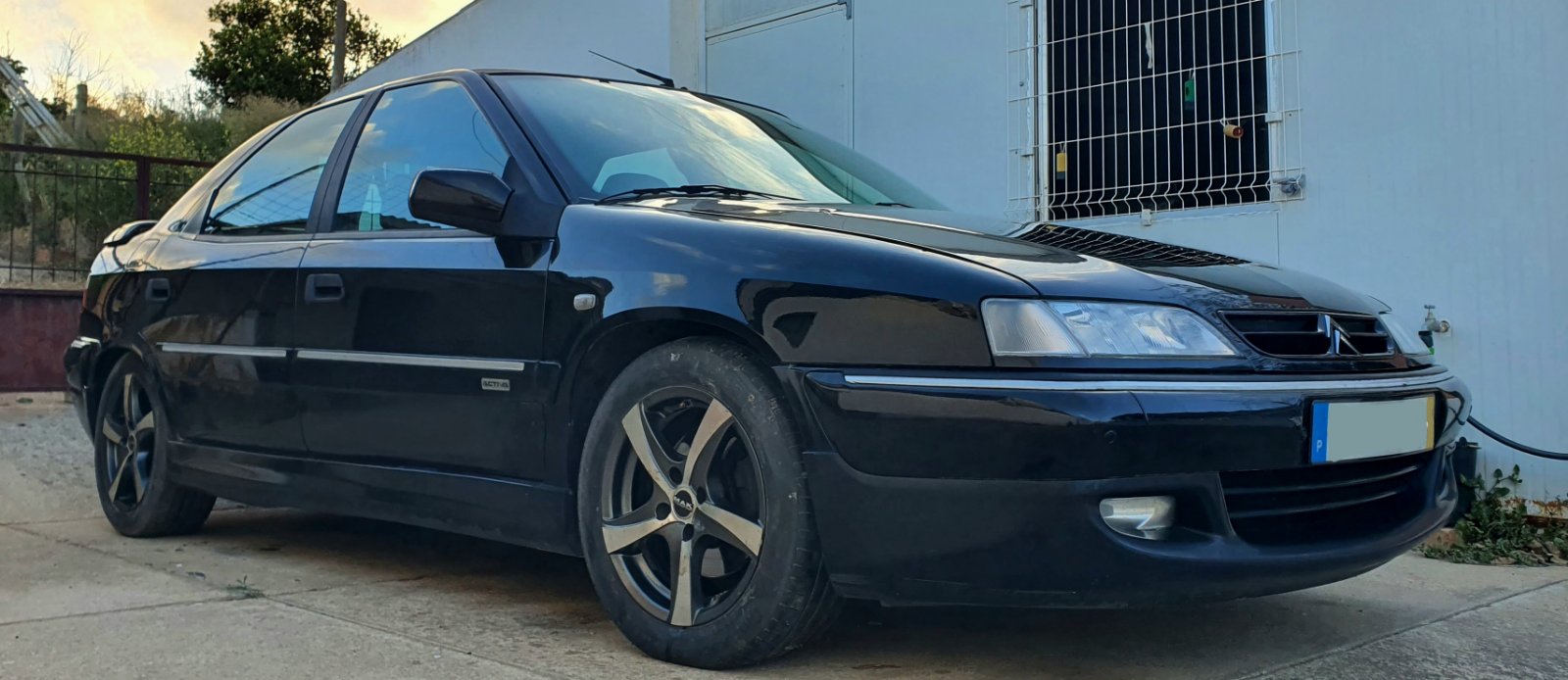

As a bonus here's a pic from today , after some work , a good wash and some wheels (16) that i still had from my previous activa, fitted.
The old guy Is looking good :P
