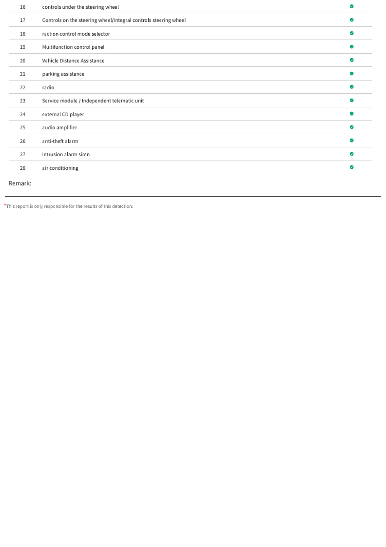

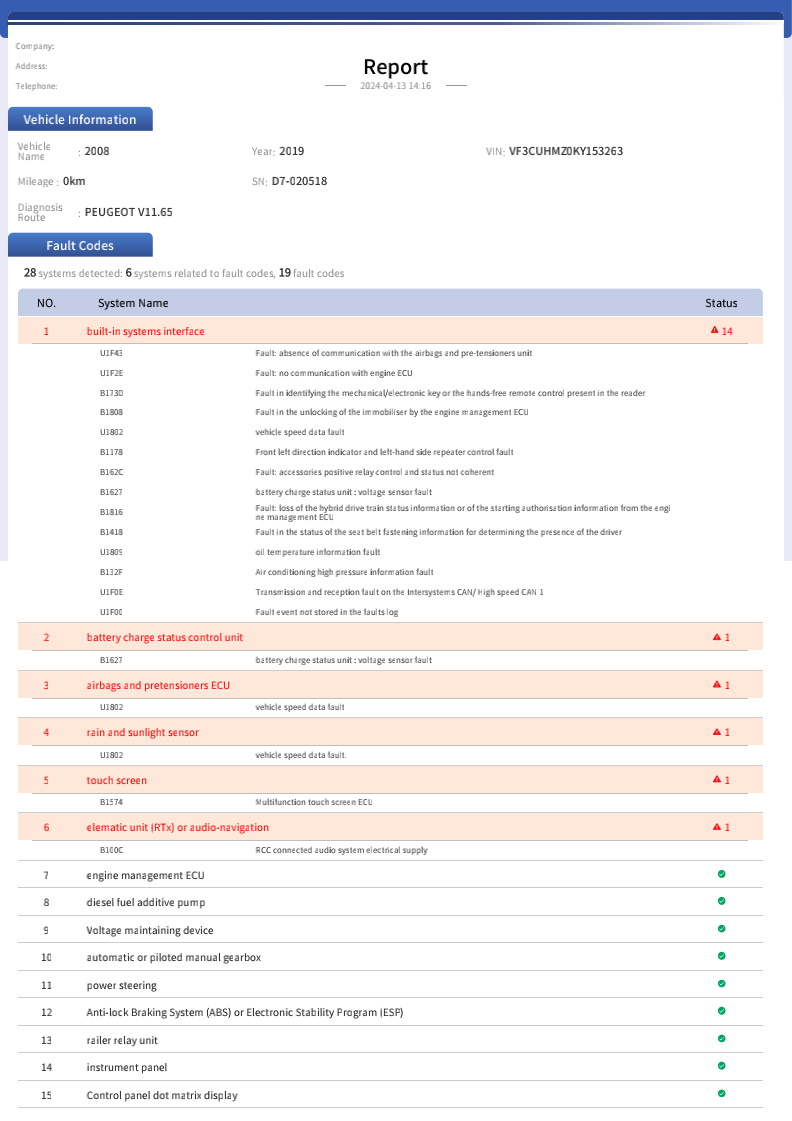

her is diagnostic report

I don't think that we can tell from that report which of those faults is current and which are historic.
There has been (and perhaps still is) something that has disrupted communication between the BSI and several systems.
