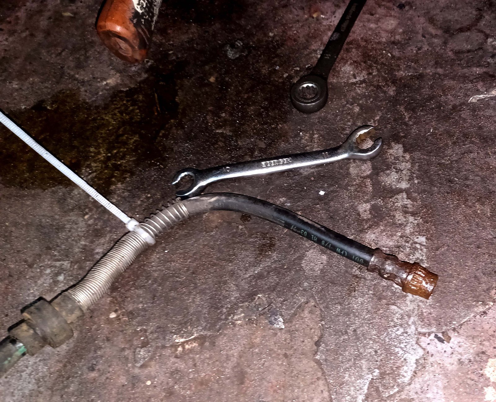

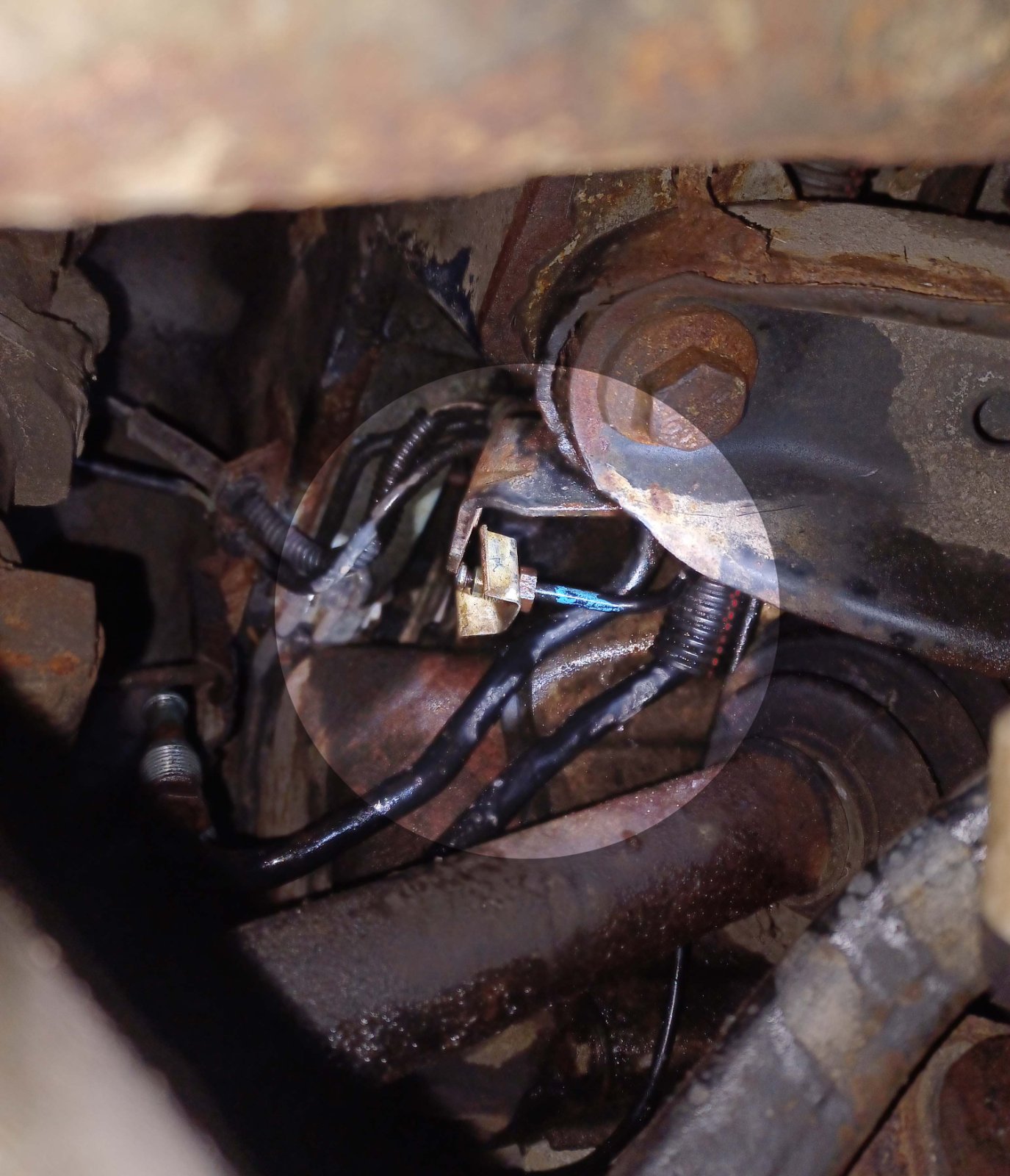

Hi Chaps, I am very slowly working on a V6 brake upgrade on the TaffyTiva 2ltr.............the original brakes were buggered and the flexi's splitting and I had a set of V6 calipers, so why not :)
Has any one got any photos of the fitting where the flexi-hose attach to the hard lines on the inner wing ?
Do they screw into a fitting (on the inner wing clip) or are they like "normal" cars, held in by a star fitting/clip with the hard line going directly into the ferrule on the end of the rubber flexi-hose.
Just to double check........assuming "normal"---- I undo the hard line behind it first then remove the clip from behind the mounting bracket and then pull out the ferrule .......I cannot just grip the old hose and spin it off ...correct ?

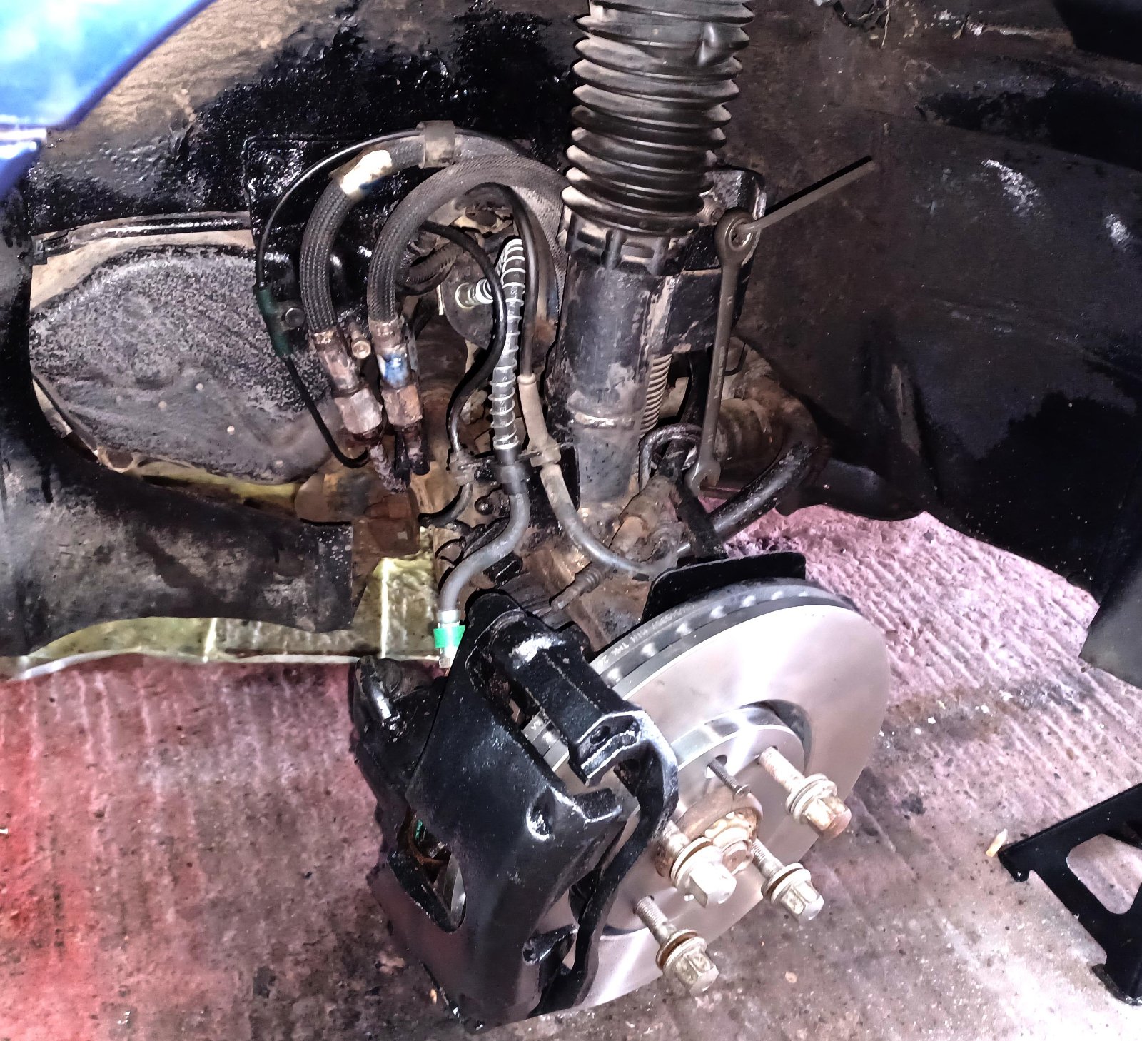

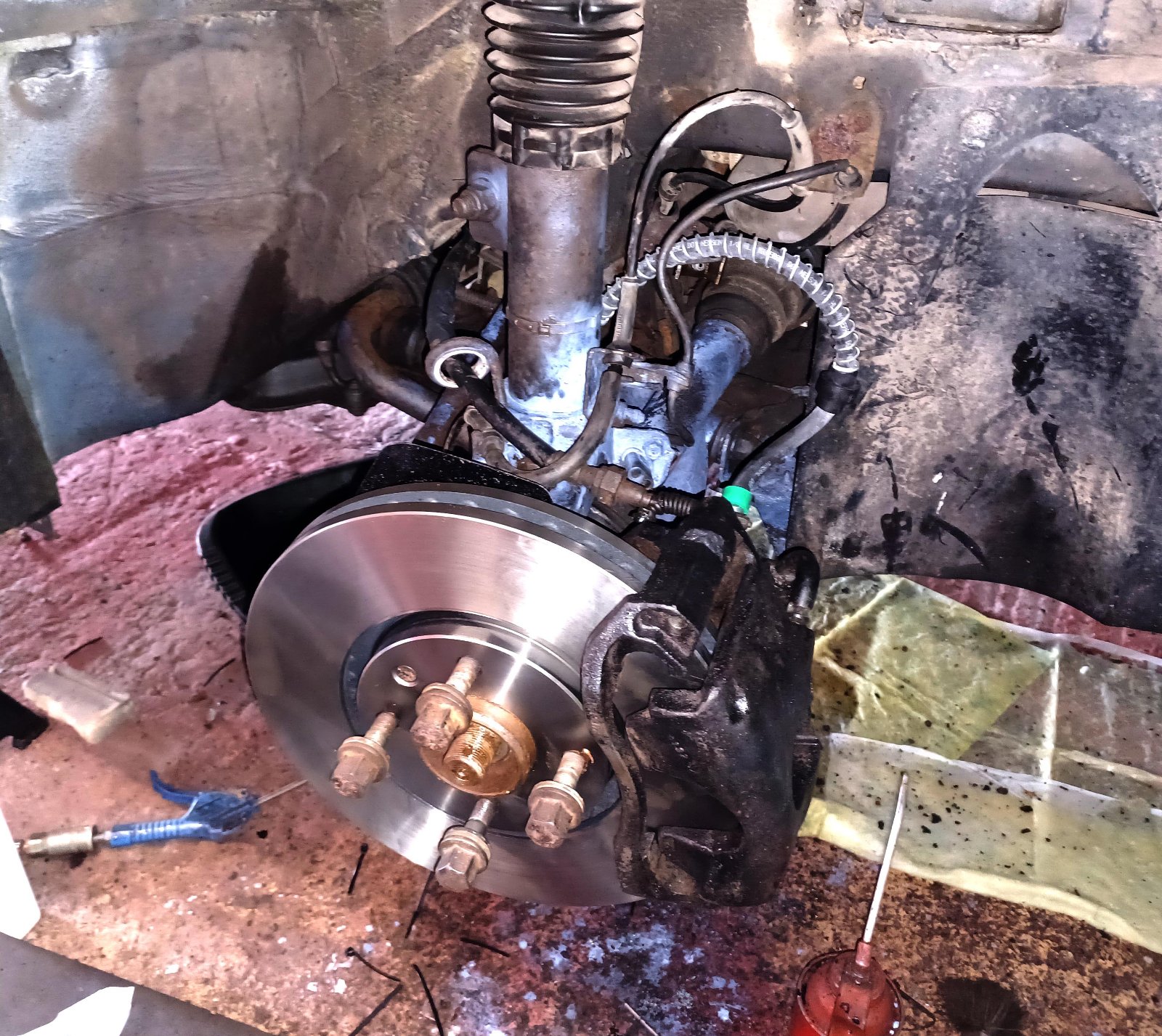

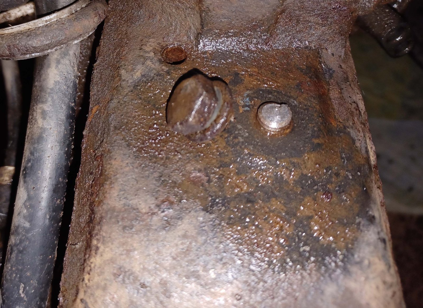

What a Ball-tugger !....as always access on an ACTIVA is a ****er. I am doing this job as I am upgrading/replacing the brakes on this Activa (283mm) with a set of V.6 brakes I have kept from the old "Green Goblin" v.6 I scrapped years ago. One twist in the tale was that this car has had incorrect Hubs fitted at some time and the v.6 Bendix brakes did not fit....so I had to change these as well only to discover later that I needed to swap to longer flexi-pipes for the new calipers.
I have had to remove the SC-CAR ram and disconnect the pipes to that just to be able to get my hand in.....about 5 days soaking with plus gas. ....and only 1/16th of a turn each time with the spanner to remove the fitting :(
As I have been told before....ALWAYS start on the hardest side first, if all goes to plan then the other side will be a joy..........that remains to be seen :)
What is a very pleasant surprise is the fact that ONLY fittings inside the wheel arches have suffered during this cars 14 odd years of being parked up, even the rear hard line-2-flexi pipe is in very good shape.......yes there is some surface rust about but nothing I have seen is pitted, flaky or delaminating.

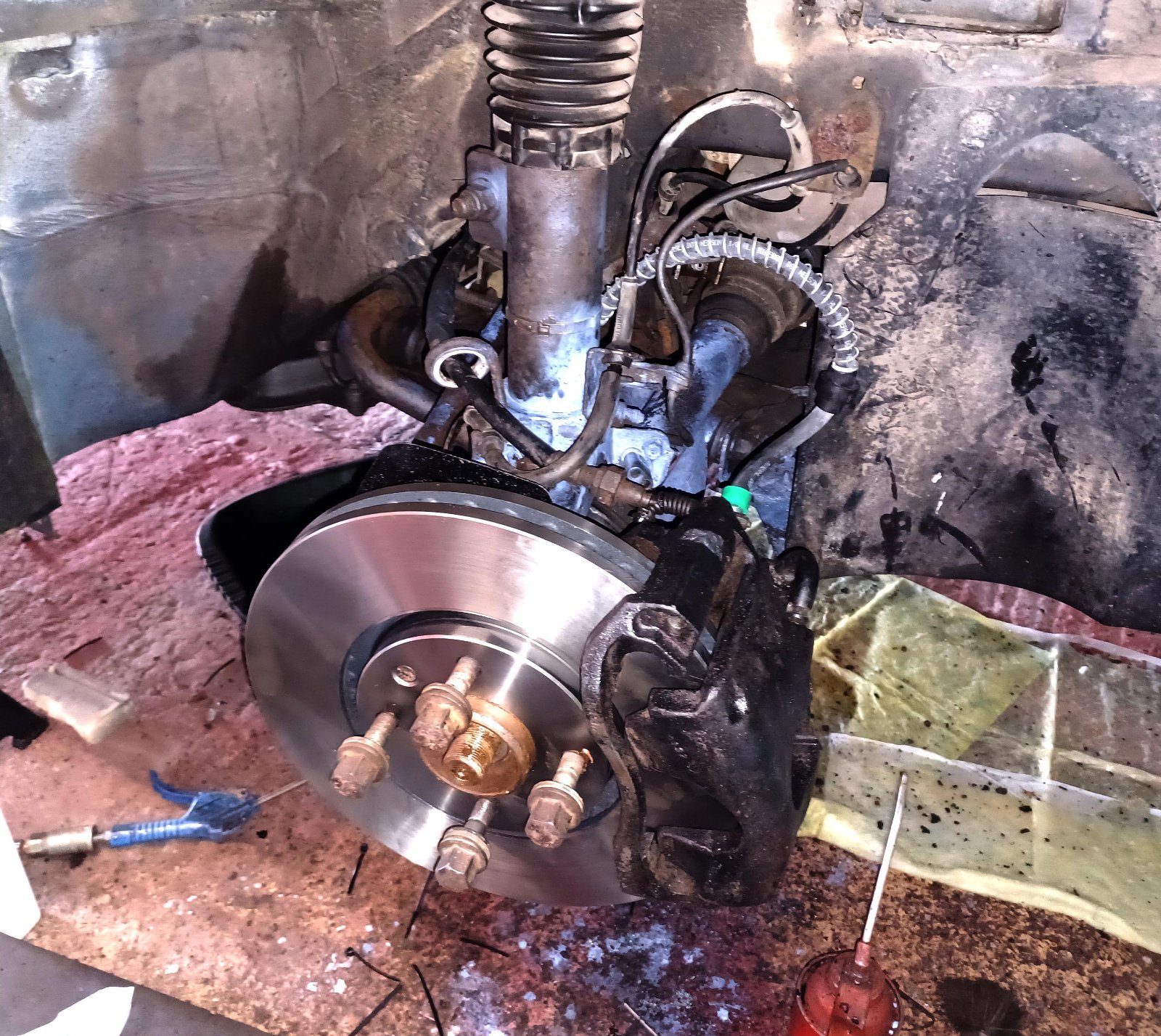

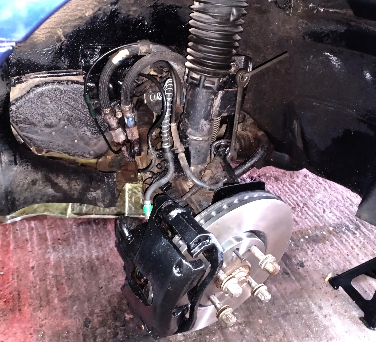

Awwwww................RATS!.and it had some heat as well ! (Need to replace the disk guard which is totally shot)
The one on the ABS sensor will be fun then !

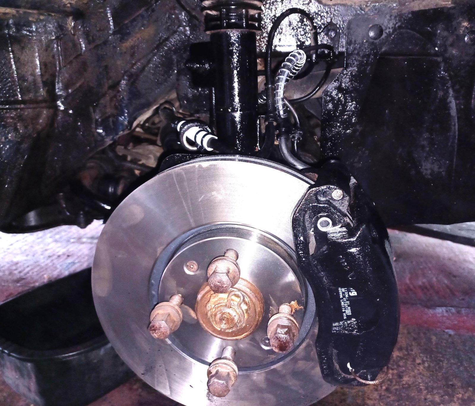

Only one thing to do then.........

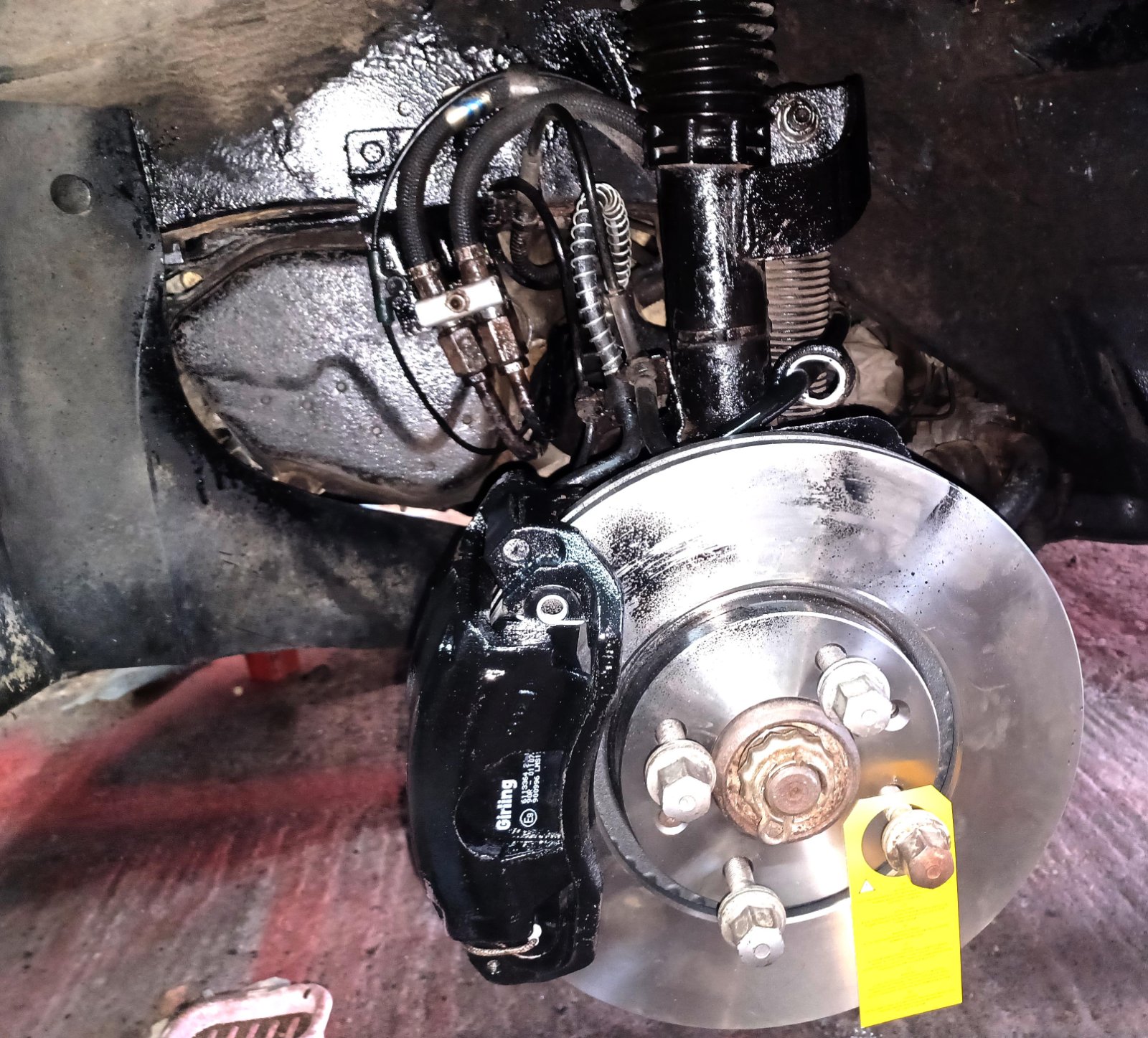

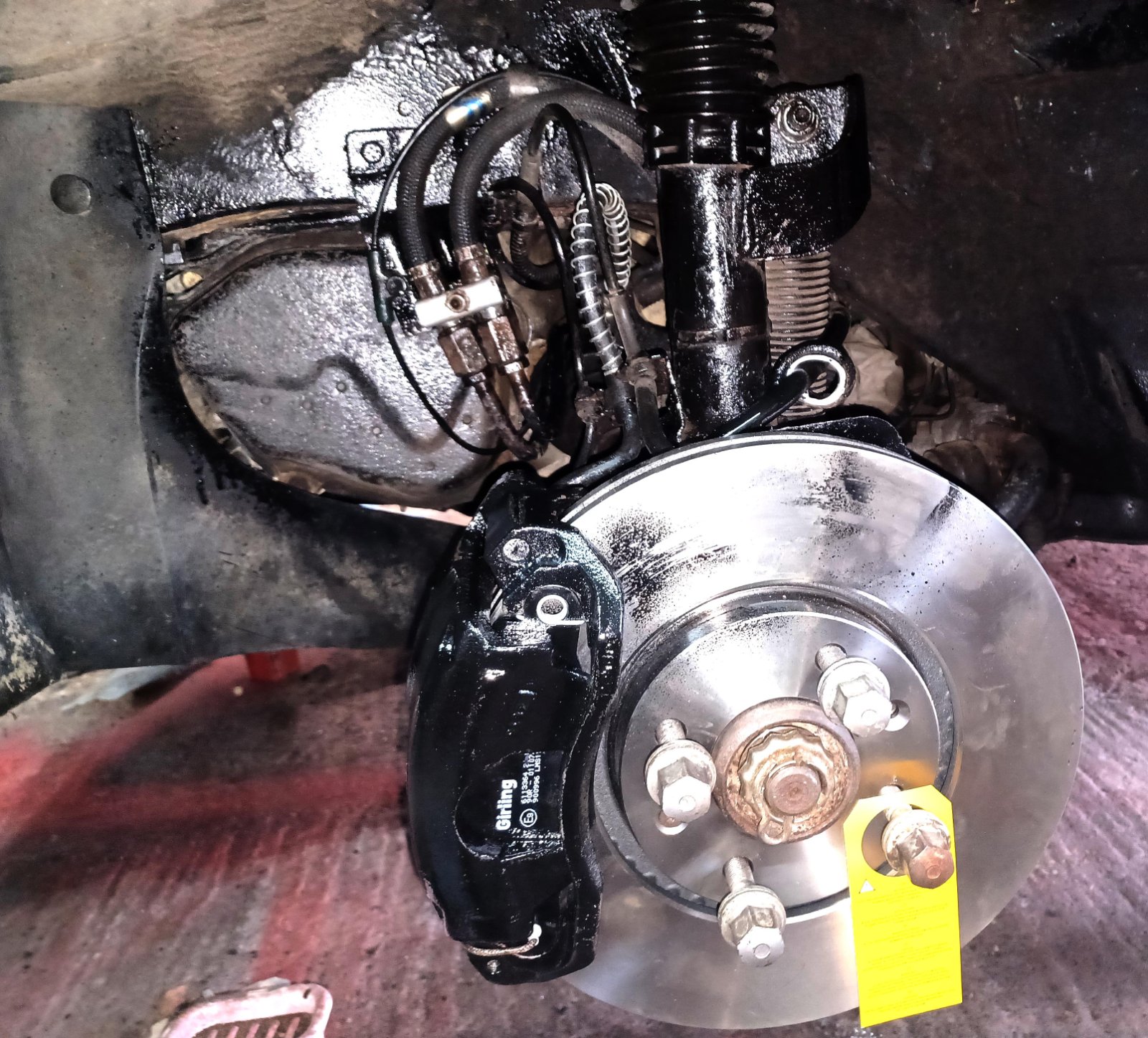

The TaffyTiva now has V6 (288mm) brakes.....both calipers on now...time to tighten everything up, insert pads and handbrake cables...them move onto the rears...

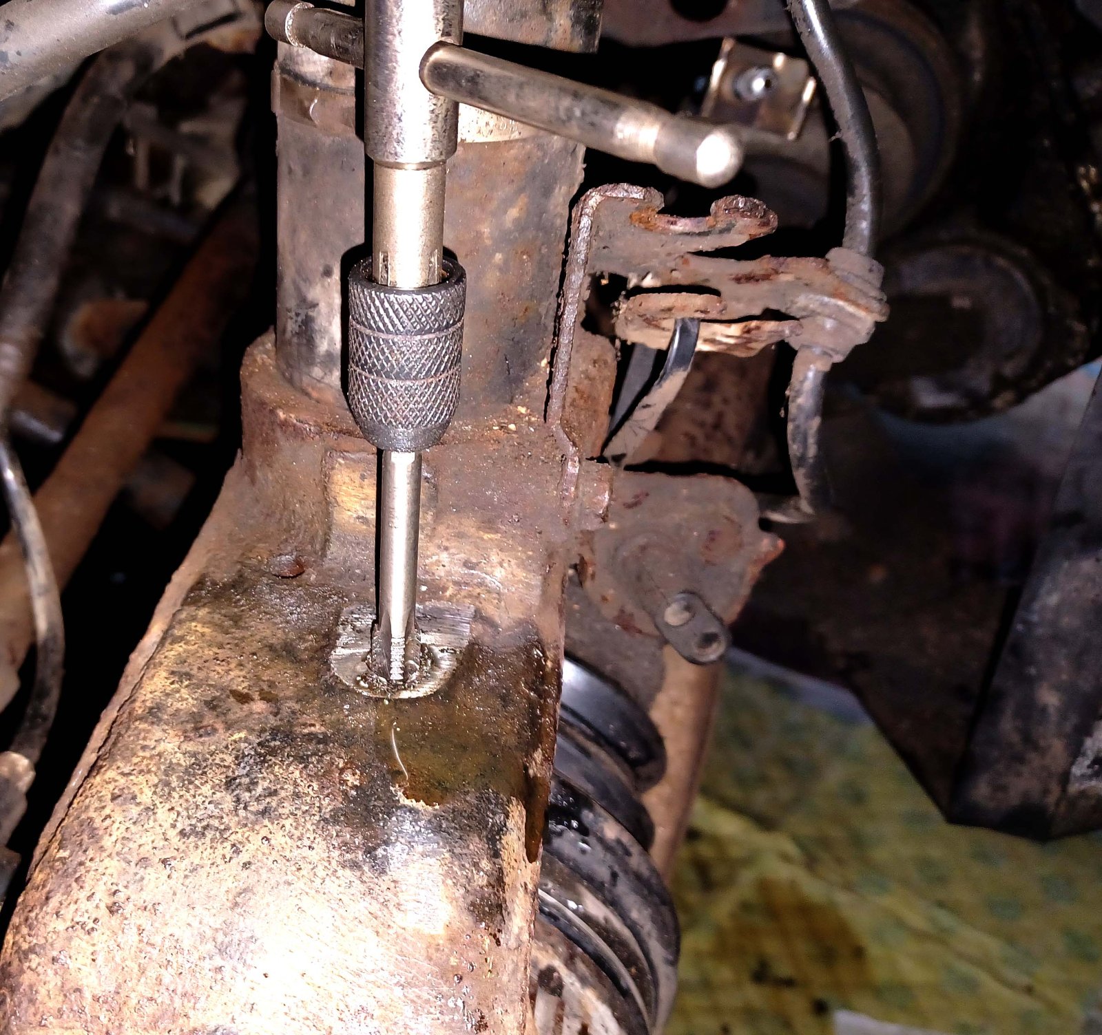

I have a good read through when I get a moment. Just looked at pictures last night. Don’t forget PlusGas is your friend too. So maybe worth soaking things in advance and keep squirting them once a day. 😁
Unless of course you really do enjoy drilling and tapping?
POST EDIT: I see you already know who your friend is...

Brakes all done, both Frn't strut spheres are @ 40bar
