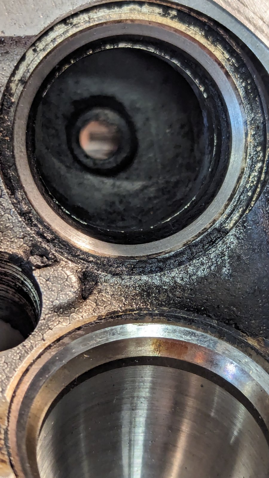

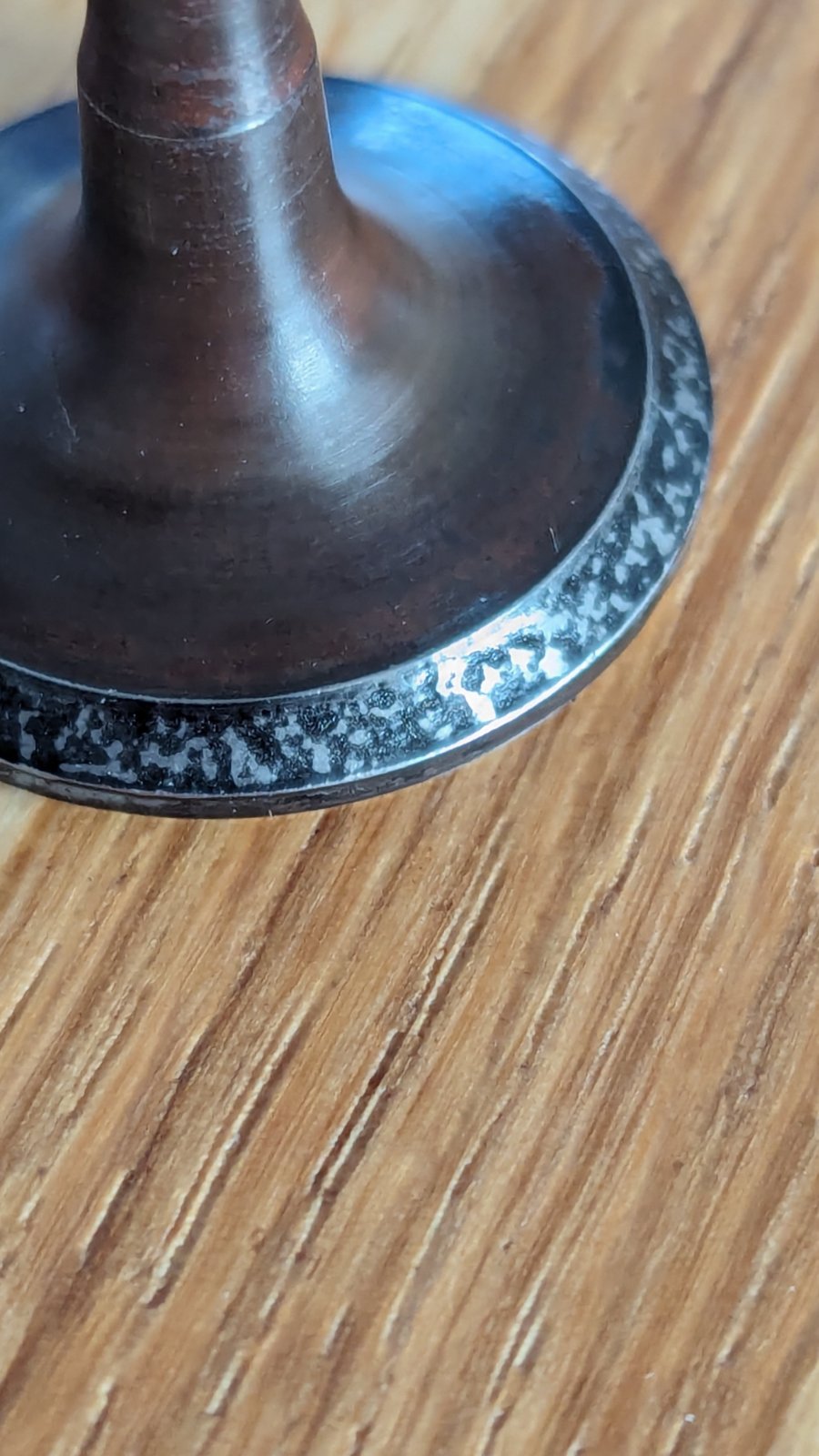

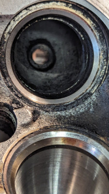

Now I am cleaning the valves and noticed the exhaust valves I cleaned looked like this.
I have given it a lap with paste but I do not want to do that too much.
The intake valves look fine and in the top it also looks fine.
Should I change the valve if they look like this or another round with paste?

No. Don't attempt to lap them any further.
That's very strange. The valve seat is very good but the valve face is toast!
Find out the cost of new valves, then contact your local machine shop and find out the cost of re-facing the valves. It might be cheaper to re-face the valves...depends on how deep that pitting is. You can only grind the face until the margin is so thick, or you'll burn the valve! So the machine shop might not even attempt it.

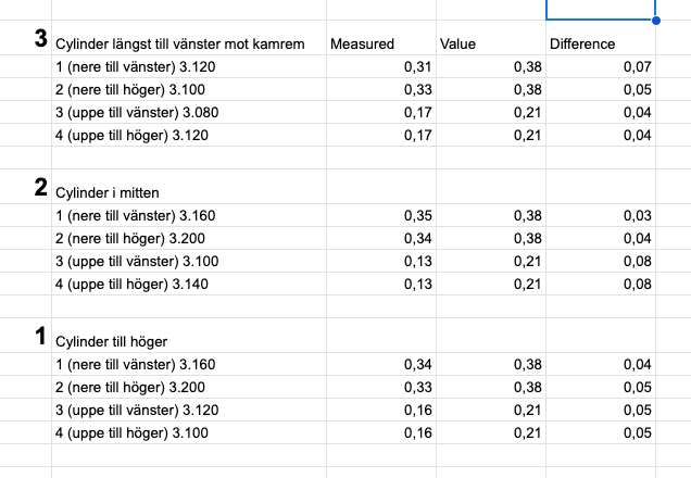

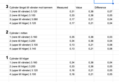

I have measured the valve guides by putting a screwdriver in. One with a diameter of 5,06 mm did not fit. I could just get it in. The valve measured 4,97 mm and with that one in I can move it a little bit sideways. I do not think I need to change the guides so I go for new valves. I have already changed the Intake Valve that I damaged.
Hopefully I do not need to change the Valve Pistons.
I did measure the gap to the Valve Pistons before i took it apart.
Is the diffrence ok?
