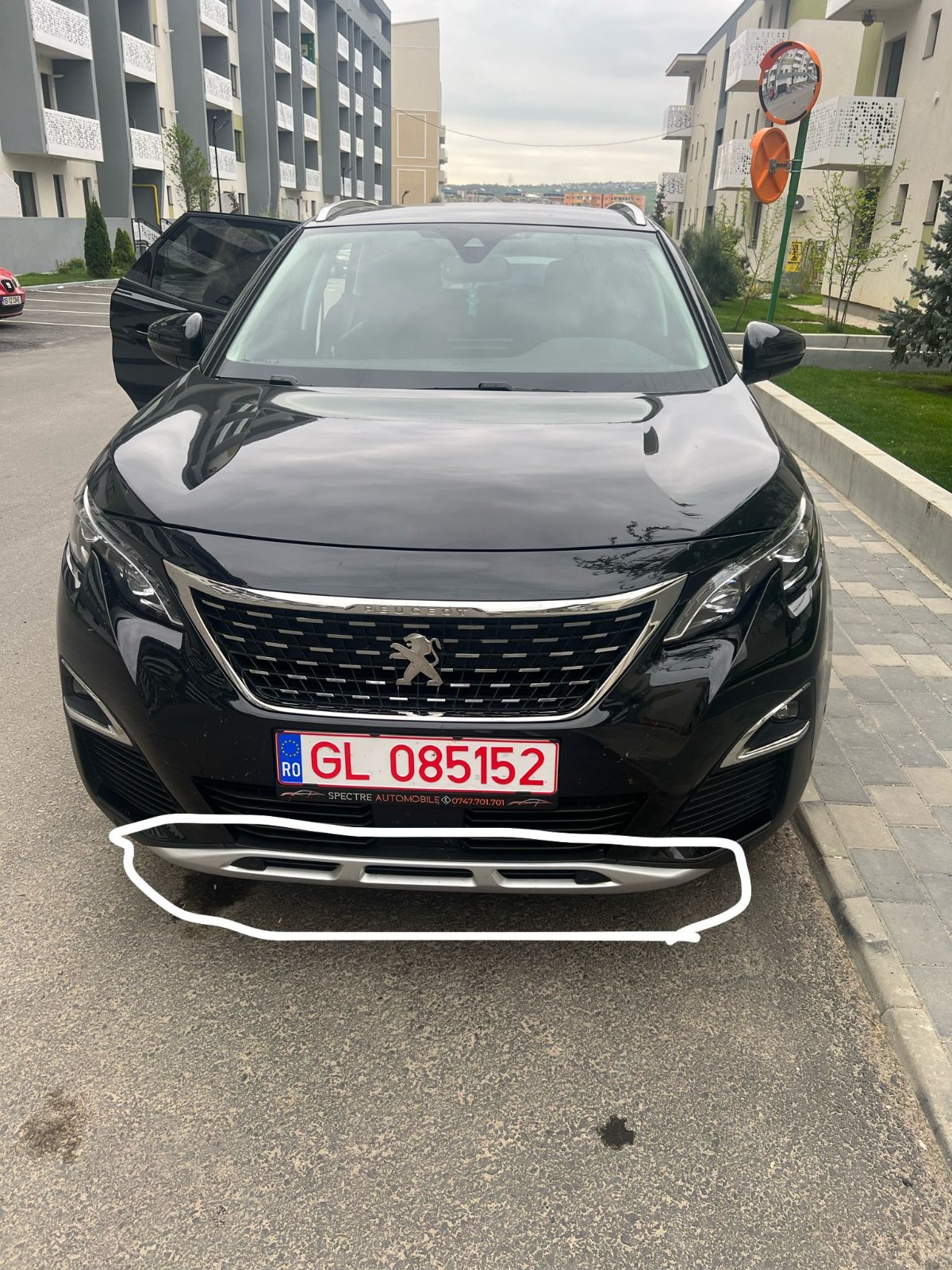

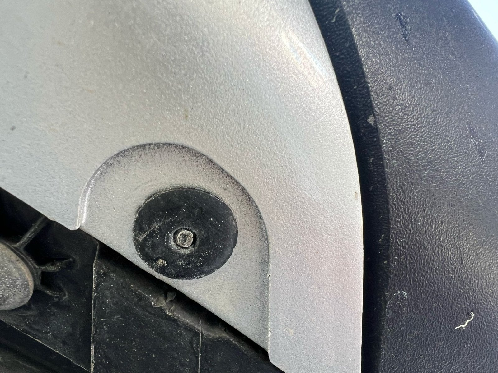

Any tips on how would I go about removing the front bumper lower skirt? It is attached to the front bumper by some clips/ rivets, not really sure so any advice would be much appreciated! Please find attached the uploaded attachment photos for reference. Many thanks!

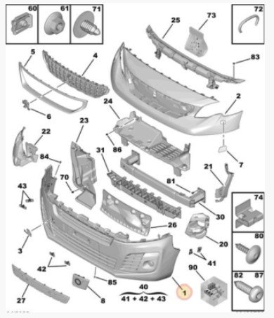

The clip in your picture looks like one of the common body plug/clips used on plastic bumpers. If you pull out the centre it will free the outer plug and let you pull that out and thus split the parts. If the centre is not separate then prise out the plug with a body trim forked plastic tool. Hope that helps, have a look at this diagram of a bumper on the 206/7 which shows the type of clip you have. Number 80 I believe but it may be one of the others. Good luck :)

The plastic clip/plugs with a plastic pin in the middle, I seem to think the pin is pushed in further so the plug can then be removed.
