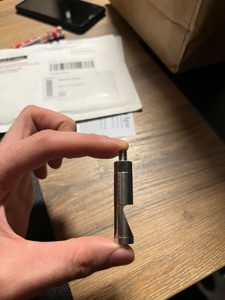

LDA valve:
There is also tuning available for this, done for Land Rovers. I managed to get one.
LDA tune
LDA tune
