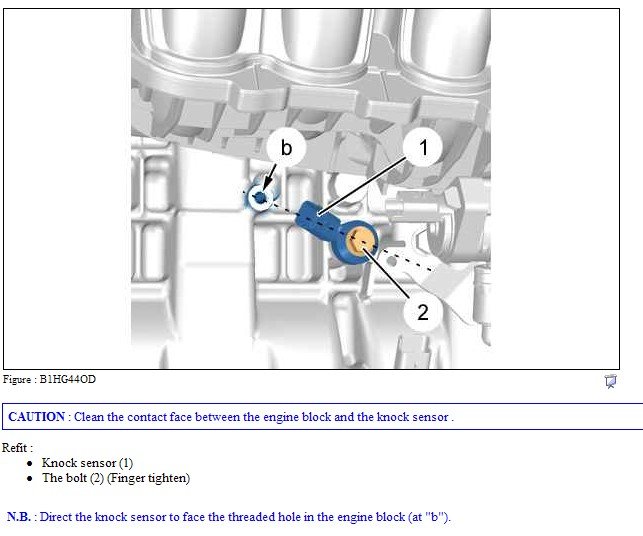

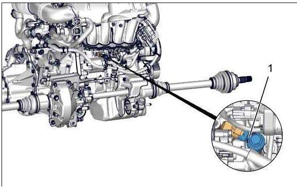

Re: Knock Sensor Removal/replacement.
Assuming its the BMW engine the knock sensor should be around here.
Important points are to make sure the surface it mates to on the block is clean & flat, its orientated as shown & it must be torqued correctly (20Nm)
