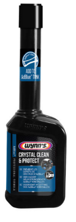

But seeing as they have replaced the lot you should be good to go! I suggest in future you don't wait for the AdBlue level to fall too low. Top up with a minimum 5 litres every 4-5 months (I don't know what your mileage is), and I also suggest using some anti-AdBlue crystallisation additive available from Wynn's or Forte that will help prevent crystallisation of the system. I tend to use it to treat my AdBlue container and from there is then already mixed in for when you top the tank up without having to worry about the correct dosing.
