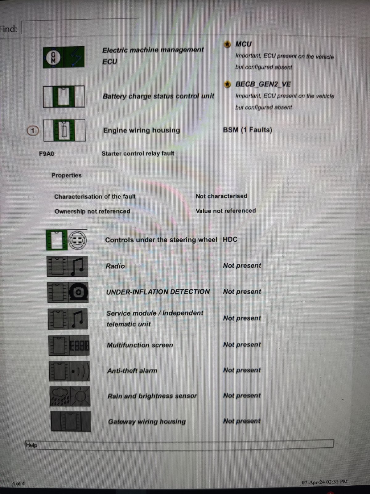

Ever since I purchased my Peugeot Partner Electric, I have had some intermittent problems with the Chademo fast charger. Sometimes it works, sometimes it doesnt and Sometimes, after it starts charging, it can randomly disconnect.
When I took it to the local Peugeot garage, they said that they couldnt see any fault codes :rolleyes:

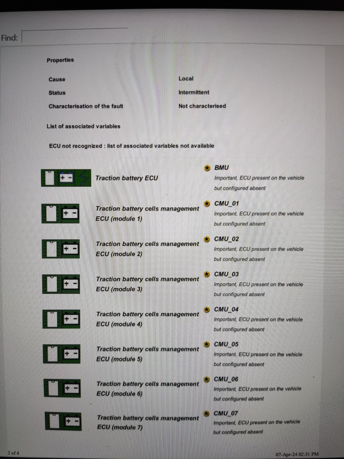

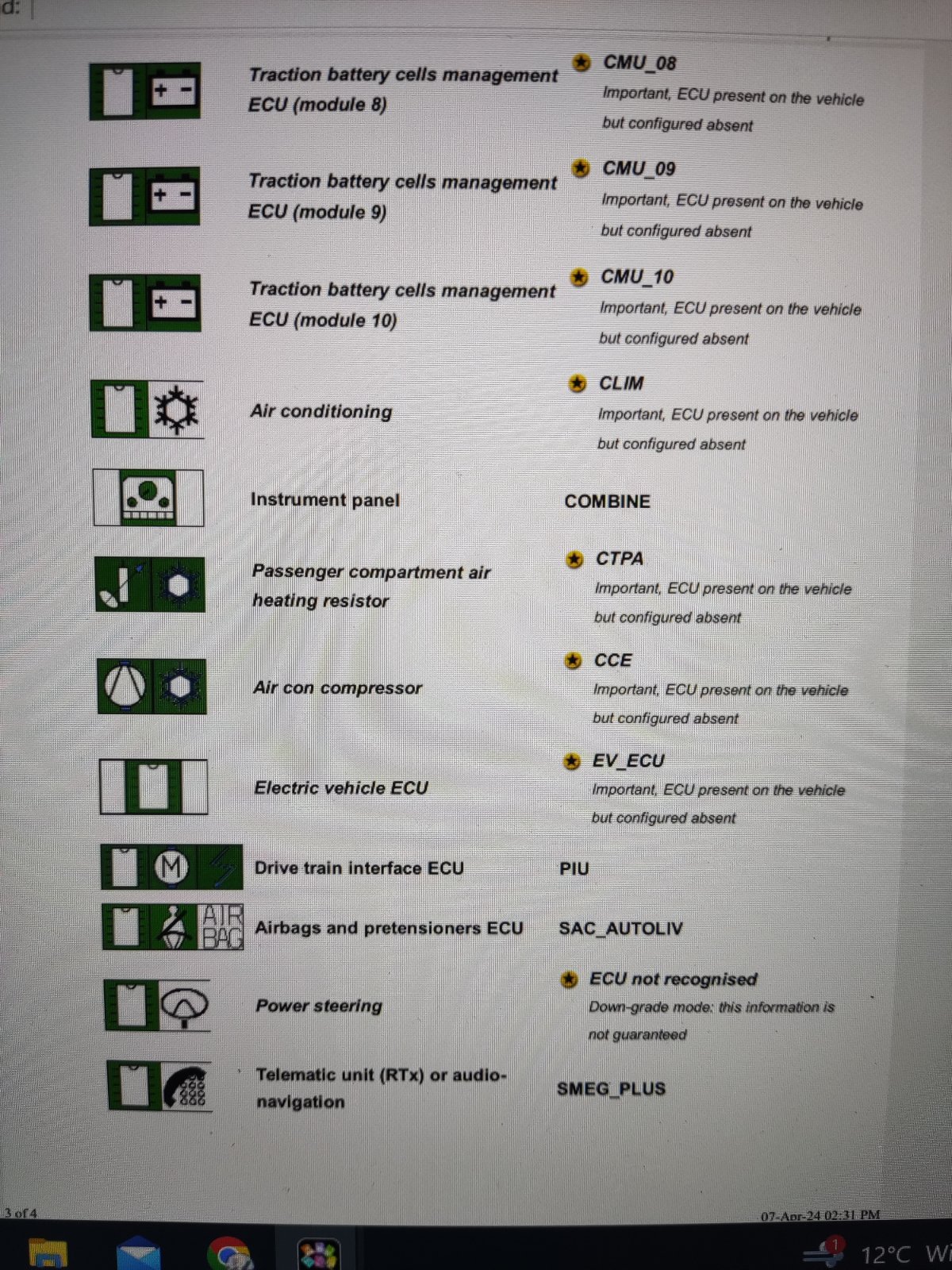

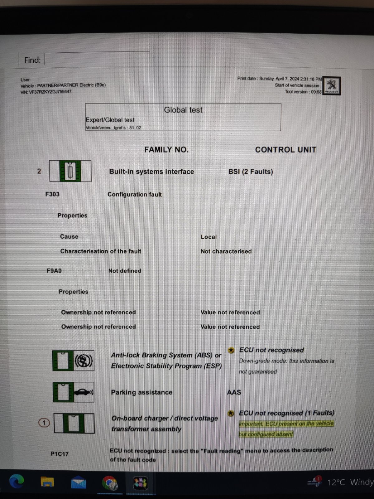

I Purchased a cloned Lexia device and used diagbox 9.68 to scan for error codes. I got a couple, but im not really sure what they mean or if they would affect the Chademo charger. They were F303, F9A0 and P1C17.
I have attatched the diagnostic report. Does anyone know if the codes could account for the charging problems Im experiencing?

There looks like there's some issues with lack of communication with some systems - is you VCI a full chip version? There are cheaper versions of clones that don't have al the hardware on the boards and won't read some ECUs, so that may be a possibility. But in either case, I doubt there's much I can help with, this being an electric motor. They really need specialist attention.
