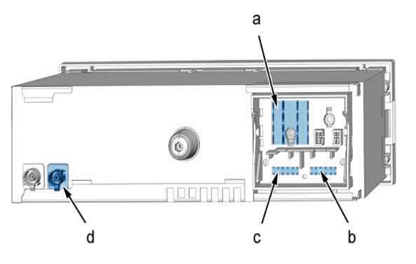

Re: RD4 to RD45 upgrade. Antenna issues
The White connection on the RD45 is for AM and FM1 combined.
RD4
"d" Aerial AM/FM1
"d" Aerial AM/FM1
