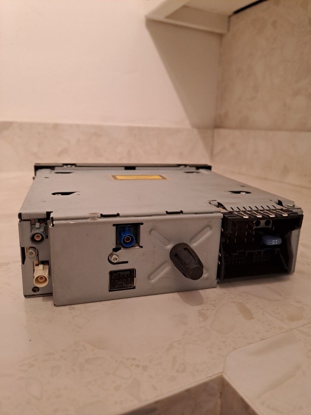

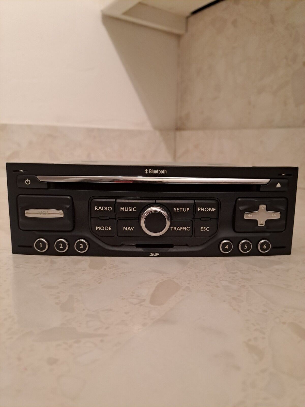

Hi, I have a 2015 Ds3 1.6 BlueHDi DSport with satnav, reversing camera, etc. A while ago my radio/multimedia screen stopped working and the radio started making a noise (like it's trying to eject a cd or something every 10 seconds) I can't turn on the radio, can't hear any sound or see anything on the screen. I was looking for used radios of the same model but the vast majority of the ones I see have different connections (fewer). Does anyone know if one of the simpler units would work in my car? (even if it would probably need to be coded).
The exact reference for the current unit is 98083777XT-00
The ones that keep appearing are 96661984XT (the front is the same but it has a SD card reader)

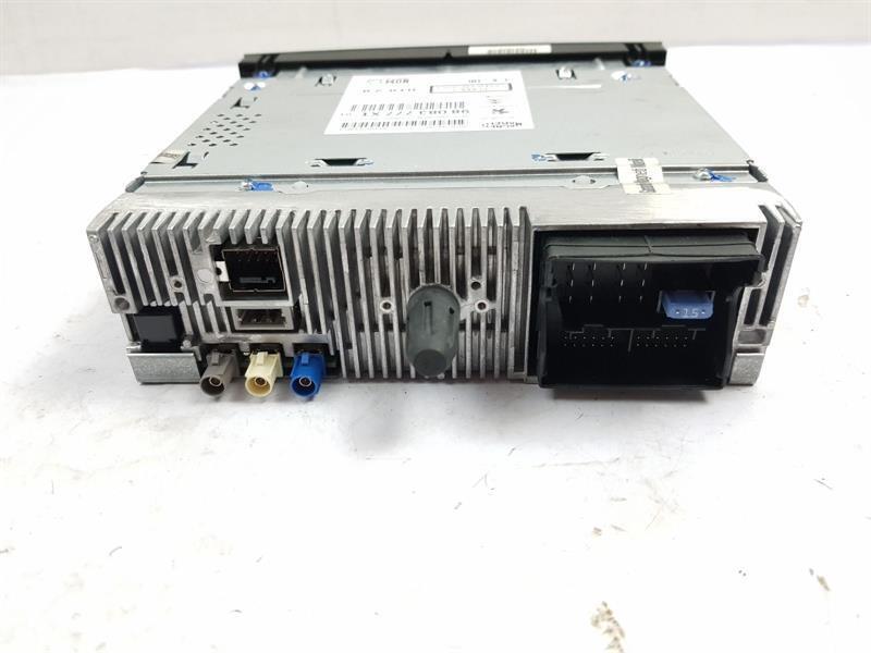

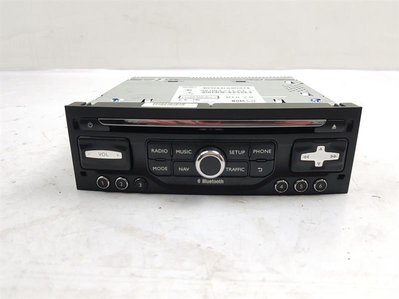

No, these are totally different units. The ones without the SD card Slot at the front is an eMyWay or RT6 Unit by Magneti Marelli. The ones with an SD card slot are the MyWay RNEG units by Harman Becker.
They are similar in appearance but the RT6 is the later unit. You can't just swap them, as the RT6 outputs High Resolution and the MyWay uses lower resolution screens.
Also you need to match your original Head unit with the same part number at the rear, because there are different hardware versions of the RT6, meaning that not all RT6 units support reversing camera features!
