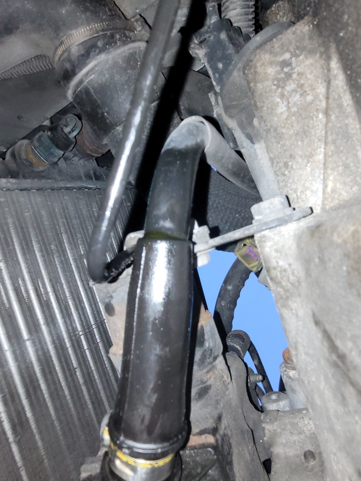

It is a rubber pipe, here is a video that will show you which pipe it is:
Here is a closer picture of the leak:
Thank you for your time!

That hose is the main return from the pressure regulator, which is part of the "octopus" which combines many return hoses. See #3 on the diagram.
The octopus is available from Dr Xantia https://www.drxantia.com/index.php/en/p ... oom-detail
Note that there are several versions of the octopus with slight differences depending on the specification of the care, but I think that the one available there is the exact part for your car (LHD, non-hydractive, anti-sink).
Be warned that it is a very tricky job to fir the part due to poor access to some fittings and clips.
