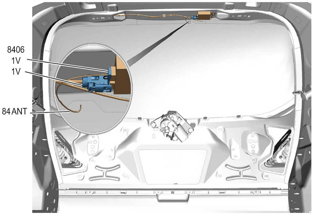

(2) The Unit on the tailgate connector is for the FM2 that I mentioned in my post and this is then routed from the adaptor unit and imprinted on the rear windscreen.

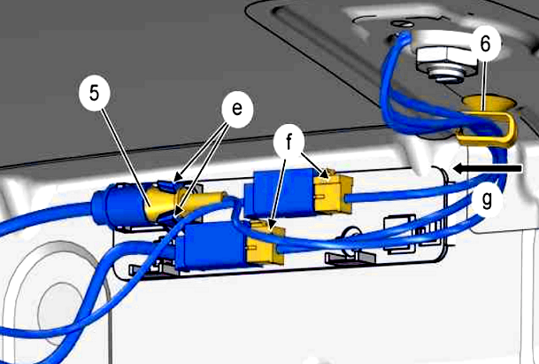

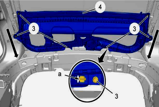

The other connections to the roof aerial (1) are awkward to get to because as you have the panoramic roof, the aerial connections have been moved behind the the rear blind sub-assembly, which is itself behind the rear crossmember. So the headlining, rear crossmember assembly and blind cassette need removing to get to it.
So the blind cassette would need to come off to get to the aerial assembly in the first picture.
(1) The aerial on the roof is for the AM, FM(1), GPS & GSM.

Thanks. That first picture really helped. What I thought was another amplifier was just a bit of plastic holding the wire connectors in place.
I took the roof lining down from the boot side and it gave me decent access.

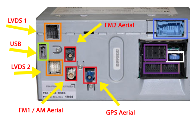

I was doing some continuity tests on my multimeter and the connectors going to the back of the radio to the three aerial connectors.
There's blue, which I believe is sat nav, that seemed fine.
White seemed fine too.
I could not get any continuity on the grey connector.
I did swap the white and grey ones over at the back of the radio to see if I could get any signal (I was hoping I would get "current listening" and could ignore the other "searching for a better signal" one for now) but still got nothing.
Since there doesn't seem to be an option on this radio for accessing FM2 directly, I assume this is the one that is "searching for a better signal" and both roof aerial and this combined give a better radio signal?
In which case even if 1 fails I should have *some* signal, surely?
Assuming the FM2 cable is the grey one going from the radio all the way to the FM2 amplifier. Nothing here either.
Is the cable uninterrupted all the way, or is there a join anywhere I can unplug and test?
Also what type of cable is it? Is it fakra? In case I need to buy a length of it

I wouldn't recommend swapping them about as some are pre-powered internally.
FM 2 Aerial:
FM 2 Aerial:
