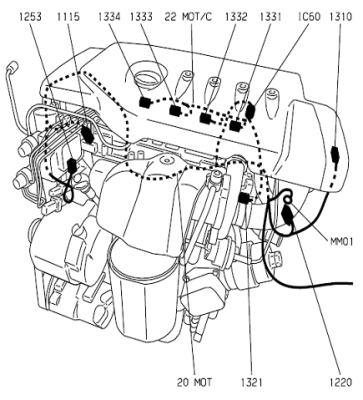

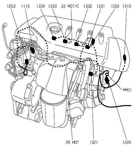

The following describes the situation where the assistance is reduced and how it works. Given the speed anomaly info you reported, it makes sense that the power steering is going into back-up mode. So you need to check the battery condition to make sure it is higher than 9V and then check the engine speed sensor.
This vehicle does not have ABS, nor ESP, so you won't have any wheel speed sensors. Therefore it will most likely use the engine speed sensor for this info, so I would be looking at this also.
1310 is the engine speed sensor shown below:

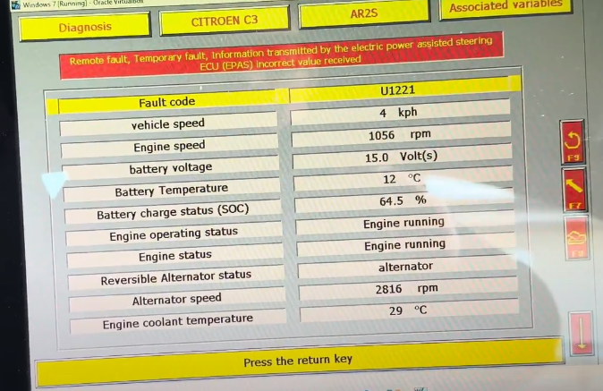

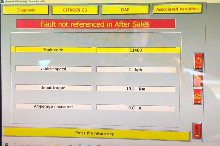

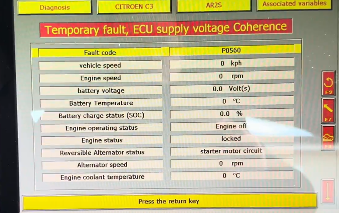

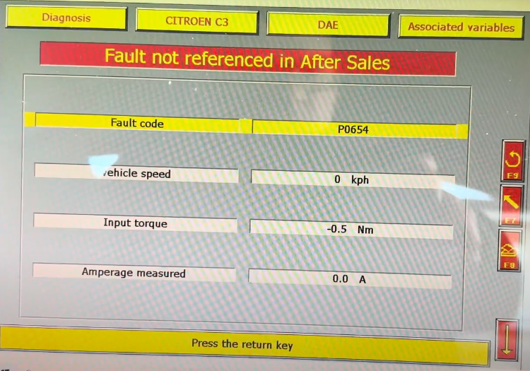

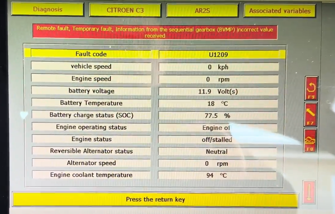

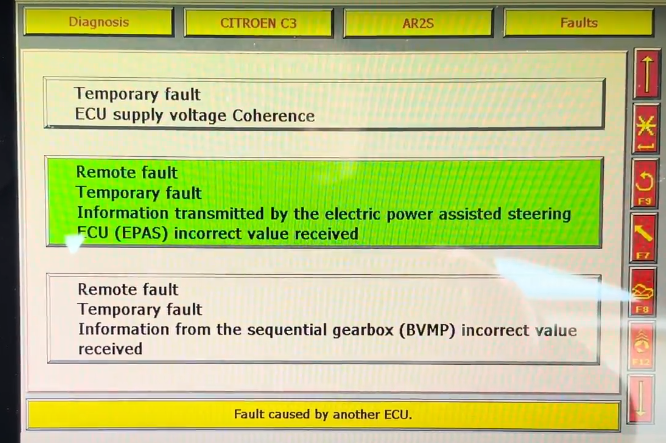

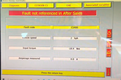

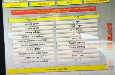

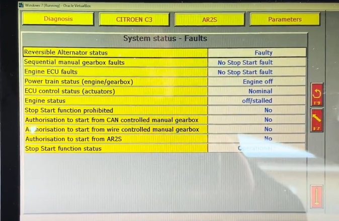

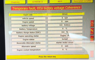

I see the post very “fresh” and willing some help too. My wife have C3 2004 1.4 16v SensoDrive with Start/Stop function. And it’s also disappearing and appears electric power steering. I'm wonder the vehicle already 20 years old and the most of mechanics and garages scratching their head pocking with finger to replace expensive parts. Once I’ve replaced electric power steering motor. Now started do again. I have an Autel and Lexia3 scanner tools. Autel cannot read even the VIN number but Lexia does. I have print screens with error codes which gonna post here bellow post. The car starts drive and fully shift gears with paddles and gear shift also even in manual mode. We are trying to save car ‘cos we both like so much how cheap and fun run. We bought travel to work and after. I suspect it gonna be transmission range sensor and probably need replace clutch actuator. But error codes stored in gearbox ecu, electric power steering ecu and ecu reversible stop-start alternator. Will upload pictures from Lexia. My iPhone doesn't let upload pictures. And I'm sorry for english.
C1400 - Fault not referenced in After Sales
P0654 - Fault not referenced in After Sales
P1702 - Temporary fault ECU power latch
U1221
U1209
Regards, Modestas
