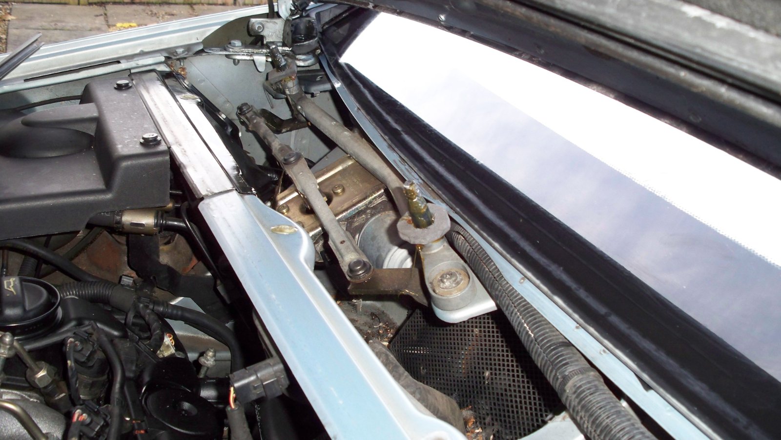

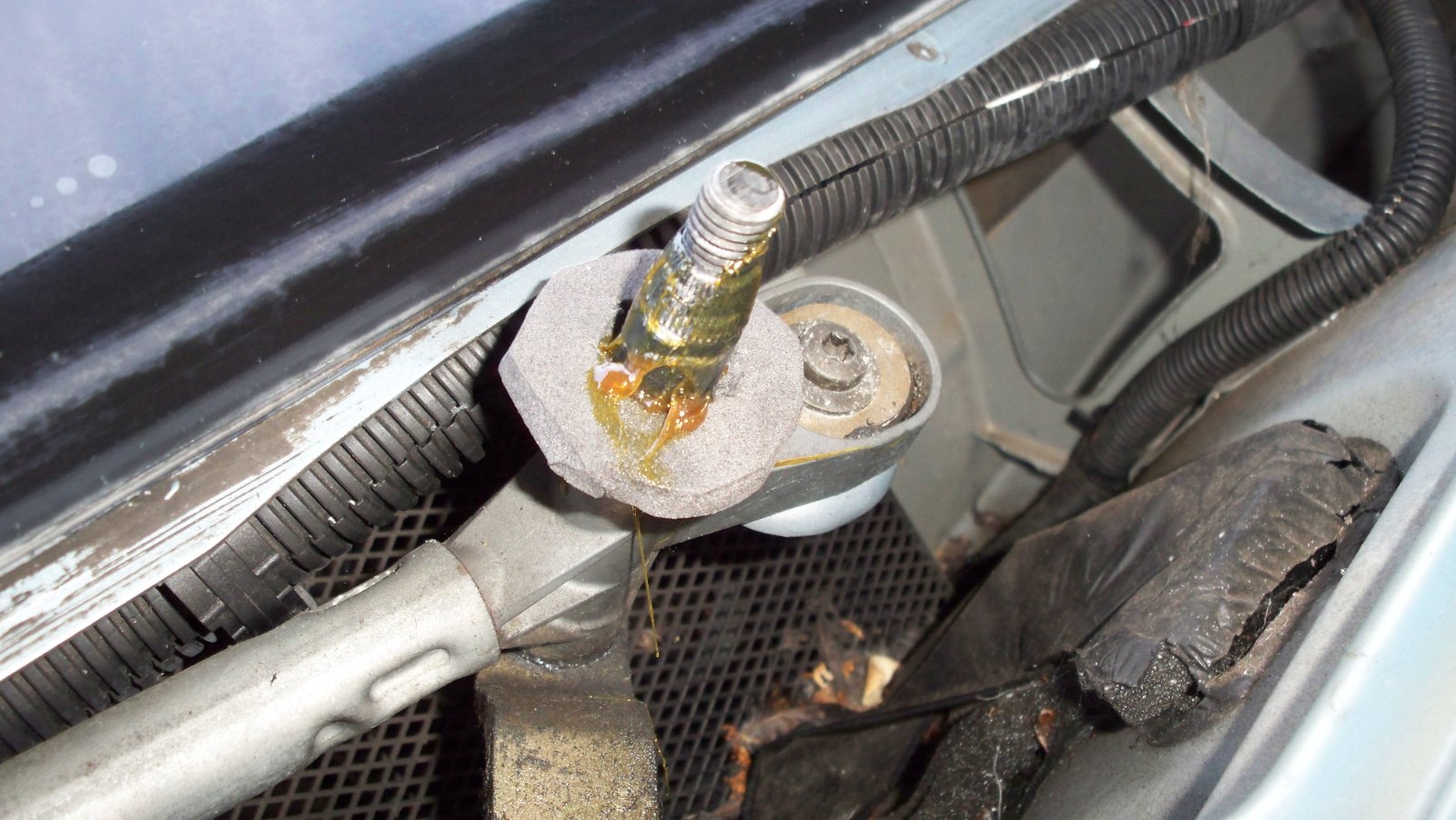

I have removed the scuttle a couple of times on my 2001 C5 and recall no difficulty with the rubber grommet...it levers off. The aspect which puzzled me was why only one shaft had the grommet. You will see from the attached photo that I simply fashioned replacement seals from foam rubber to minimise water ingress.

Thank you for your thoughts. I'll be more aggressive with the washer. I like your enhancement, too.
I suspect that only the centre wiper had a grommet because water going past the other wiper would drip into the water outlet into the wheel arch, whereas water from the more central wiper would drip into the air intake - and hence into the car. Looking at the grease in your pictures makes me wonder whether that was Citroen's solution to water ingress - use lots of grease, and hope that by the time the grease has gone (and water can get in) the car is out of warranty.

Re: C5 scuttle panel removal - stuck again!
I believe you are correct re the single grommet. Other threads talk about water from that intake causing problems in the drivers (RHD) footwell. The grease was mine. Its main purpose is to lubricate the foam rubber seal, but also the shaft taper to ease removal of wiper arms. I suppose I should have used red rubber grease.
