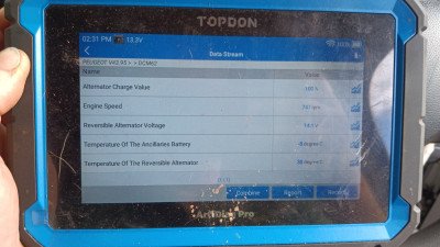

Then fails more with issues indicating alternator.
Test... Only 10.6 amp.
So. I changed alternator. Reset fault codes. Charged battery.

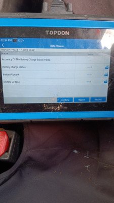

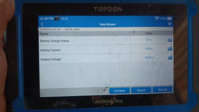

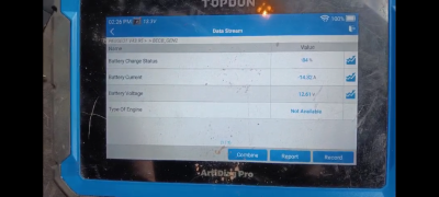

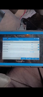

Tested. And there seems like MINUS battery current? (Checked thru my TopDon)

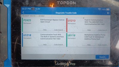

Pictures attached show my Peugeot expert 2017. And also a Dispatch 2020. Dispatch indicates a positive battery current 🤔

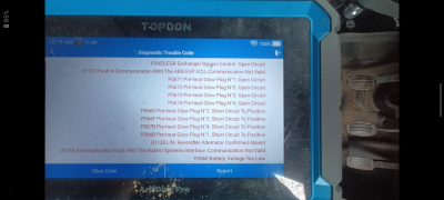

Also. Image showing list all the fault codes etc was BEFORE reset. And image of 4 fault codes is after reset.

If the starter just clicks with a fully charged battery then that could suggest the starter is faulty, possibly its carbon brushes are worn out.
