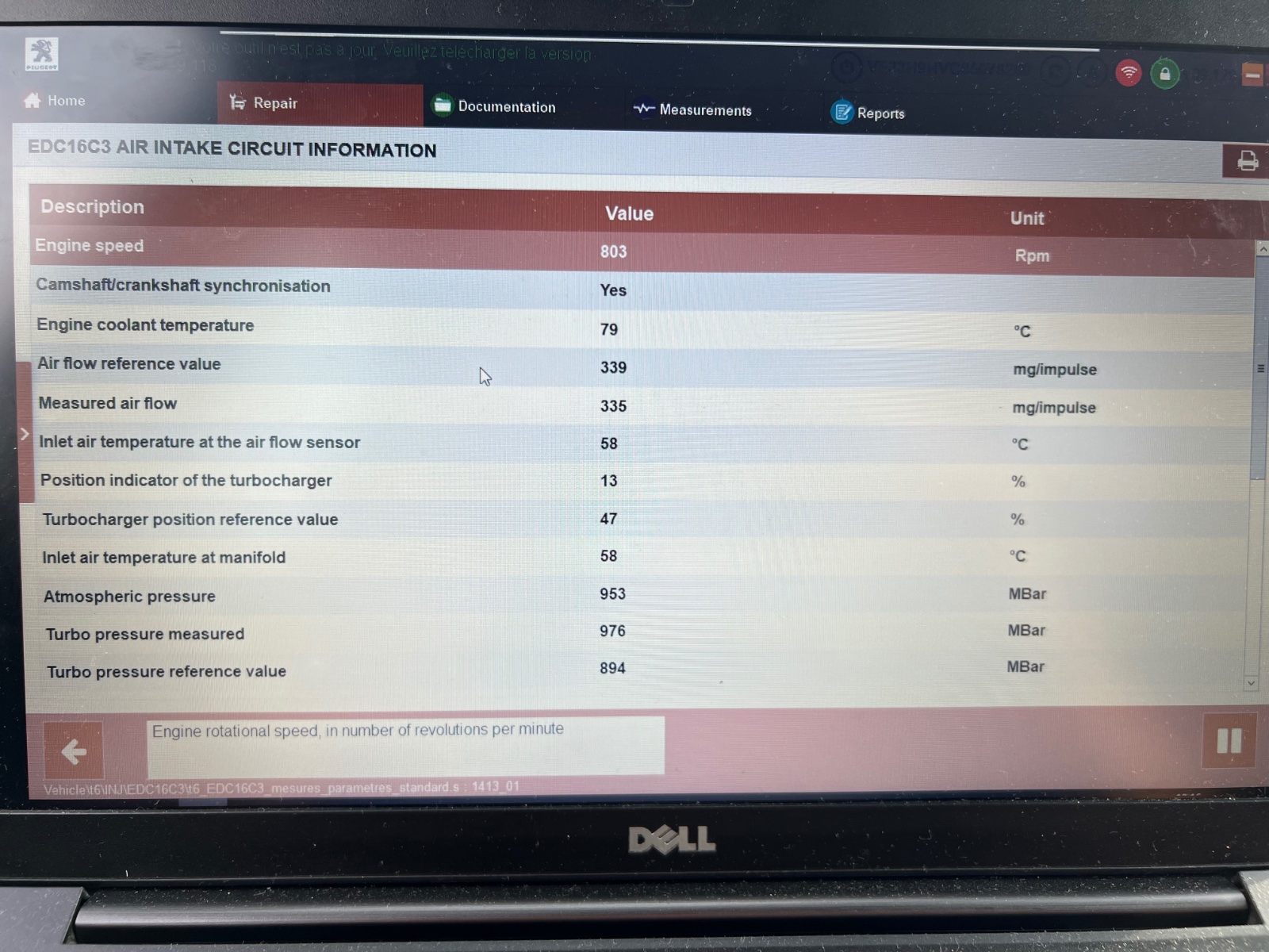

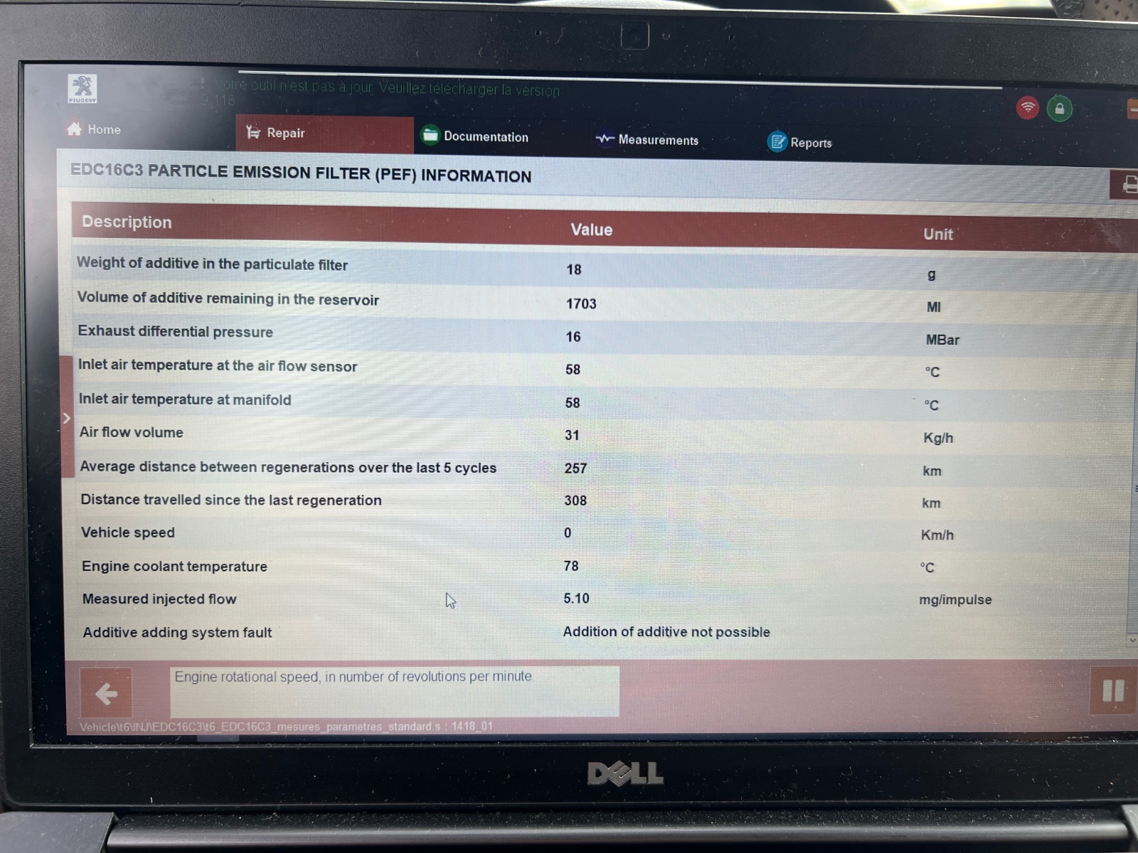

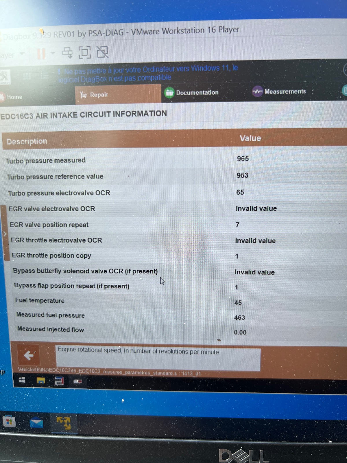

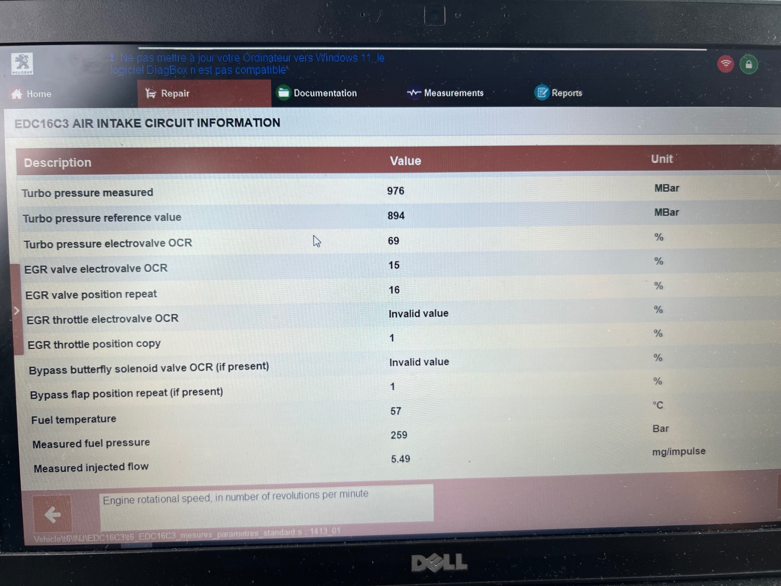

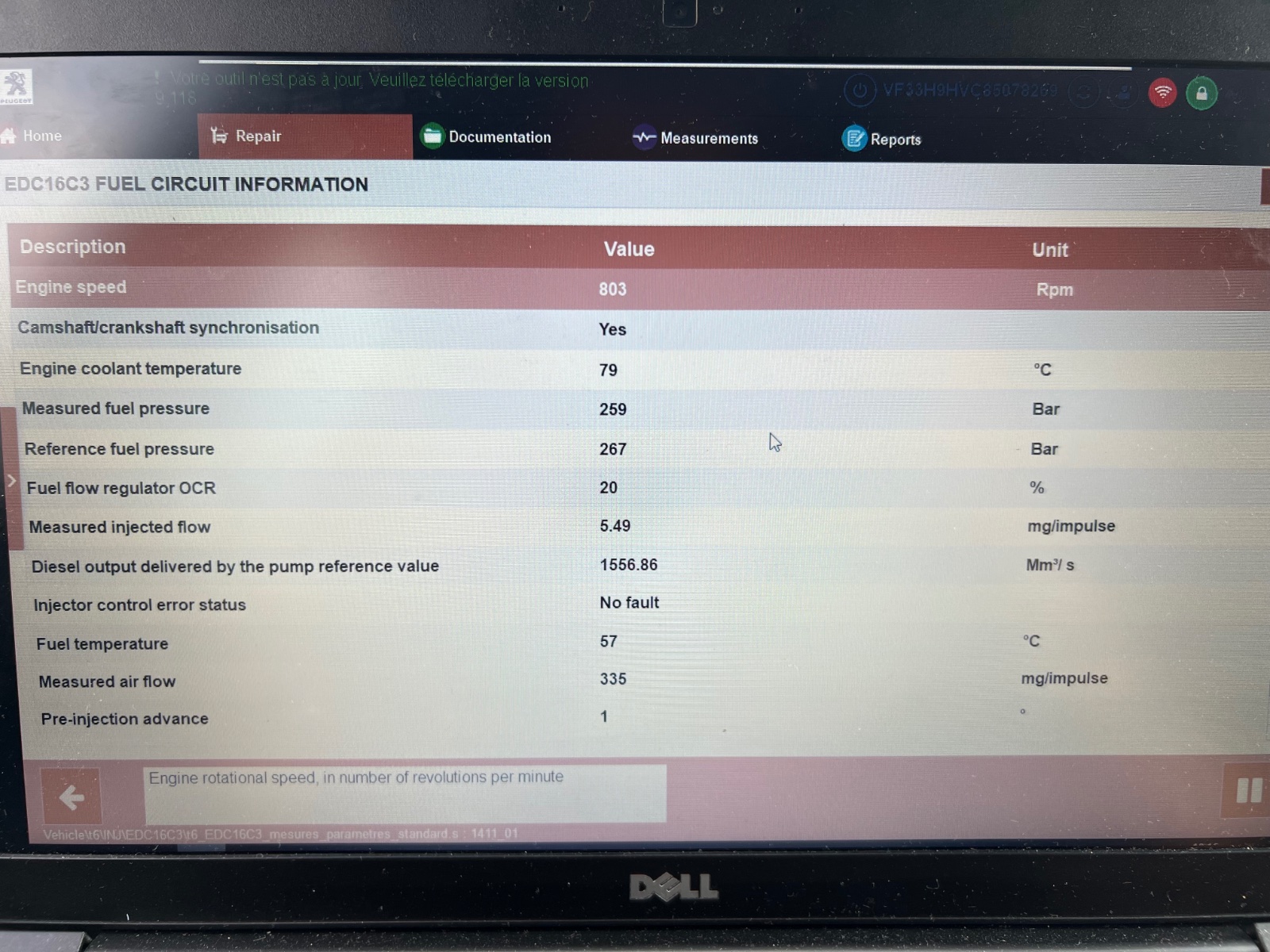

Purchased a 1.6hdi some time ago and have been trying to pinpoint the cause of a p0402 which will not allow the regeneration of the dpf. Changed some parts on it like the turbo oil feel pipe, had the turbo checked and it seems to be spinning freely. Changed the vacuum solenoid thats at the back of the bulk head, and the MAF sensor with a brand new pierburg and the error keeps showing up. I’ve ran some live data screenshots and was hoping direction on the cause based on the screenshots. I’ve been told to remove the dpf which i dont want to do, or to change the turbo.

P0402 seems to be excessive EGR flow. What is the EGR valve position doing vs the reference value? What is the air flow vs the reference value?

Re: Peugeot 307 1.6hdi p0402 [Solved]
Unread post by vnechev »
The issue has been resolved. It was the turbo probably jammed in the minimum position. It was producing boost, however it was about 200 mbars lower than what the ecu was expecting triggering this fault. Fitted a rebuild oem turbo and the car changed completely. Thank you guys for all your help. During the process I also removed, cleaned and fitted new injector seals along with a new intake manifold as the old one had broken clips for the air filter box.
