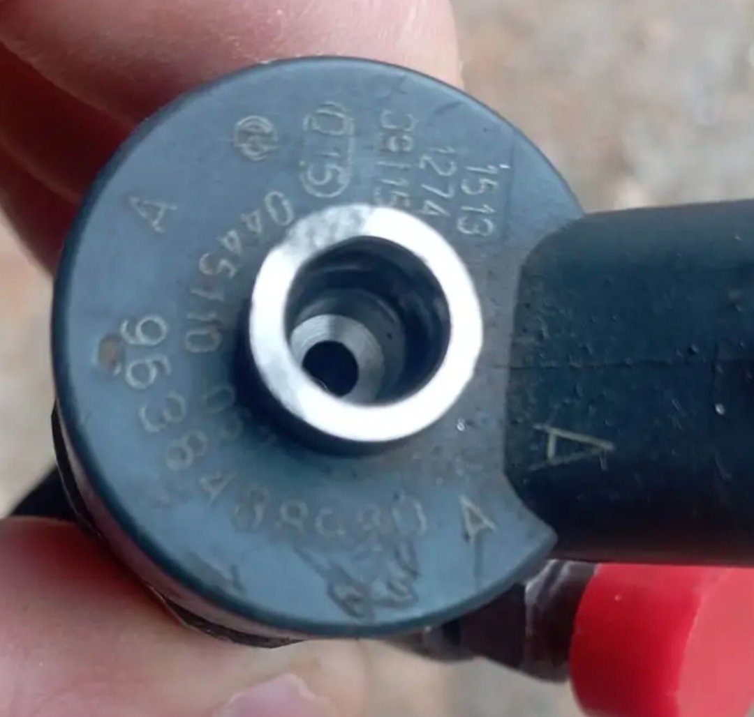

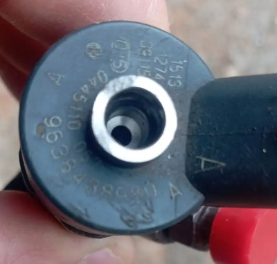

There's a chance I can pick up 4 that are from a scrapped 2.2 but the part number (9638488980 - image below) gives matches for the 2.0 as well.

To clarify, the image is of a possible source of injectors not whatever's fitted to mine.

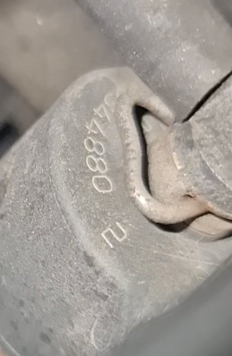

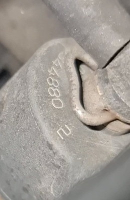

Have now edited in a pic that's about as good as I can get without taking the scuttle and wipers off etc. I'm assuming class 2 by that number at the end of whatever the long number is. (The potential donors pictured below have 'A' so presumably this means class 1?)

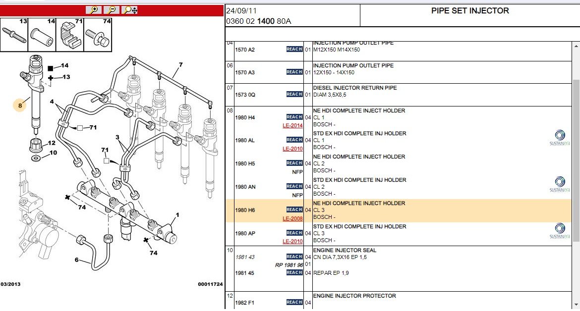

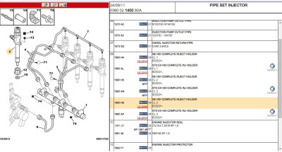

It doesn't specify what class is fitted, listing them all:
The linked doc for class 1 / 3 says to configure Class 2 if more than 2 class 2 are fitted.
The listed part numbers only appears to cross reference to other 2.2s, e.g. in the C5.
The 96 number off the injector is not listed as a PSA part number, probably a Bosch part number.

EX is exchange. I found some other info on line that suggests that Bosch don't have different grades if you buy direct! There may be a number on the injectors that tells you what class, but I can't see one in your pic. Possibly the classes are just 'quality' and the incremental smooth running is pretty marginal. You should be able to see what class is fitted in Diagbox.

I've since edited my original post to show what looks like class 2 (Lexia also says 2/B/Y) but the rest of the number is obscured until it's dry enough here to get the wipers off etc.
So class doesn't seem to be much of an issue, from reading it seems removal is the main hurdle.
