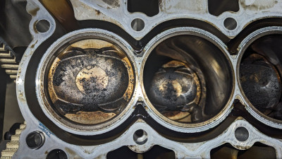

Hi,

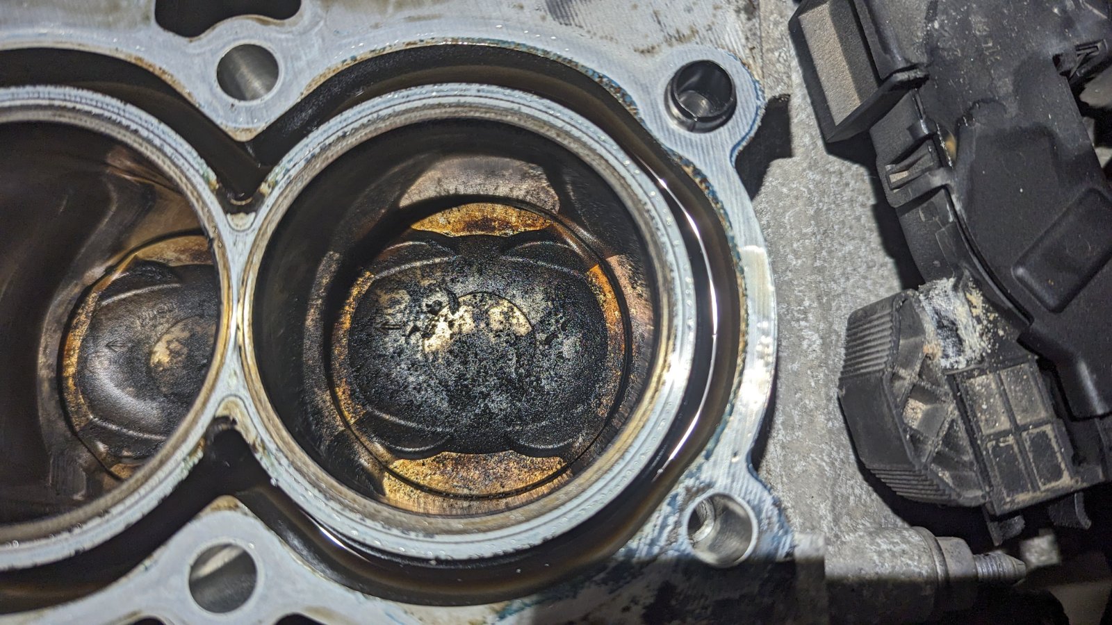

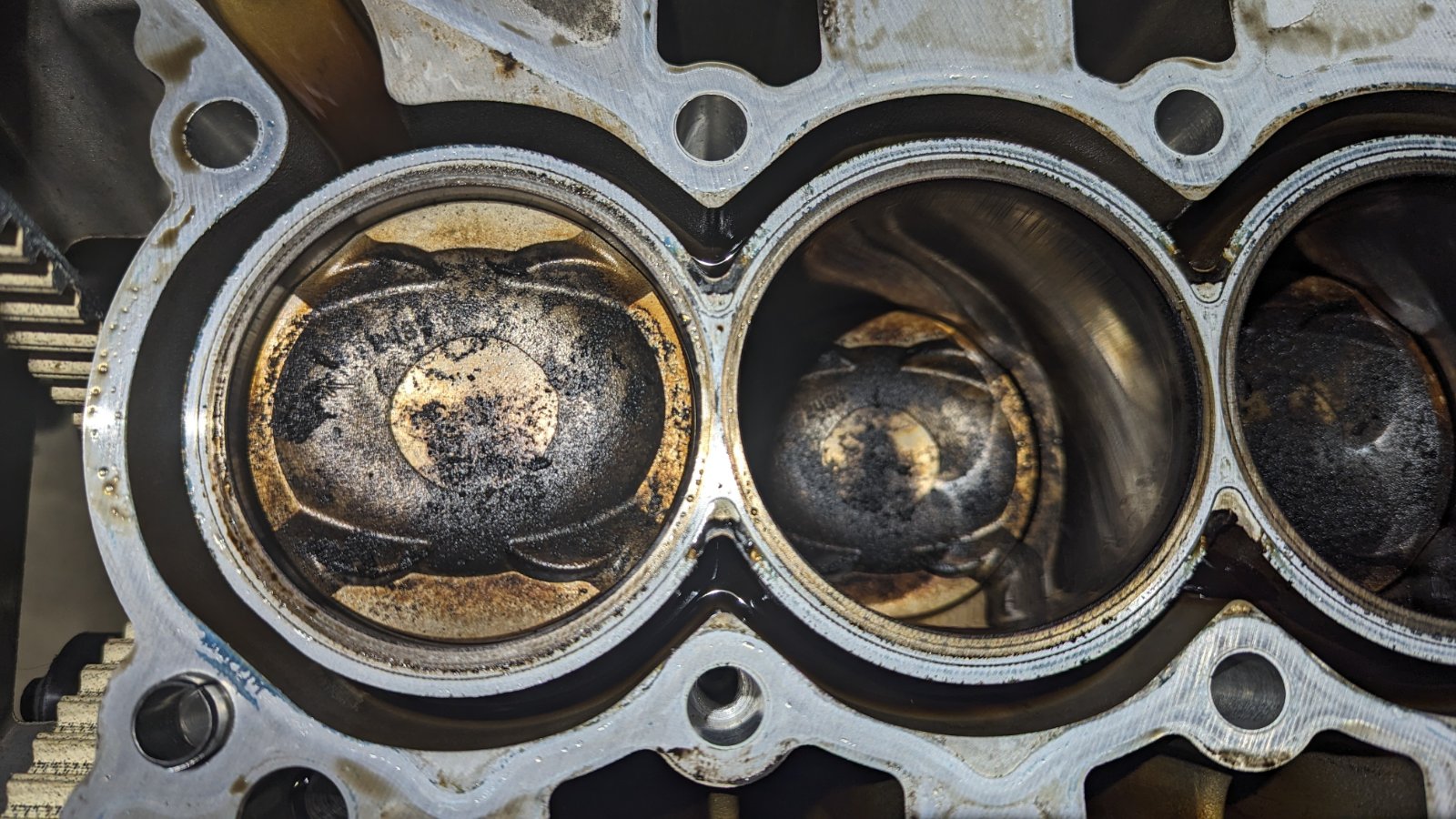

I have the cylinder head of on my 208 (EB2 engine). It started with a new timing belt and then I realised it wasn´t that much more job to change the valve steam seals because the car use about 1 litre oil per 1000 km (thought this maybe would help a bit?).
Then I had to take the top of because I accidently damaged a valve when taking one seal of :(
I have now changed the valve and grinding it, and changed all 12 seals.
I didn´t take the other valves out while changing seals.
Questions and after thoughts
1. Should I have taken all valves out and cleaned and grinde them to?
2 Do I need to do a leak test with the top up side down and pour water on the valves. Then blow air in the exhaust and intakes to see if there are coming bubbles?
3 Clean the surface were the head gasket is with something like scotch brite?
I don´t want to miss out of something before putting the top back so suggestions before I do are welcome :)
Thank´s :)

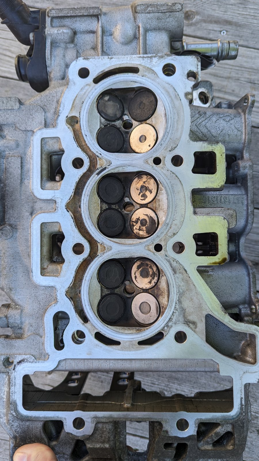

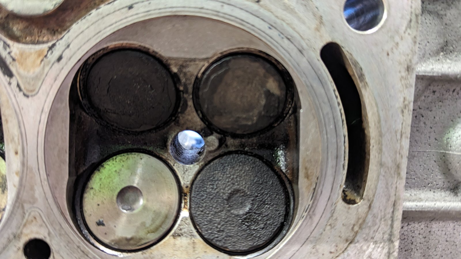

I cleaned some before taking the valves out and noticed that one of the intake valves had a harder burned sot surface on it.
The same as all the exhaust had.
Does this mean something?? (the last picture)
I did measure the valve clearence before taking the camshafts out and it was the same on that valve as the intake valve beside.
