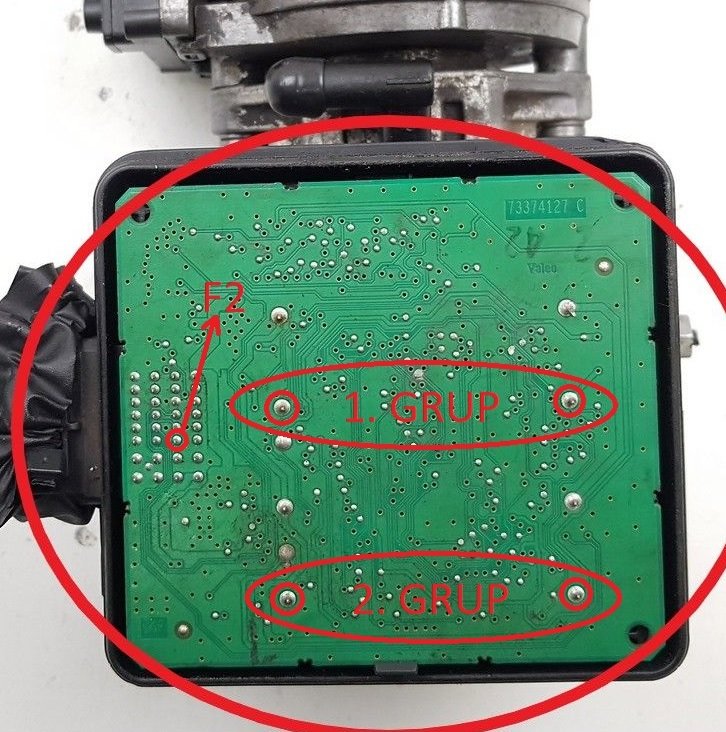

Hi all, i have Citroen C5 Mk1 and i have a problem with my suspension pump. It never stops running until i disconnect the small connector on the pump motor. Can anybody help me?
By the way if it is possible, i want to solve the problem without change or modify the suspension ECU. If not i can try to modify it but i couldn't find the which coil is for raise. Can anybody mark the soldering points?

LDS fluid level is ok, height sensor is ok, car can leveled itself correctly. And I can raise the car top position and lower to bottom without any problem except motor running continuous already lowering or balanced.
