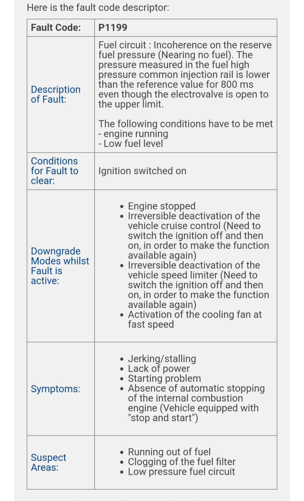

You've eliminated the fact that it could be the injector by swapping them over. P1199 is likely related.
It could be that the fuel pressure getting to no.2 is off because of whatever is causing P1199. So there's enough fuel pressure for 3 cylinders not 4.
If you have diagbox you should be able to see readings you are getting in the
'standard parameter measurement'
' Info Fuel Circuit'
It may help you isolate the problem.
But I suspect low fuel pressure P1199 is causing P0266.
I would start by changing the fuel filter.
I've attached the code symptoms sheet for a C4 picasso, but I imagine it's similar for your boxer.
Hope this helps.
