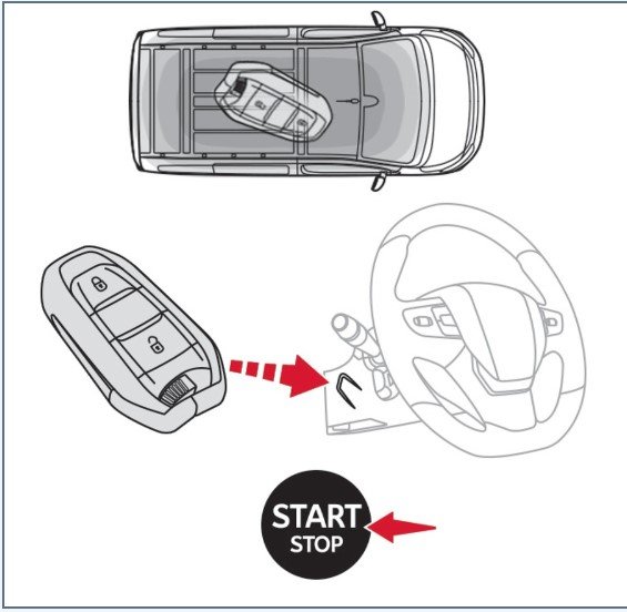

As a side note are you aware that there is an emergency start/programming point on the car that should allow the van to start even if there is no battery in the remotes?
It will be located on the left hand side of the steering column that should at leas allow you to start the van.
x 6947
Re: Citroen Dispatch keyless
There are multiple configurations for these vans regarding unlocking the the cabin, doors and storage compartments, which can be configured, but having read through your issues regarding the Hands free issue, I can't see that any apply to your situation.
It is likely to be down to a faulty Hands Free module given the random behaviour or a faulty receiver aerial in the vehicle. I suggest it needs a full diagnosis with a dealer to determine the exact issue as a generic code reader won't cut the mustard on these systems.

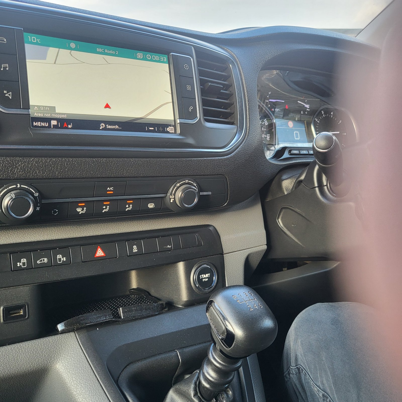

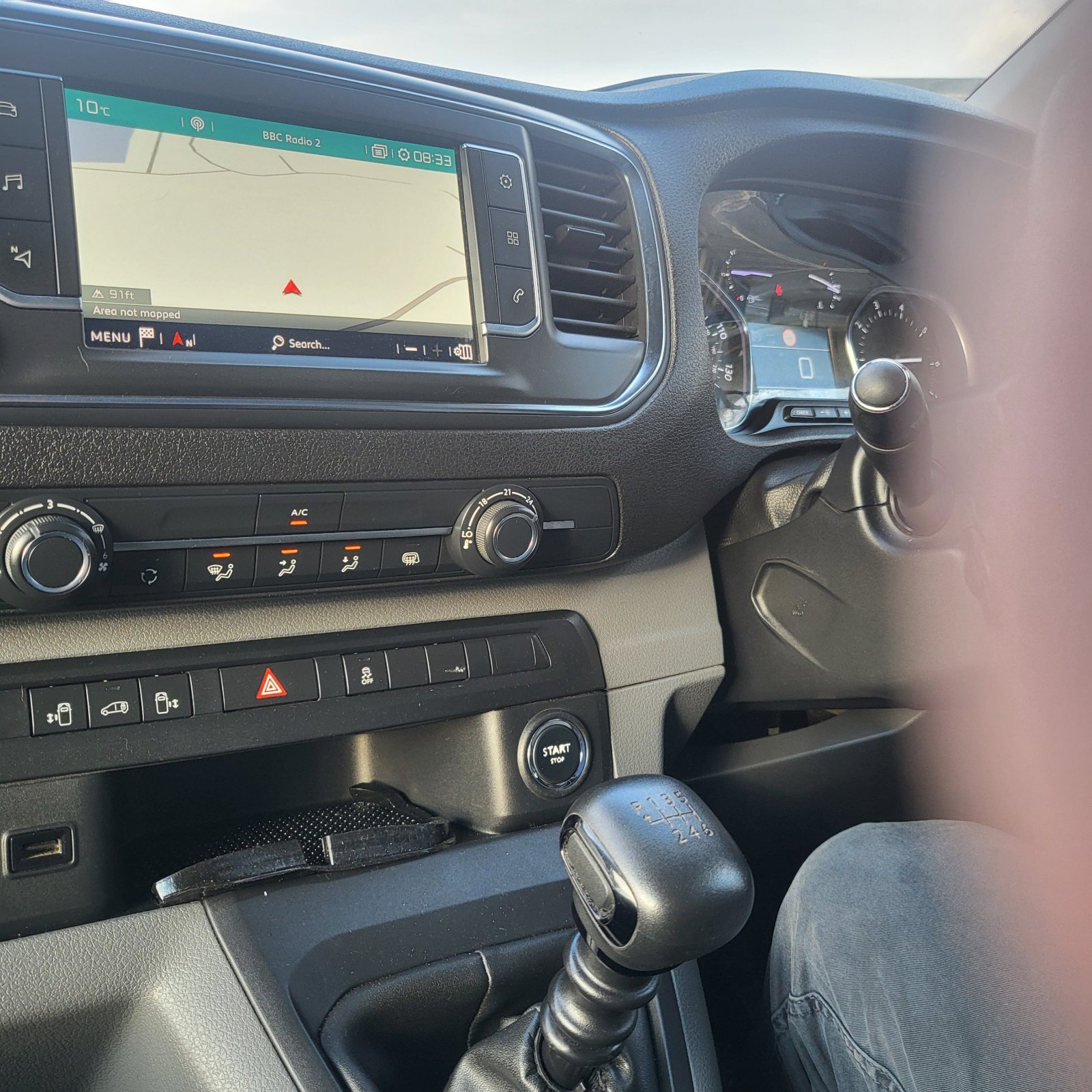

This I assume is where the key goes on the column, its even key shaped.

Yes this is the emergency start/sync point.
Hold the remote against it with the badge side against the plastic.
