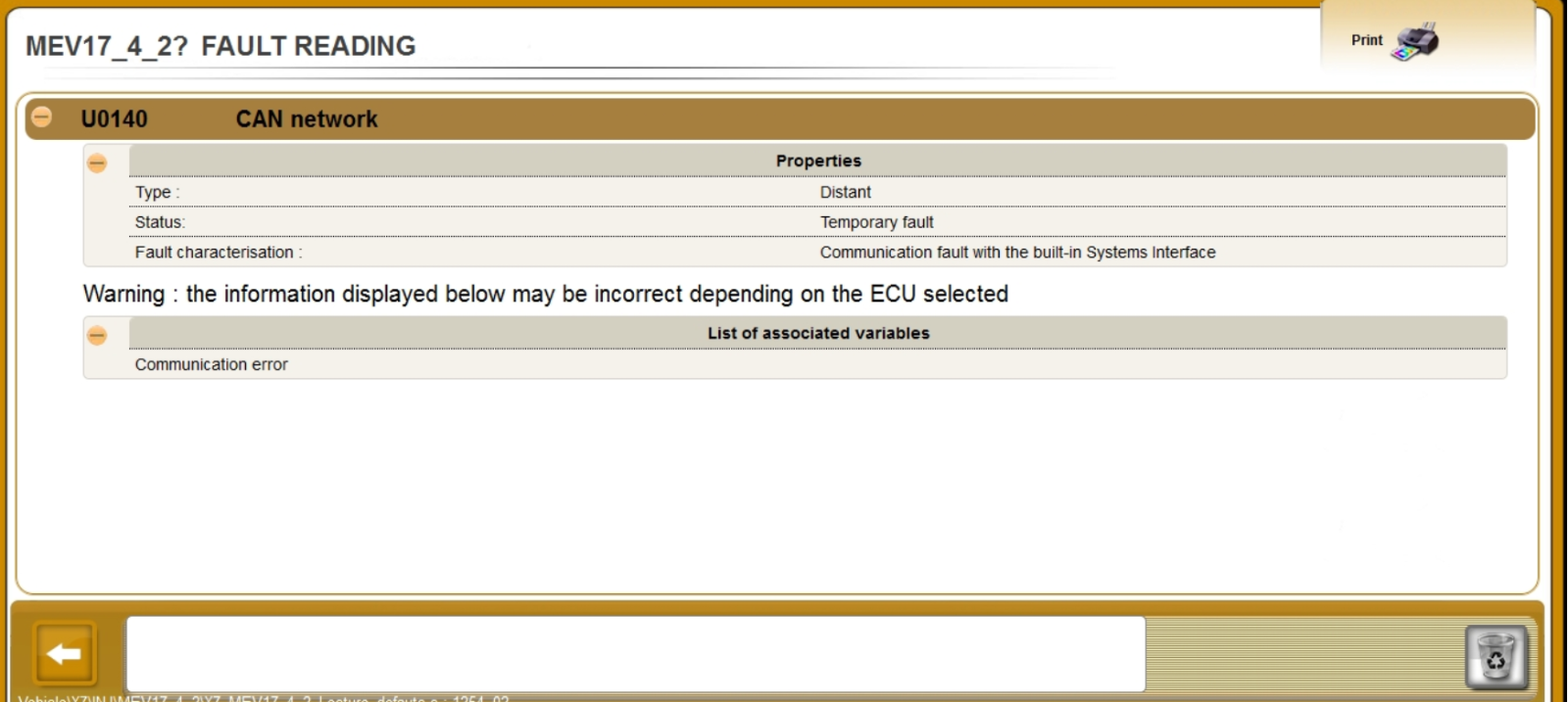

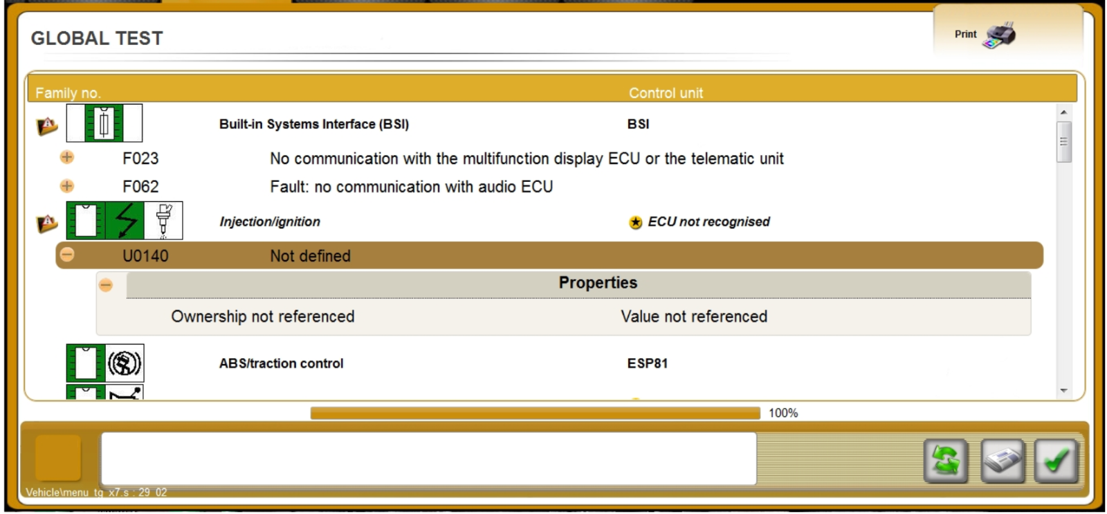

I checked with Diagbox and found three faults: F023, F062 and U140. I know F023 concerns the no comms with the display ECU, the F062 no comms with the audio ECU. This is because I replaced the RT6 radio with a Pioneer SPH-EVO92DAB and steering wheel control unit which is working fine but the U0140 and engine check light now always comes on. I can clear it but the next time I start the engine on it comes.

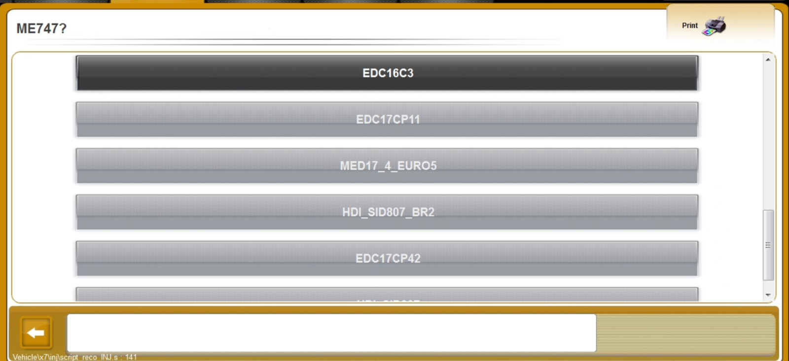

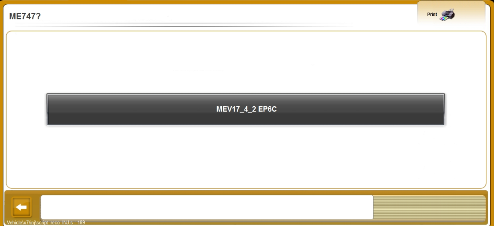

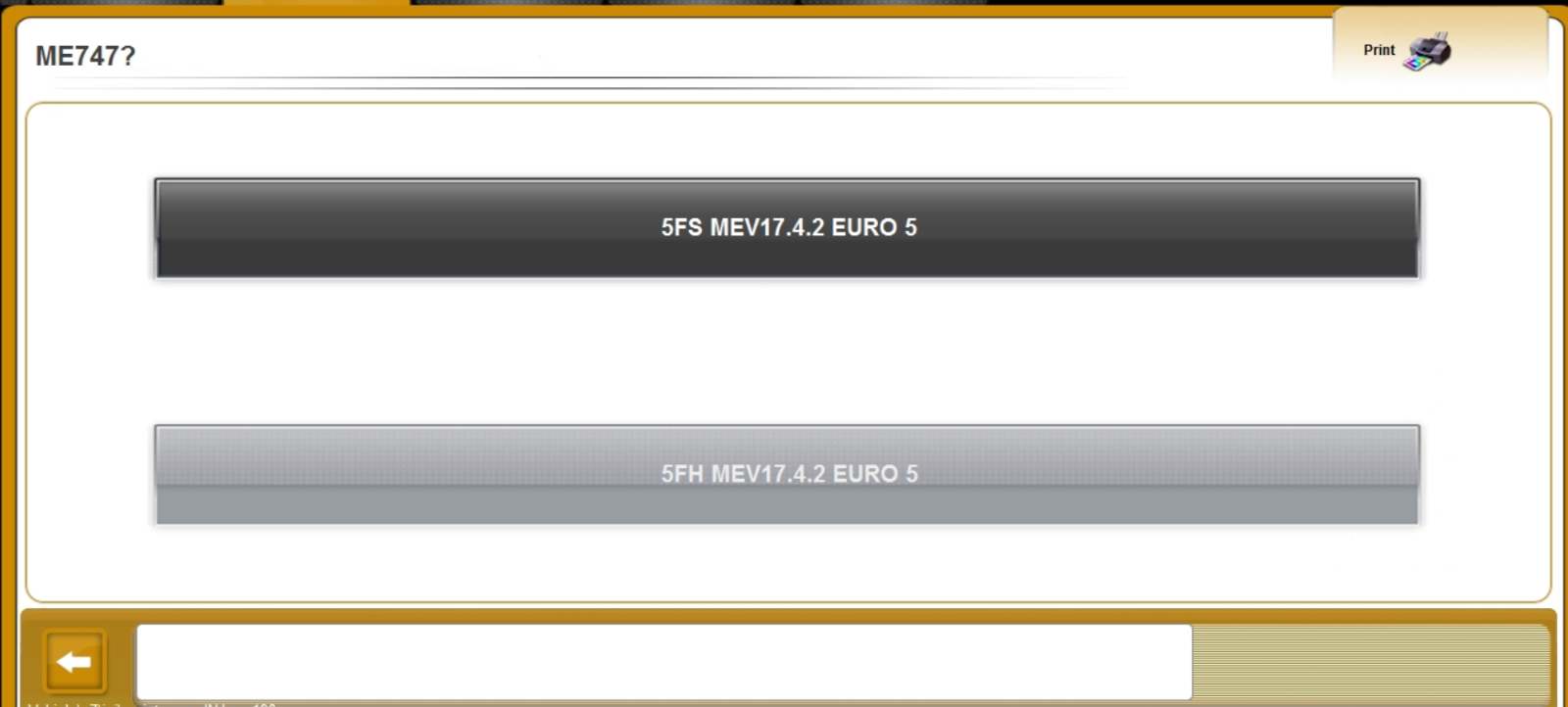

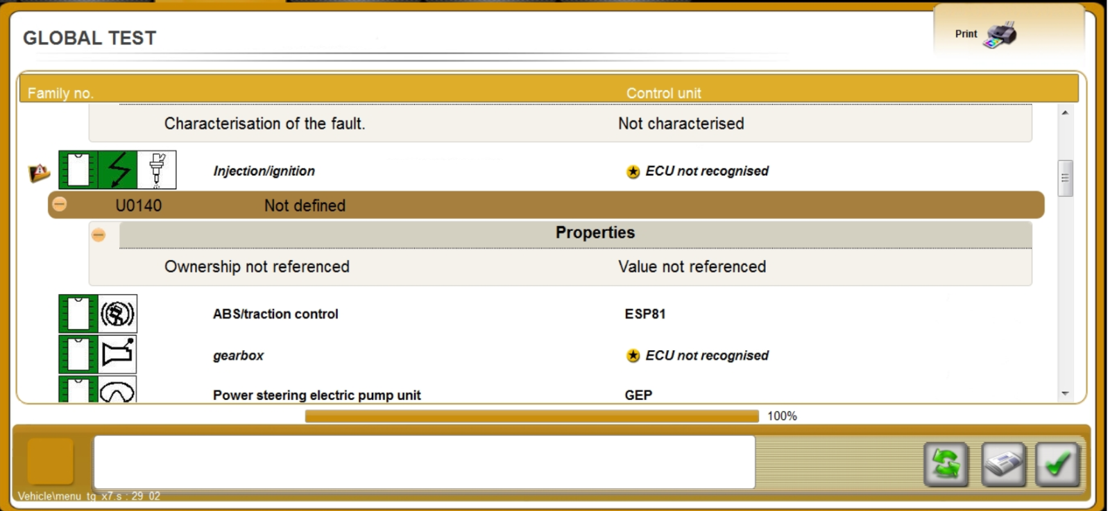

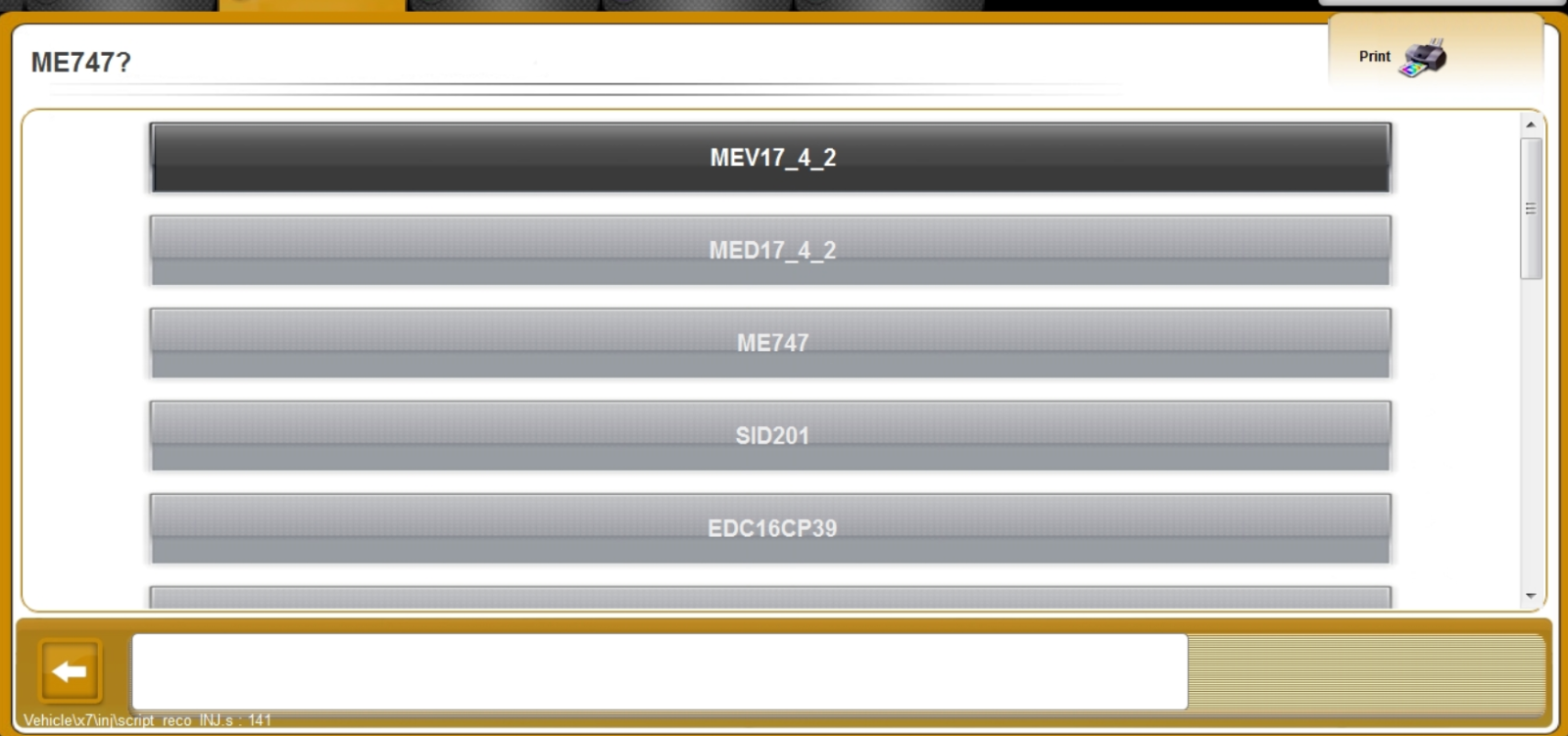

The next screen shots, sorry there are a lot, follow an injector. I have no idea which one I have and I certainly don't want to alter any but at the end (last screen shot) it show a comms error with the BSI.

Be prepared to loose functionality if you put an aftermarket system such as parking assistance visual display, exterior temp and access to vehicle options etc.
I think you have also selected the wrong engine ECU. You shouldn't need to do any of this, as Diagbox should pick up the correct ECUs from the VIN. You have a Siemens injection ECU, not a Bosch...
Obviously you are going to get Head Unit faults, but at present you are not even getting accurate results because Diagbox can't communicate with most of the ECUs as shown in your pictures. You need to connect again and allow it to detect the vehicle properly from the VIN. If it won't do this, then you likely don't have a full chip VCI.
