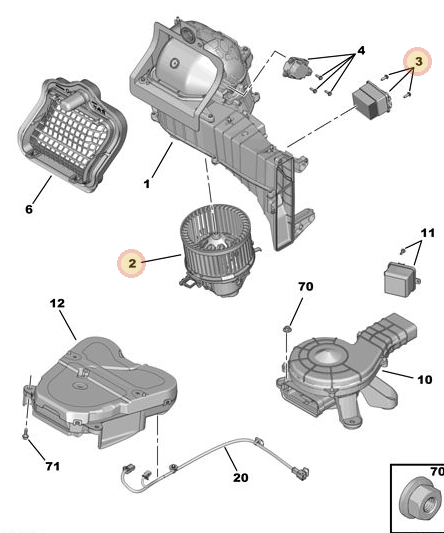

(2) Heater Air Puller, part: 9849784380, £414.25Elgrande Skyblue wrote: 05 Mar 2024, 21:00 Do you also have details of the OEM number of the fan and resistor? I have tried searching on line, but cannot find one to fit a RHD vehicle.
Many Thanks.
(3) Heater Motor Control Module, part: 9821291880, £185.27

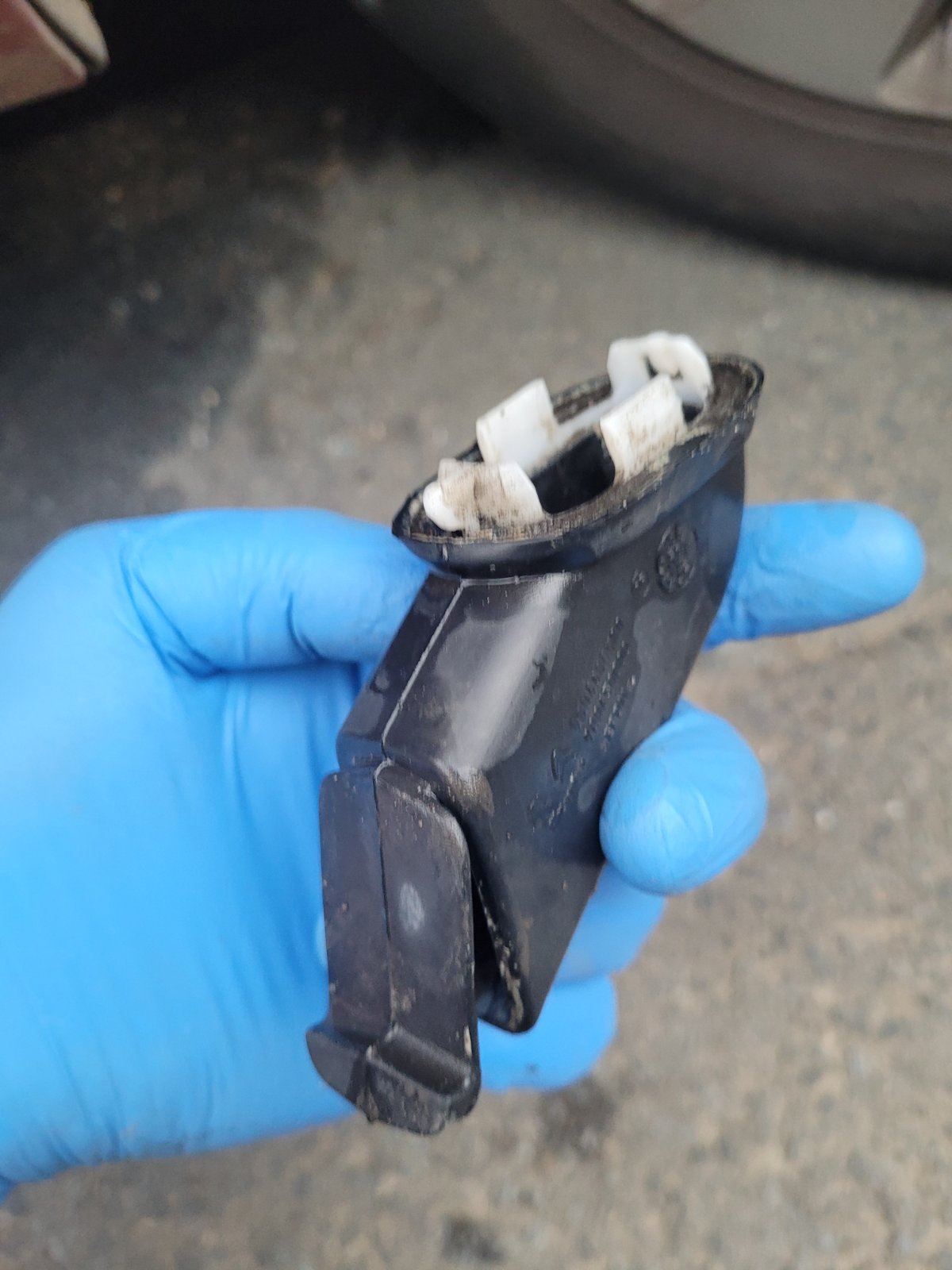

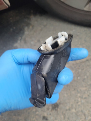

Thanks just followed your advice and got a gush of water on both sided when I removed this rubber part. Totally blocked up. Can't for the life of me reattach it though lol
