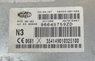

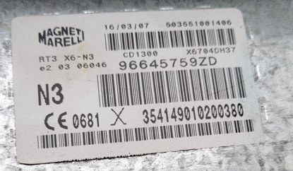

I'll need to check which system your vehicle originally had, as it could of been an RT3, RT4 or RT5. These have different software, so will not be compatible if you have replaced it with a different unit.
Please post your VIN in full without spaces - it will be automatically masked from public view after submitting your post & will only be visible to staff and I'll check. Ideally a picture of the label of the replacement unit will also help to determine what the new unit is v what was originally on the vehicle.

I will add pictures of both labels - the one from the defective (old) unit and the one from the replacement (they are almost identical). And I know, it says RT3, but it's definitely the RT4 (built-in HDD and it was also confirmed by Citroen).
