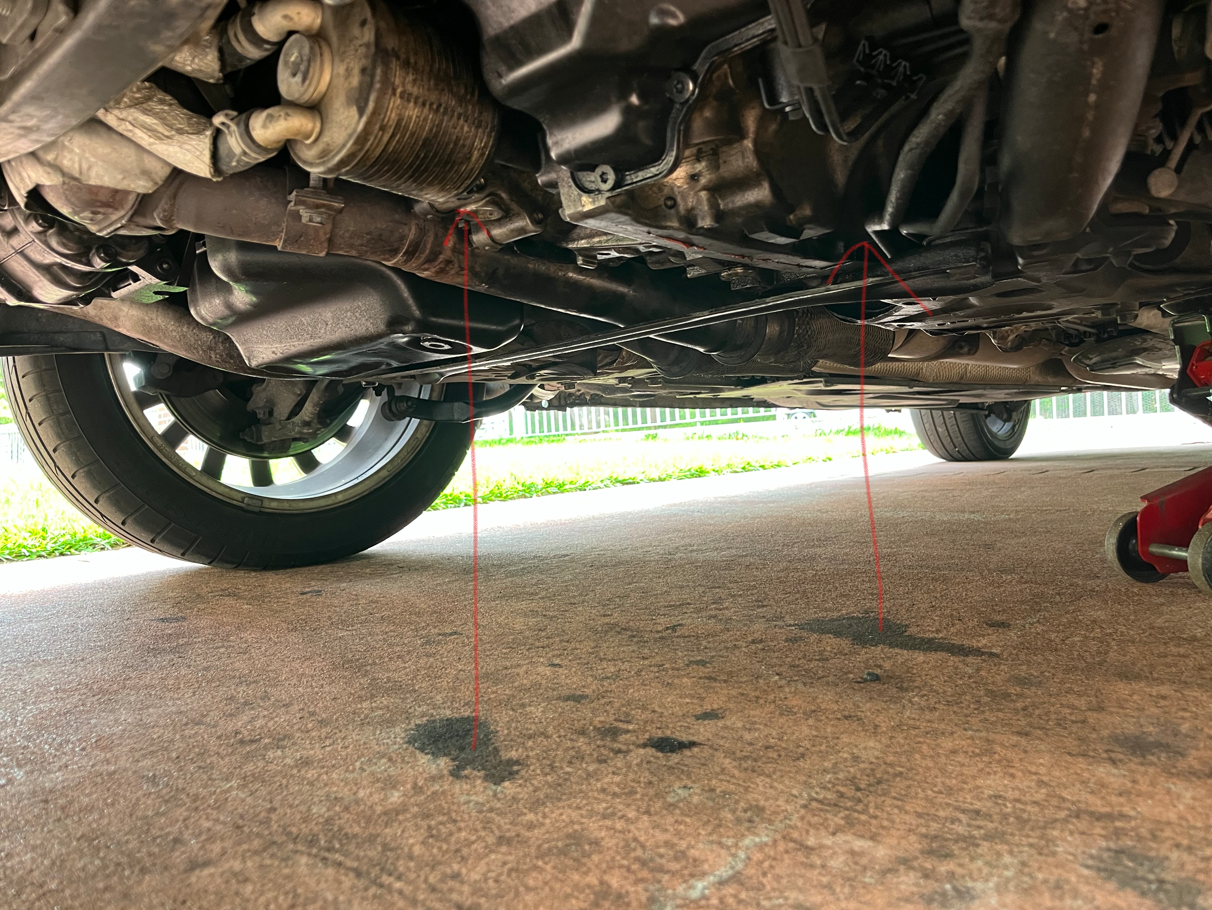

Went for a short drive (10 kms) at low speed and stopped at some shops. Came out an saw a wet patch under the car (auto transmission side) and using tissue found it was engine oil (not red auto transmission oil). Not a lot but enough to concern me as its never leaked oil before (eg driveway is clean) .
Drove home the 200kms and watched the oil and temp gauges just in case a pipe burst etc but seemed fine.
Left it in the driveway with some cardboard and next day had some oil in two places, both on the auto transmission side.

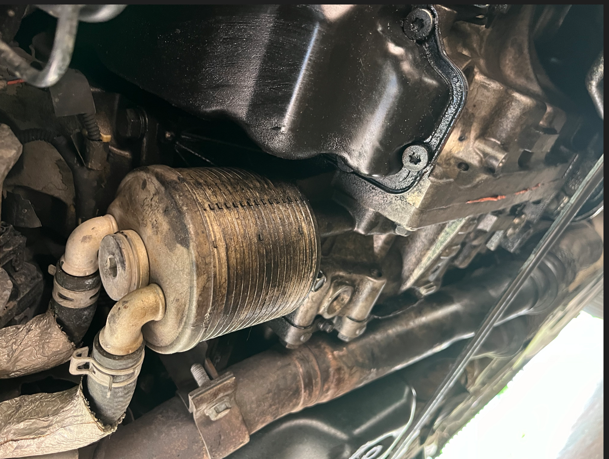

Jacked up the car and had a look underneath. The auto transmission oil cooler looks fine and pipe were dry and clean.
The rest looked okay (but fairly coated in oil) but I did notice some red gasket suggesting the transmission / engine might have been pulled apart.
I'm now suspecting a leak somewhere near the engine oil filter cooler that is making in way down the engine.

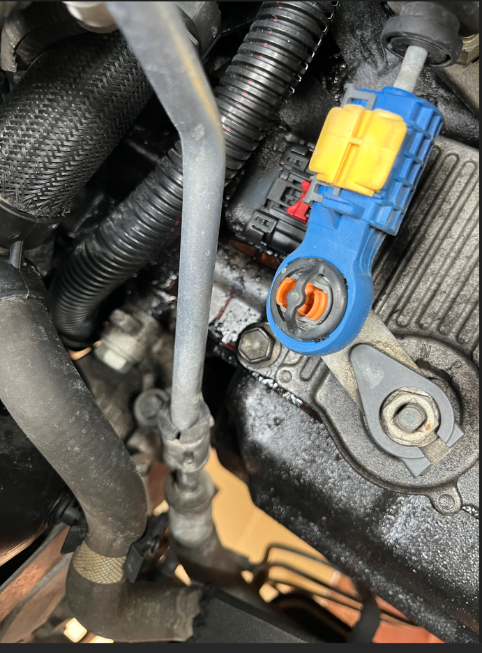

I've investigated this further and still stumped as to where the oil is coming from.
Both turbos and surrounding areas look reasonably dry / clean on the outside and not covered in oil albeit the rear one is a bit more oily than the front one.
Also removed the air pipes and all are clean, no dripping oil, including the final intake into the engine post turbo cooler. I have assumed if oil is leaking into the turbos the insides of the pipes would be oily. Also no blue smoke blowing thru exhaust
Removing the turbo air pipes, air cleaner etc, the top of the auto transmission is covered in oil and suggests its coming from above the auto transmission somewhere.
Note turbo's are below the auto transmission and no sign of oil spray.
Oil filter and diesel filter areas are above the auto transmission but seem clean, no obvious oil run visible.

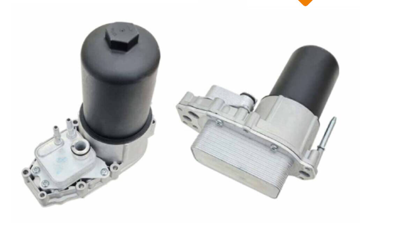

Some posts suggested the oil filter / cooler gasket might leak so I investigated this
