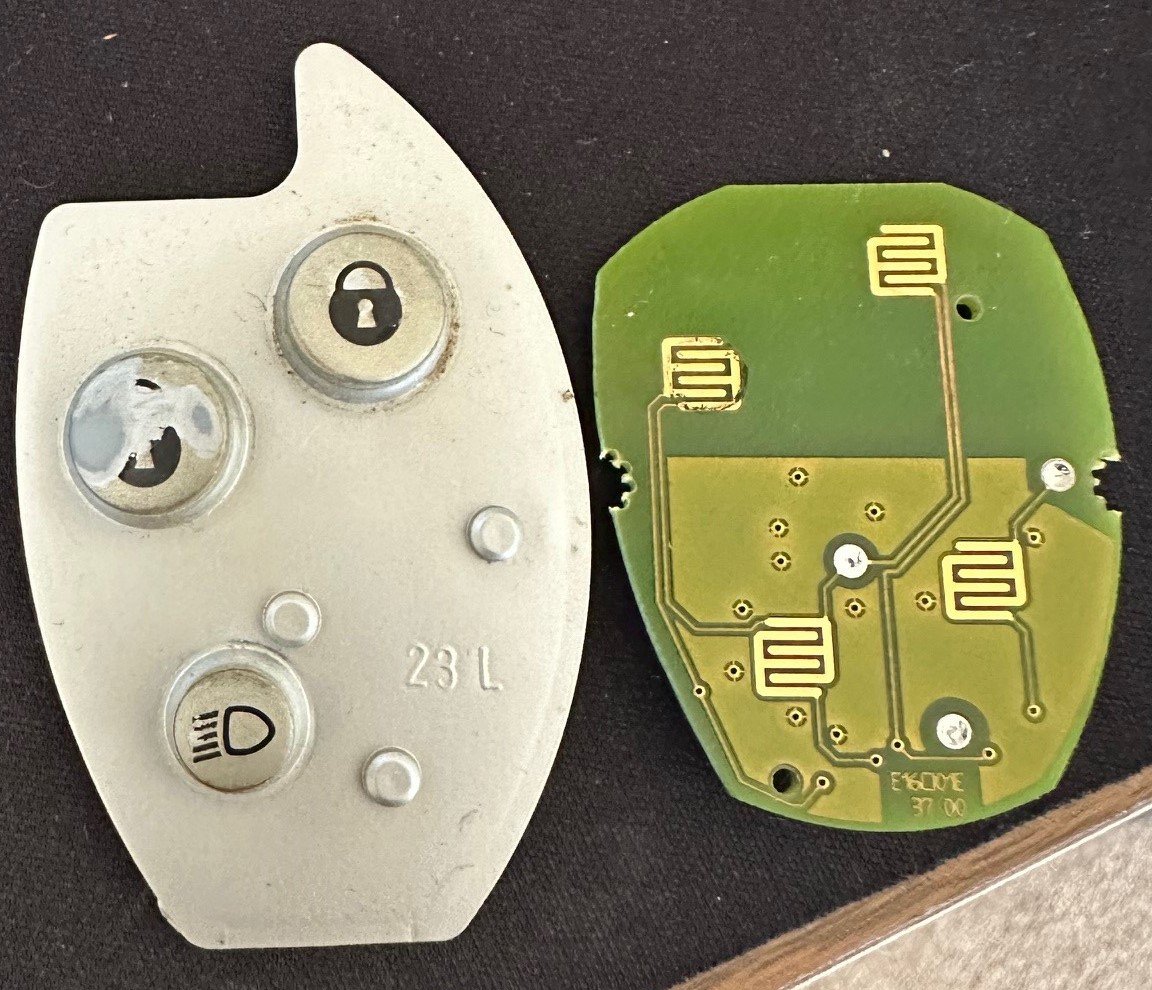

Another quick question while I'm here, I didn't realise how easy it is to replace the rubber 'buttons' that wear off. I can't however find the correct rubber for my key. I can see a membrane with a boot unlocker button, but not with the headlights symbol, see below:
https://www.ebay.co.uk/itm/391926702240
I imagine this would fit, but I'm intrigued to know if anyone has found the membrane with headlights? And lastly, I did notice on my key circuit board, there is a 4th 'button' that looks like it could be used on some cars, but not mine. Any ideas what this 4th button would be for?
Thanks, Dom.

- Posts: 9420
- x 1941
Re: C5 mk1 facelift problem with remote central locking
I think the fourtspacr is for vehicles that have a sliding side door. Could be wrong though.
- x 6946
That'll be for the C8 and 807 which had a lock and unlock button (top 2 buttons) and 2 additional buttons to operate the left or right electric sliding doors (bottom 2).

Dommo
- Posts: 1210
- Joined: 11 Apr 2009, 09:43
- x 20
That would make sense thanks guys. Unfortunately Marc that key is no longer available by the look of things. I suppose a boot unlocker symbol is not the end of the world for a fiver! Cheers guys
- Posts: 9420
- x 1941
Maybe you could get the membrane with the light symbol and then cut that half off? One here quite cheap https://www.ebay.co.uk/itm/303490470247 ... R5im5JzBYw
Possibly worthwhile contacting the seller to see if he can supply the other type?

Dommo
- Posts: 1210
- x 20
If you see my first post again I put up an eBay link for the boot symbol membrane for a fiver, even cheaper.. in fairness my membrane isn’t too bad now I look at it on the photo above.Paul-R wrote: 04 Mar 2024, 14:15 Maybe you could get the membrane with the light symbol and then cut that half off? One here quite cheap https://www.ebay.co.uk/itm/303490470247 ... R5im5JzBYw
