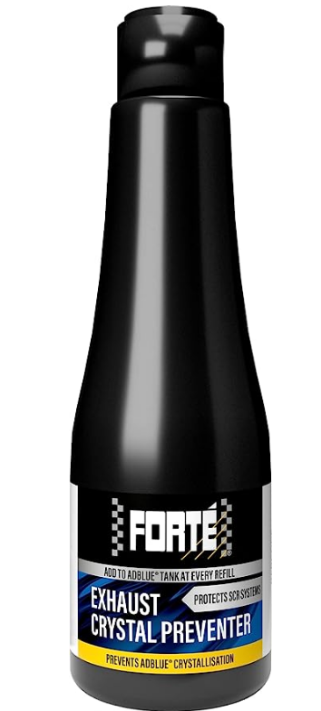

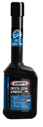

1) Use an Adblue additive like Wynn's or Forte, which you add when topping up the Urea. Make sure you use the domestic vehicle versions of the additive as they do commercial versions! This helps remove and prevent crystallisation in the system. It can really help reduce the build up at the injection point which can cause Adblue faults when the injection rate reduces due to blockages here.danlat1415 wrote: 01 Mar 2024, 12:07 I've seen that some people on other cars use an additive into the Ad-Blue tank to prevent crystallisation build up.

I'm unconvinced by the additive - the solution is pretty much saturated, so the Urea crystalises out very easily (i.e. if you spill it) - I can't see how a tiny amount of additive is going to stop it dropping out. I imagine that the inside of the tank above the liquid level will be covered in crystals, but these will wash off when the car is moving and the stuff is slosing about. On the other hand, I can't see the additive will do any harm! All adblue is (should be...) ISO 22241 which is 37.5% Urea in 62.5% distilled water so any will work. Avoid those that are stored on garage forecourts in the sun (as this can degrade the urea) or are suspiciously cheap from unknown sources! There is no monitor of the actual fluid - the 'quality' is only monitored via the efficacy of the NOx reduction; if the adblue is being injected, but there is no (or low) NOx conversion, then it will (may) flag a fluid quality error. I think it more important not to overfill the tank and spill it all over the top which might then make its way into the electronics - I just stick 10 litres in ours (about 8k miles) when it asks for it. Must be due soon... Currently B&Q are doing 10 litres of Carlube for £12 which seems a good price as it's gone up, and mostly around £20 for 10 litres now.

It contains a lot of nasty stuff looking at the data sheet and reduces light crystallisation / can prevent build up.
I've been using it without incident for years and hope to keep it that way.

Thanks for all your comments.
I picked up some Wynn's Crystal Clean Protect from local motor factors today - £8.87
And I'll get some Carlube (10L of Ad-Blue) from B&Q for £11.99 at the weekend.

For the cost of a bottle of anti crystallisation from any of the manufacturer's it has to be worth it in my opinion to help prevent the faults and issues associated with crystallisation of the components. I can't see them being allowed to market the stuff if it doesn't work. Low exhaust gas temperatures and adverse temperatures can cause crystallisation. That's one reason why the spray pattern is also very important (the science is here: https://sciendo.com/article/10.2478/amns.2020.2.00004)
There are quite a few companies manufacturing solutions to stop crystallisation occurring so my advice is to make sure you don't over-store Adblue, top up your tank when when you can get at least 5-6 litres in (refer to your specific handbook for any minimum volumes to top up and pay specific attention to the period to wait before switching the ignition on where stated). Usage will vary depending on driving conditions for each person / vehicle, but you should be able to get an idea over time as to how much you use in what period and will be able to work it out in future for topping up purposes. Having a fuller Adblue tank will also help insulate from extreme temperatures.
In my case I tend to use a lot more than the suggested 17k miles to a tank of Adblue! So far, I've put in 30 litres to date and have just yesterday topped the tank up and emptied the last of another 10 litre container and the tank was near full as far as I could tell. My vehicle has done 28k miles, so is using more than average, but I would suggest that's because my vehicle is only used once, maybe twice a week on round trips of 36 or 6 miles, so that may be the reason that it uses more.
The main ingredient is Butoxymethylethoxy which is a solvent based chemical and this is what prevents the crystallisation and can reduce / eliminate existing crystallisation in the system.
