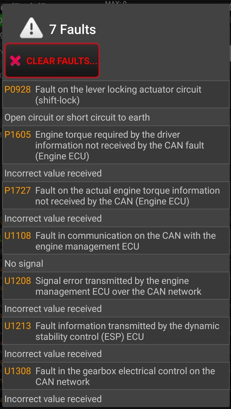

I have a 2010 60 plate Peugeot 3008 2.0 163 automatic. Fully serviced and looked after.
Yesterday I accelerated hard and the revs went up but as I did so, I heard a loud pop and the car went into limp mode with errors lighting up about the gearbox ,engine, esp, parking brake.
Got home to find a rear blowout and the tyre was completely flat. That was probably the pop.
Plugged in an OBD reader and used a Peugeot FAP Lite app and a whole bunch of codes popped up.
I've just bought this car. Due to drop into garage this weekend by limping in. Wanted to ask anyone if they had any ideas if a busted ABS ring / speed sensor or something similar could cause a cascade of electrical errors like this when the rear wheel went back at 40mph
They don't disappear when I restart the car either and the car beeps when it's stationary.
Anyone have any ideas?
