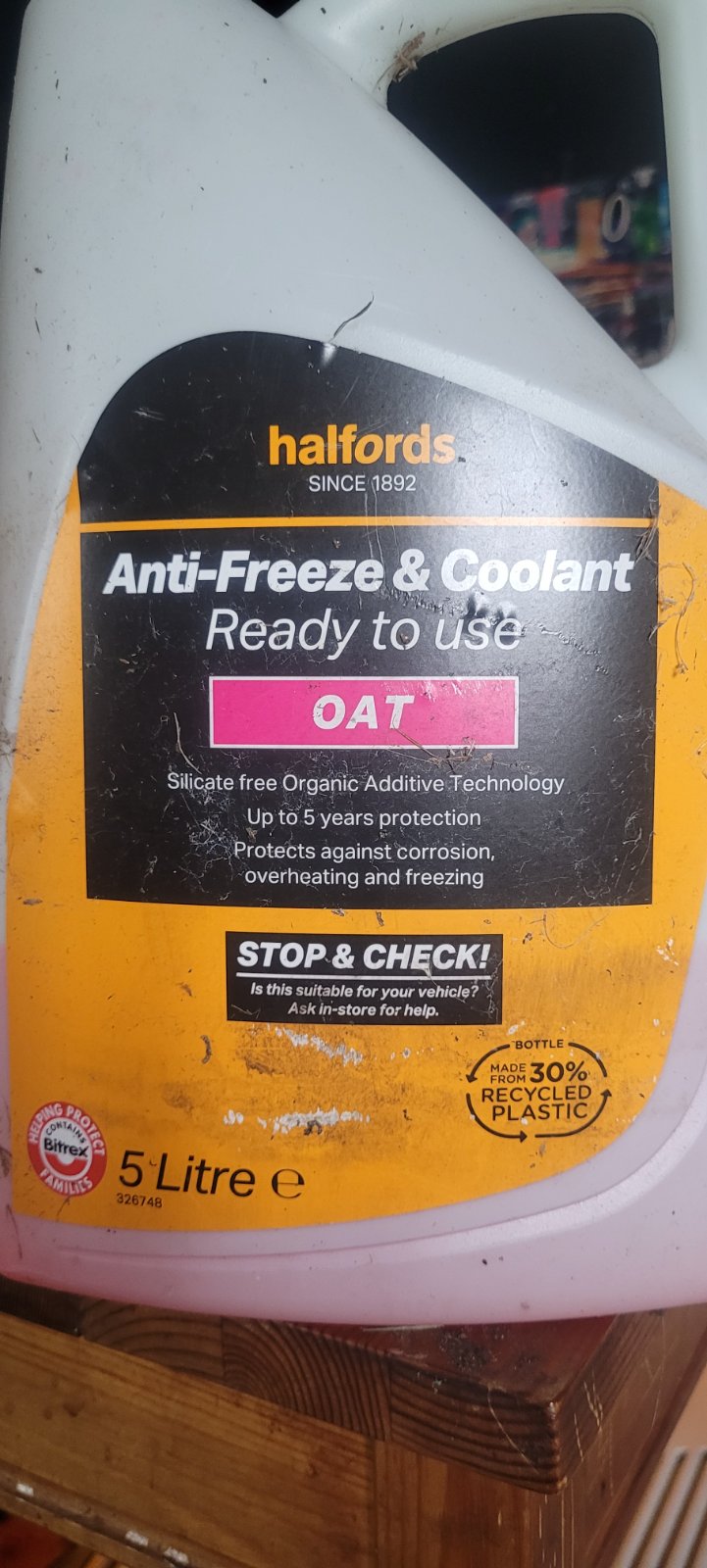

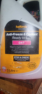

Can anyone tell me if this the correct coolant for my car?

I can only tell you what officially is used by Citroen:
Freecor DSCFluid ready for use
5LT container, part: 1637756480
PSA Standard: B71 1111
Remember there are different versions, but this is the ready to use part number - like this:
https://www.ebay.co.uk/itm/285562441215

Re: Engine coolant
GiveMeABreak wrote: 28 Feb 2024, 19:42 I can only tell you what officially is used by Citroen:
Thanks.
Do you know the capacity of the cooling system? Just wondering how much I need to buy. Im doing the timing belt and water pump also the thermostat is being changed, so I thought a flush would be in order.
- x 6947
Re: Engine coolant
The quantity isn't specified I'm afraid, but ensure you de-gas it properly.
The procedure is the same as for this engine here, your vehicle is not Euro 6, so follow the relevant part for non-Euro 6 engines on the degassing part.
Drain, Refill and Degas Cooling Circuit
