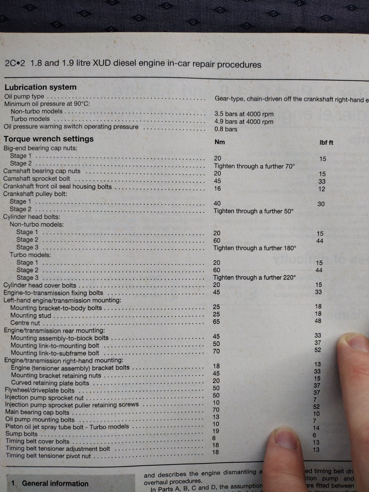

Does anyone have the torque settings for the main bearing bolts and the big end bolts for the 1.9TD (XUD9)
I have two haynes manuals (405 and Xantia) but the settings are for 1.6...1.8...and 2.0l engines...there doesn't seem to be a mention of 1.9td settings.
Any help appreciated

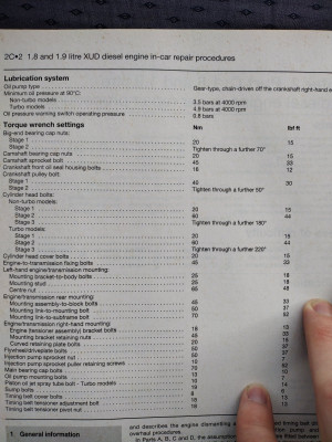

306 Haynes manual section 2C

Re: Torque sttings..help please
Thank you for that Matt.
I think I'd better get hold of the 306 manual!
