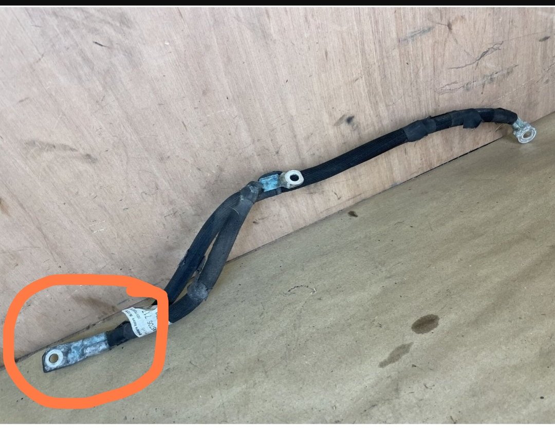

I saw the negative cable ( what is connection between carbody and capacitor/start stop controller) and it was very green. I would like to replace the cable, but I did not find the part number.
Because I saw that 2 in 1 cable is connecting the car body but i see only single cable on the services box site.
This is the cable what I looking for. But i dont know which cable is it on the services box.

6 and 7 cable is together, but I dont know why? I use official services box because I get part number.
I dont understand why the 6-7 cable together in my car. 6 and 7 cable is separetly on the services box.

So (7) is no longer available for Citroen, but looking at it, looks like you will just have to use the same fixing point for the secondary negative cable (6) (2 connections with a single bolt).

Yes. I the fixing point is same with 2 in 1 cable.
And the part number is same than 6 part number of cable? I mean 5638nk or the cable get new part number?

Sorry, not understanding your last question. But if you mean item (6), then replacement should have it's own round connector, otherwise no way to attach it. Maybe in spare parts this is the reason, but originally they may have used a complete piece for the 2 cables. Hard to say for sure. But if you are looking for second hand (and I can't see any spares for this) they may have the complete part if it was original.

You wrote me that the 7 cable is not longer available. I saw that the 7 and 6 cables are 1 cable. I sent a picture about it and I dont know what the part number is. New cable part number 2 in 1.
5638NK? Because I would like to new one.

What I'm saying is that when the vehicle was originally assembled, they may have used a twin cable with a single fixing point. But for spare parts they may have separated this into 2 separate parts to avoid having to replace both cables if only one was faulty.
This may be the reason why spares have the 2 cables listed separately. However, as shown on spares, item (7) is no longer available in any case, so you can't buy (7) new from Citroen. If (6) is the one you need, you can still buy this and it looks like it will have it's own circular fixing point to bolt it onto the same place where (7) is attached.

Okey I understand. But I have a problem.
This part is bad in the cable. So I have to replace both cable. :(
