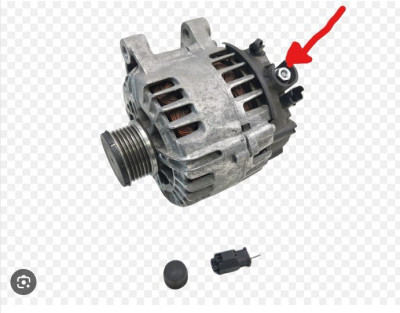

Even if the alternator was faulty you should get the same voltage reading (give or take half a volt) at the alternator main positive connection as you do at the battery positive. Are you measuring at the bolted connection of the big thick wire?

wheeler wrote: 22 Feb 2024, 18:03 Even if the alternator was faulty you should get the same voltage reading (give or take half a volt) at the alternator main positive connection as you do at the battery positive. Are you measuring at the bolted connection of the big thick wire?
I've got positive of multi meter on the positive battery terminal, on the top of a large cylindrical connection. The negative of multi meter is just on the alternator casing.

Just confirm you are measuring the positive here?
If you are & still getting no voltage move the negative lead of your meter directly on to the batter negative terminal & see if you get a reading.
