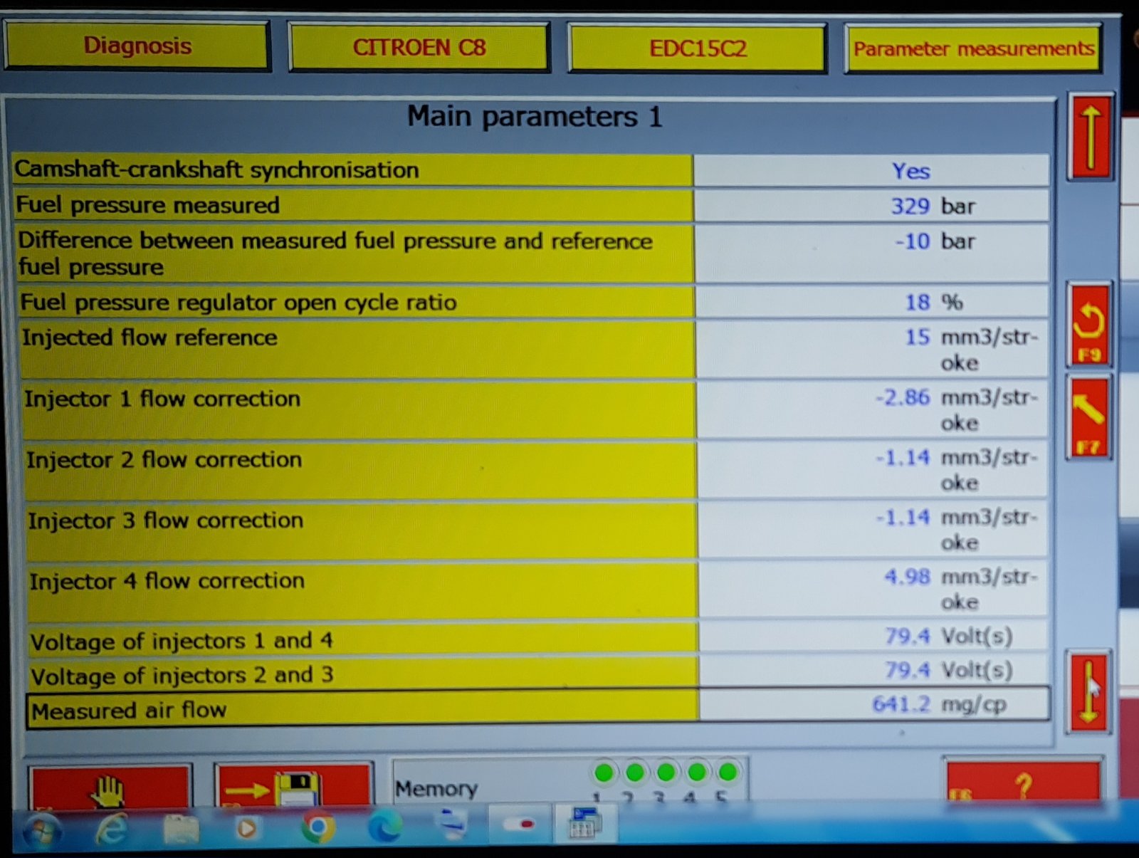

I struggle to pull off on steep hills in my C8 when cold. If I rev up to 1500 and bring clutch in I'll get a few metres and it'll stall unless I rev more and launch which isn't particularly good for the clutch.
It's a 2.2. I've tried blanking the egr and disconnecting and blocking the vac line.
I've ensured the the swirl actuator is functioning correctly (and holds a good vac - I can push the rod in and have it stick to my finger until I break the seal), I can also see it actuate fully when the revs pick up.
I've recently changed the very oily weak starter and the alternator which wasn't going above 13.5 (looks like a diode has melted some of the plastic on the old one)
So it's cranking and turning over great now but I still get this low power issue.
I've also tried cycling the ignition to make sure fuel is primed and I swapped the identical filter (and housing) over from my 2.0 dispatch. So don't think it's a fuel issue and I haven't noticed bubbles in the clear pipe.
Once running and warmed up after a minute, everything is fine, although it's hard to get mpg above 38 which seems a little low and driving it hard only drops it to around 30 so it's not a massive penalty for driving it hard suggesting it's not too happy driven gently.
I've got 3 6 theories
1.MAF I've driven without this and got no EML but I haven't yet tried it on a cold start- shouldn't I at least have an EML though? I need to revisit this tomorrow as today was just an experiment after disabling egr and freeing swirl actuator.
2. Cylinder wear so not very good compression until it warms up?
3. Glow plugs, light comes on for a second, but it's not really that cold. 5° C this morning and still struggled - but doesn't struggle to turn over anyway.
While typing I've gone back into lexia and:
4. Could it be the injectors?
5. Injectors? or
6. Possibly the injectors?
Looking at the attached image, are my injectors beyond salvage? I'm guessing if 1 and 4 are that far out no amount of cleaning will save them
Oh while idling cold at about 770 rpm, I can feel a tremor and if I rev gently, there's a very narrow window somewhere around 1200-1500 rpm where the engine notibly struggles. It's repeatable but such a narrow window not easy to see what rpm it happens
I've read the horror stories about stuck injectors too so that sound like some fun ahead..
So does anyone have any input with regards to the above (maybe even if the injectors are toast there's something else I can improve upon too in the mean time).

To follow up, unplugging MAF makes no difference and I do get an EML so I'll edit the above comment*
I put STP injector cleaner into 1/3 tank (not recommend I know) last night and ran it to make sure it pulled through to the injectors overnight.
Bit smokey as expected so will see how it goes.not sure if it's the crud coming out or the cleaner itself, I always get suspicious that they make it smoke so we think something is happening.
Any advice still welcome.

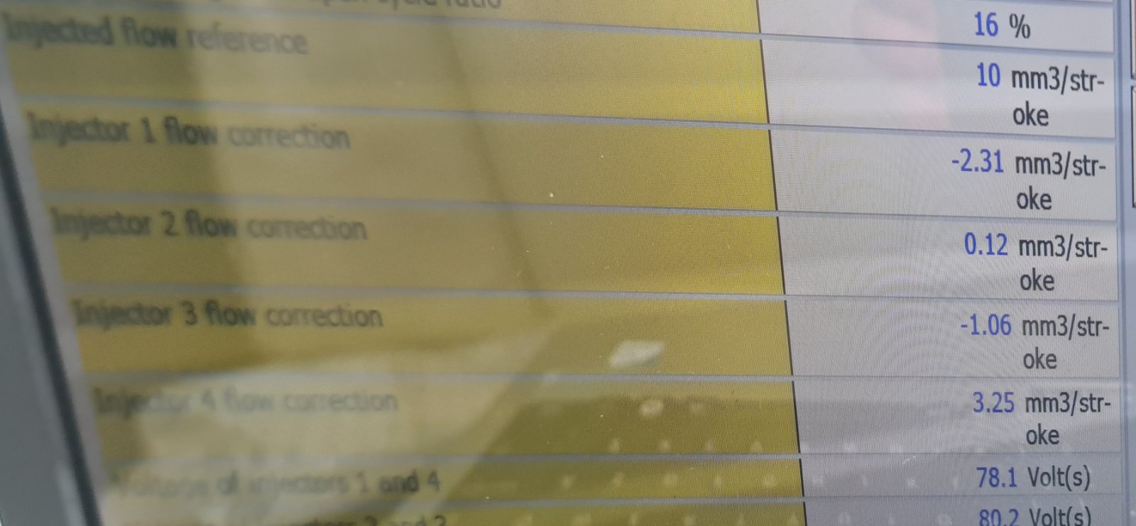

Added new image after approx 18 hours of cleaner. Not sure if it's working or other factors like engine temperature coming into play (sorry about the reflection/quality)

No improvement in the 5 days since posting. Possibly worse after the cleaner - probably exposing the injectors?
Quite an obvious tremor on first start. This persists until some point between 30-50 C if idling and the engine visibly shakes. A hard rev once up to about 30 C will clear most of the shake at idle and it'll eventually idle smooth from then on.
Still not enough torque to pull off on a hill for at least 20s (better if left a little longer with a bit of a fast idle with the Acc pedal). Once warmed up fully, it can pull itself up the same hill in first without any Acc input.
Is anyone able to confirm my injector suspicion?

Having driven or a bit more I don't think it's temperature related (not completely anyway). I get significant shuddering on cold start as previously mentioned and this seems hand in hand with the very flat acceleration (hardly any poke even in 2nd). But, if I drive it say 200 metres, it's like it wakes up and although there may still be a slight shudder until it warms up completely the torque is there, 2nd gear and a quick tap of the accelerator and you feel the expected push into the seat.GiveMeABreak wrote: 23 Feb 2024, 12:02 I can't really help as in the absence of any fault codes
.... but I would of expected fault codes with a diagnostic if the issues are significant to flag up dash lights (despite these being deliberately hidden by a previous owner) - unless of course further 'intervention' in the engine management system has also been undertaken.....
I don't know much about injectors, I've changed the seals on a 1.6 and I've read here the 2.2 ones can be a nightmare but that's it. Other than the large corrections in lexia I have nothing else to go on other than I suppose it "feels" like the injectors may be leaking and then I have to burn off the diesel before they work properly (that's just in my minds eye, it could be complete billhooks).
I can get the EML to come on if I unplug MAF and i think I triggered it when I accidentally left the MAP off when cleaning the intercooler. Also possible when I temporarily unplugged the turbo electrovalve to see if there was a difference (limp mode at 2k rpm iirc) either way lexia stored those faults so at least they haven't been deleted from the fault table(?).
The only other info I can be fairly sure of is that the car seems happier in 4th 5th. 6th doesn't seem to give much benefit but it hasn't been on many motorways just Welsh bypasses and dual carriageways so the conditions haven't been ideal for a fair test. But the fuel penalty doesn't seem as bad if its driven hard in the lower gears, whereas driving as if there's an egg under my pedal doesn't seem to bring the expected economy.
BTW with the egr disabled I also got a lexia code but no EML. I think it was something like less air than expected . I can't remember exactly but it made sense if there wasn't exhaust being diverted back in.

What I've now observed:
Egr electrovalve is being commanded to open and close until the shaking stops then stays open 85% at the very moment the shuddering suddenly stops. (I'm still going to reconnect when I get a chance just so the ecu can have it's expected values).
The shudder stop seems to be around 62 C (if the car is already warmish, though I'm sure I've observed lower temps although I think this maybe due to cold engine having higher idle and thus cancels some of the shudder ). If I let the car cool to around 55, the shaking comes back until temp gets to around 62 and then it's like as if an old choke engages and it's much smoother, there was no graduation of intensity tonight, it was bad shakes one second then fine the next
Revving the engine stabilises the shaking, easing off brings the shudder back at least until it warms up.
Shakes when cold seem to fluctuate the rpm by ~50 from 860 - 910 rpm. Warm shaking seems to hold the rpm at 740.
I didn't write down the measured fuel pressure but it seems to be 300 odd when cold idle and 270 ish when warm idle with the reference difference only being 2 to 10 out for the most part which may sink my FPR theory?
Are the pressure sensors the same on the 2.0 by any chance? Would be handy to be able to test with.
And lexia said I have class 2 injectors. Is there a way of confirming this is correct without pulling an injector. I don't trust any settings to be default. Someone has definitely been in there before because the climate control buttons were set to left hand drive meaning the master temp control was on the left (not exactly a major issue but proof nonetheless)
