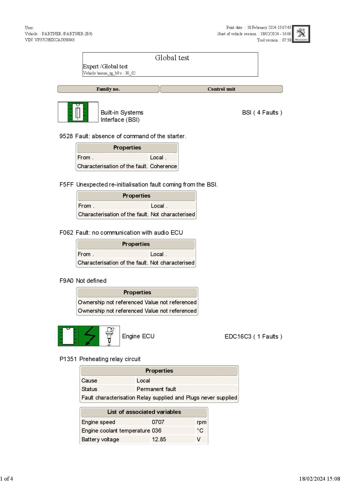

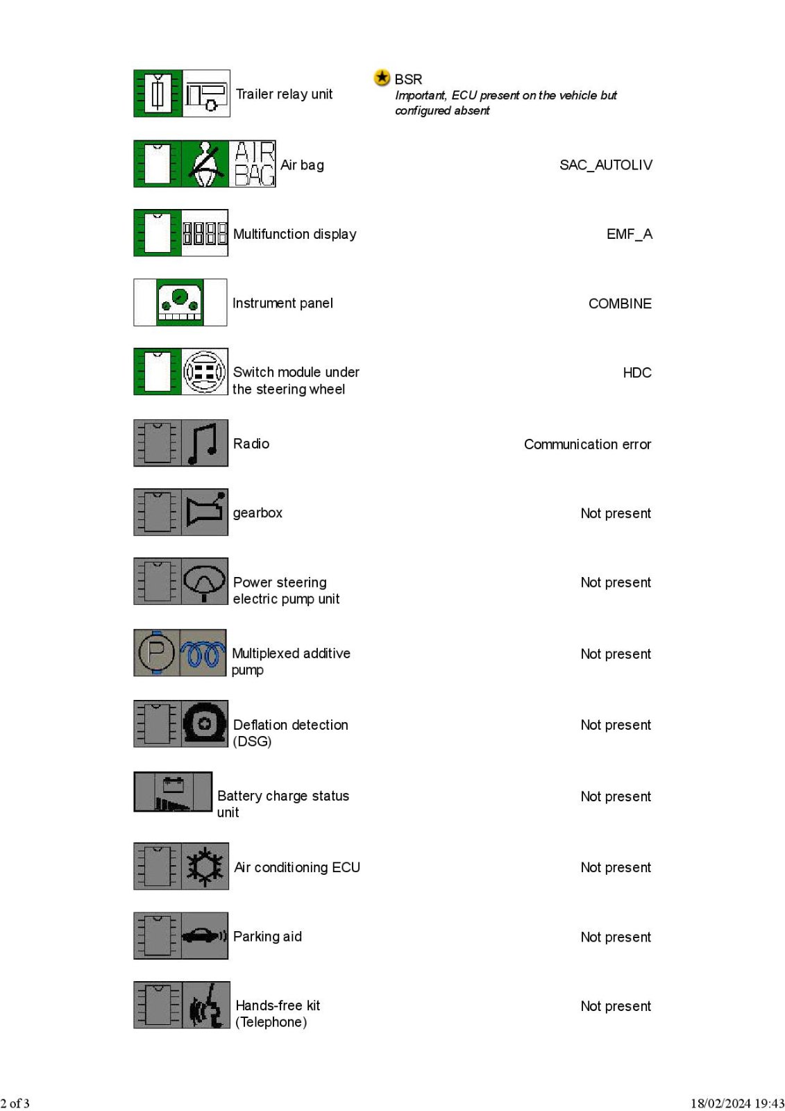

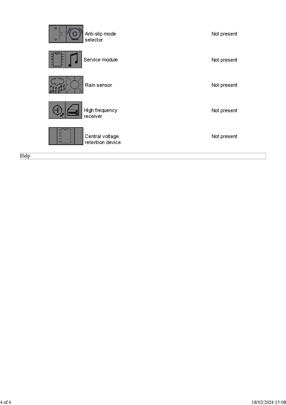

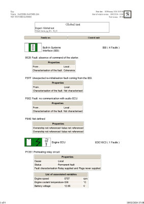

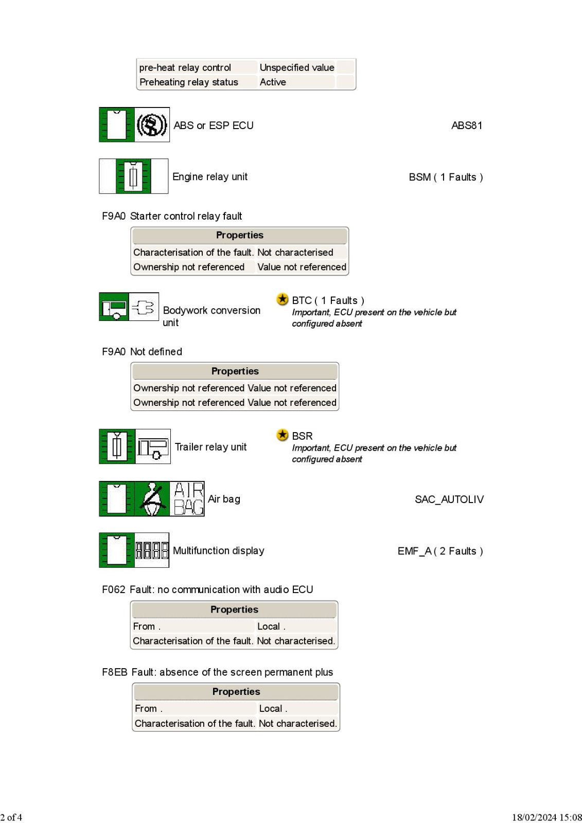

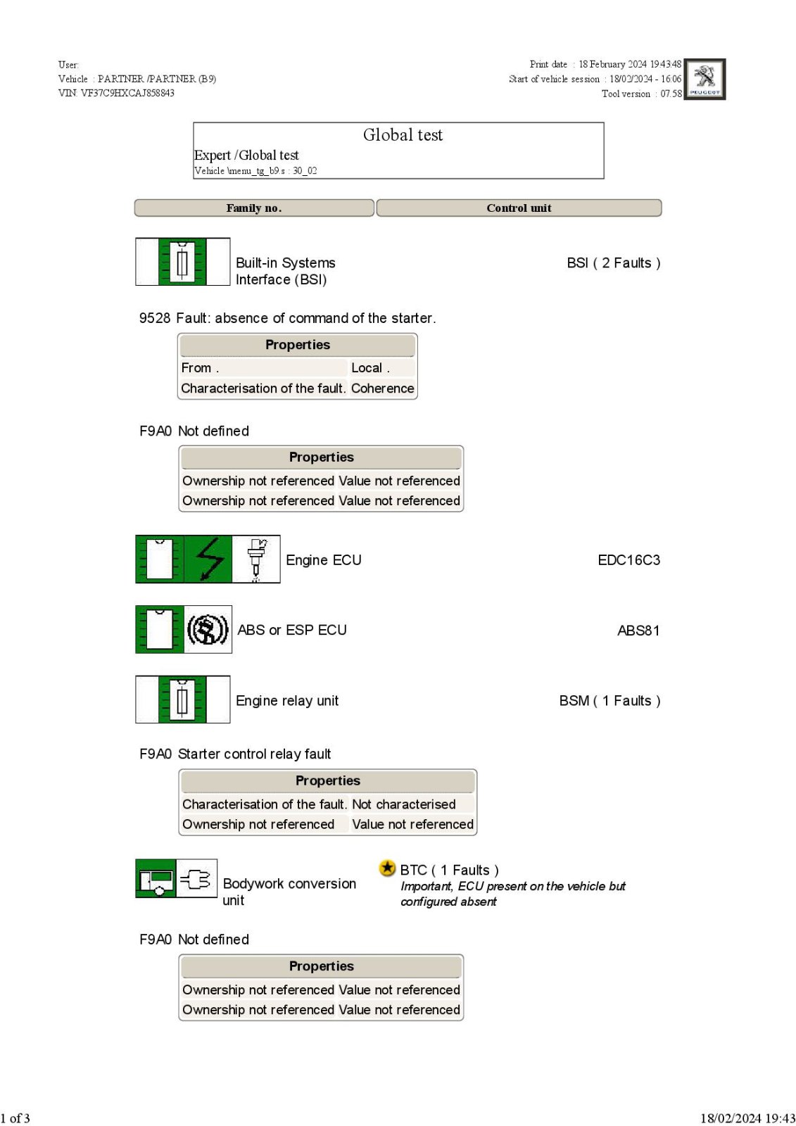

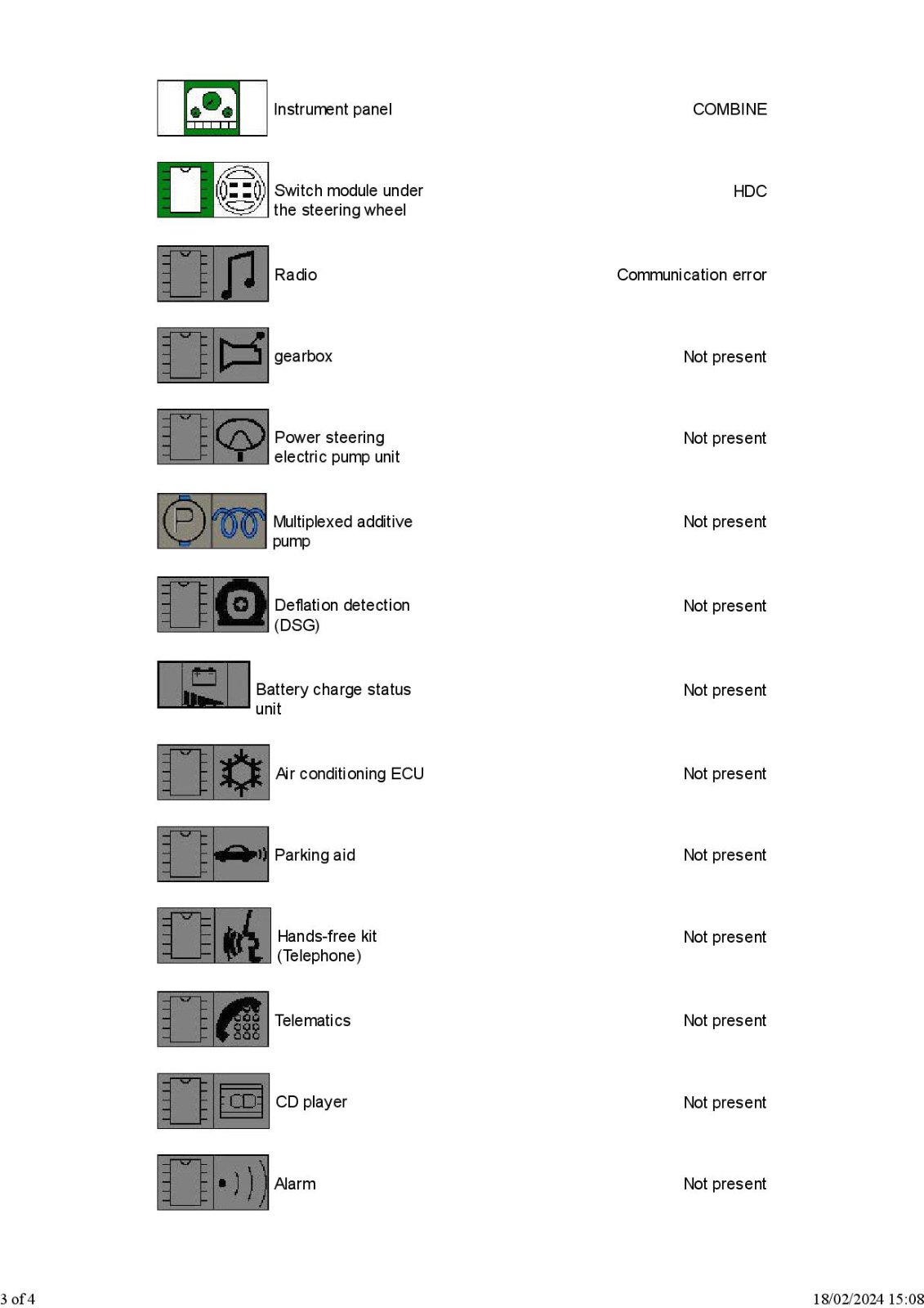

Went out today and did a few more tests. The first thing to say is that the sequence of events above is wrong. This is the correct one:
Steve drove down the road and into the layby without a problem. It was only when he stopped the van, with the engine still running, that he heard the soft bang from the engine compartment. That was when the smoke, or possibly water vapour, wafted out. A warning light came up on the dashboard and Steve then turned the engine off. It was after that that he found the starter motor would not respond to the key.
I was able to jack the car up and try turning a wheel with 5th gear engaged. It wasn't the easiest thing to check but I didn't feel any difference in the cylinder compressions as I turned the engine over.
I had the VCI for the Diagbox this time and ran the diagnostics. The battery is not great on the laptop but I got some interesting readings. This is the full code list before clearing-
Page 4 of ECUs are not present
And this is after clearing-
Page 3 of ECUs are not present
I think the interesting one is the Starter Control Relay fault. Does this mean the BSM is toast?
