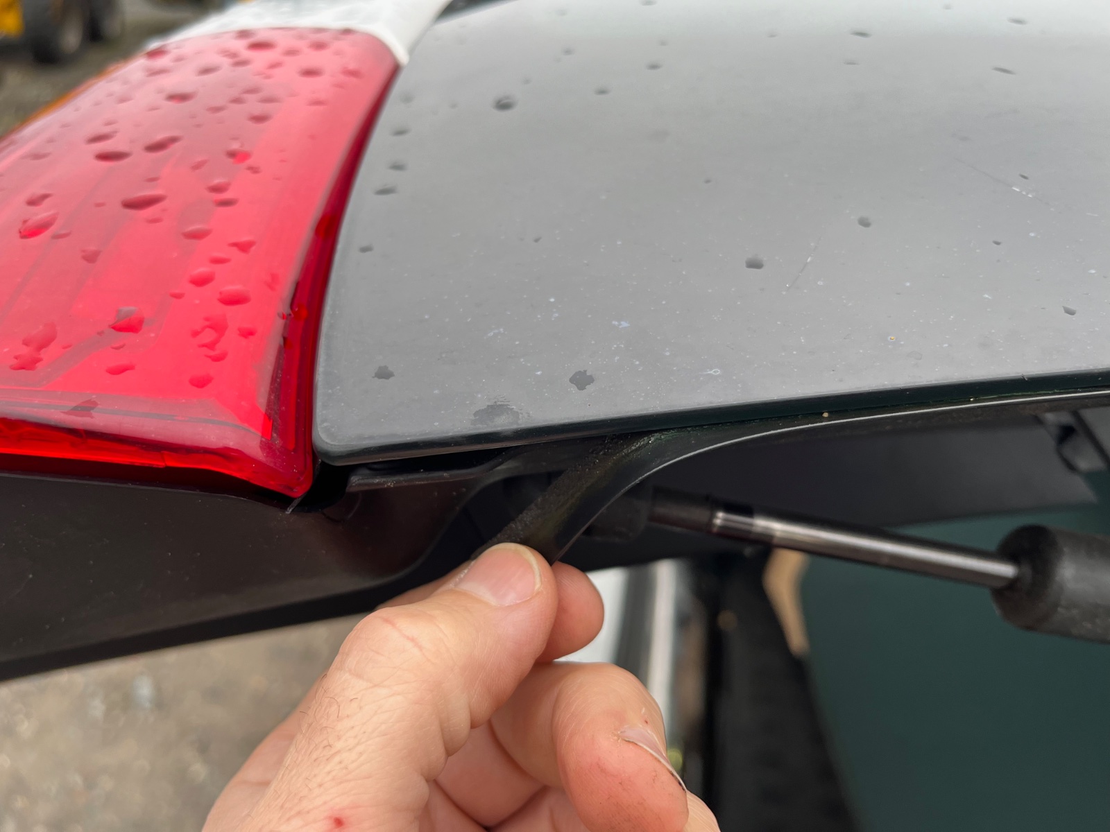

Noticed slight water ingress recently and have just seen that the rubber weather sealing strip is torn between glass and bodywork.
Has anyone ever replaced this? Is it a window out job?

All I can tell you is they do a kit for the seals here (1 left and 1 right). They are an 'L' shape, but I can't advise on their refitting, but I suspect the inner tailgate trim may beed to come off to place it.

I also have the same problem but I can't find replacements online. Is the kit available only at the dealer?

Yes, these are bespoke parts.
