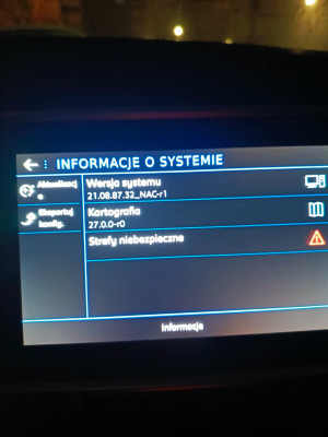

Problem rozwi?zany!
Pendrive z aktualizacj? map uruchomi? system. Firmware ekranu nadal jest w poprzedniej wersji, czyli aktualizacja która zawiesi?a system nie powiod?a si?.
Wystarczy pobra? cokolwiek do zainstalowania. Bez ró?nicy któr? map?.

Problem solved! The flash drive with the map update booted the system. The screen firmware is still in the previous version, i.e. the update that crashed the system failed. Just download anything to install. It makes no difference which map. https://sites.google.com/view/nac-rcc/system/nac/wave-2

Could you please send me the image of the flash memory content? Is there only the map file and signatures in the flash memory? Isn't the firmware version included? I am happy for you. And I will follow your path as a last resort. Can you write them in order? Best regards..fasi wrote: 11 Nov 2024, 19:20 Problem rozwi?zany!

Only map file and updateinfo. Nothing elseKakirman wrote: 12 Nov 2024, 05:02Could you please send me the image of the flash memory content? Is there only the map file and signatures in the flash memory? Isn't the firmware version included? I am happy for you. And I will follow your path as a last resort. Can you write them in order? Best regards..fasi wrote: 11 Nov 2024, 19:20 Problem rozwi?zany!

Dude, you're the best.
I mean, it's a very interesting situation.
As soon as I put the memory in, the unit booted right up.
I think PSA's latest firmware file is troublesome, even if people disagree with me.
I've lost ten years of my life in three days.
If we were closer, I'd buy you a coffee.
Thank you very much again.

Maps are completely separate installations and should not even be a problem. You were talking about Firmware which can be another story.

We talked about the firmware because the last update froze the system. The system did not work and, as it turned out, it was not updated at all.GiveMeABreak wrote: 12 Nov 2024, 10:29 Maps are completely separate installations and should not even be a problem. You were talking about Firmware which can be another story.
A flash drive with map files is the solution to the problem. You do not have to install them at all. The only thing is that after inserting the flash drive with maps, the NAC program restarts and you can use the car again.

Yes, I understand that - both maps and firmware are optional, with the exception that I already said, that maps do not require authorisation, so will install regardless. Your problem is with firmware installation that you'll have to leave for now. The map update may have fixed a glitch by getting the system to reboot properly after a failed firmware update.
Anyway, you have the vehicle working, that's the main thing. I would recommend you leave the firmware on your vehicle as it's not critical.
