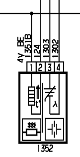

- x 6945
Re: Oxygen sensor code C3 picasso
This is the same fault (P0054) for which the table has highlighted the resistance being too high.Ddclutch wrote: 03 Feb 2024, 20:27 Thanks, helpful table, Marc. Though I don't fully understand all of the entries there.
I now see I am also getting a 'Heater resistor bank I sensor' code P0054$07E8 code. Does that shed light on this as well?
I doubt very much it is the heating power supply on Pin 1, because the power is supplied directly from the engine ECU and the same wire supplies the following components, so you would have other faults if the supply wire was compromised. I suggest you change the sensor.
Proportional Oxygen Sensor (1357)
Canister Discharge Electrovalve (1215)
Oil Breather Re-Reat resistor 1 (1273)
Pin Wiring Assignments
Pin 4 = 1302: Signal from lambda sensor C (+) downstream of the catalytic converter
Pin 3 = 1303: Signal from lambda sensor C (-) downstream of the catalytic converter
Pin 2 = 124: Control heating lambda sensor C downstream catalytic converter
Pin 1 = 1351B: Lambda sensor heating power supply

Thanks Marc. Looks like the heating component of the Lambda sensor then.
