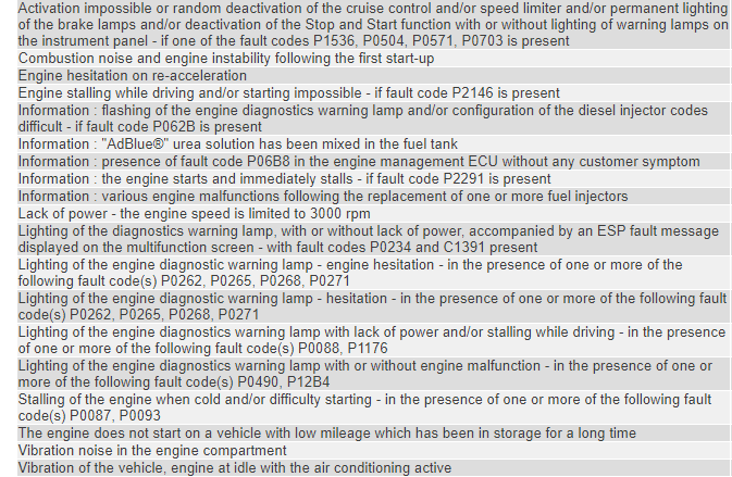

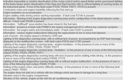

To be honest, as far as engines go, EVERY single different engine will have its own issues, so this is no way to judge a vehicle to be honest, and they do not make this public of course, only that any common issues of significance accumulated from driver feedback and dealer servicing incidents may result in a technical bulletin to assist the dealerships in fault finding common issues.
I can't go into the specifics as the actual TSBs require additional charges to access, but these are the titles for the ones only for the engine:
The DV6C engine is very common and was used over a huge range of PSA vehicles and is available in variations of power output.
