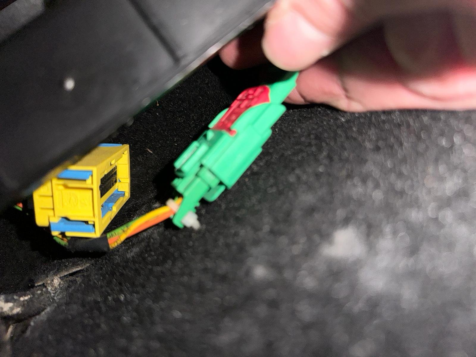

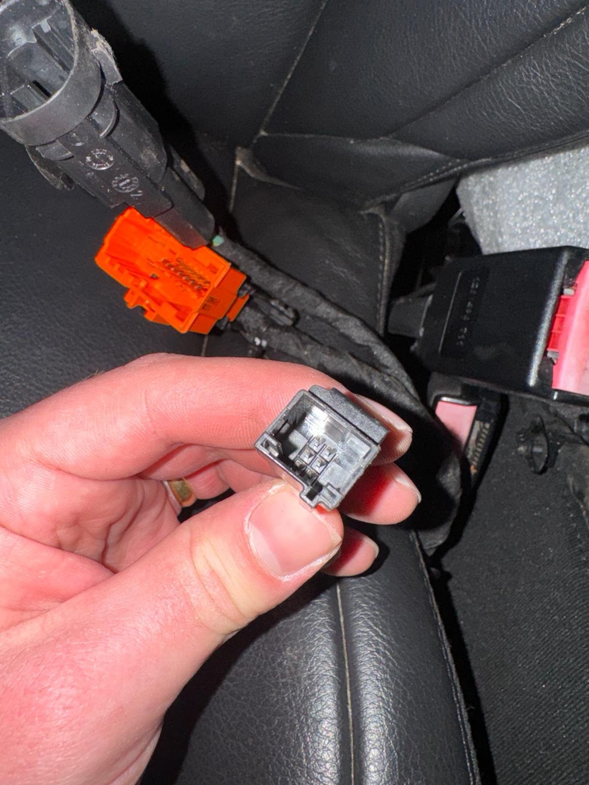

Hi,
I'm trying to adapt the seats from the Peugeot 308 CC on my C4 VTS, everything is plug&play except for the electrical part. These seats from the Peugeot are manual and only have heating, at this point I'd like to connect only the airbag wires (I don't have the wires for the heating system on the C4).
The problem is that the Peugeot has seats with twin airbags, so there are 6 wires in the airbag connector while in my C4, there are only 4. I imagine 4 wires are intended for the airbag and 2 for the seat belt, but I need to know exactly what each wire is.
Could someone help me by providing the electrical diagrams of these connectors from the 308 and the C4?
These are the VINs:
C4: VF7**************[VIN obfuscated, can be read by forum staff]
308: VF3**************[VIN obfuscated, can be read by forum staff]
I really appreciate any help you can provide!

I got the diagrams, but unfortunately, they don't have specific details about the seat connectors. Probably I'll need to disassemble a seat.

This won't work as far as I can see - you are trying to install Carbriolet convertible seats into a standard vehicle and cabriolet seats have different airbag configurations to account for the lack of side (curtain) airbags that a standard vehicle will have. As this is a safety issue with potential consequences, we can't provide support of this type of modification.
