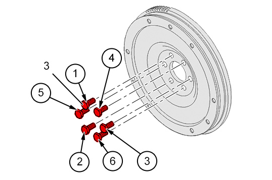

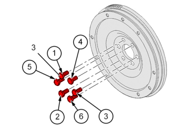

Flywheel
(3) Double Damping Flywheel Bolts:
  • Pre-tightening to 2,5 daNm
  • Slackening
  • Pre-tightening to 0,8 daNm
  • Tightening to 3 daNm
  • Angular tightening of 90°
Tightening Order
