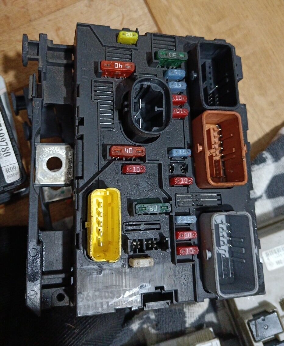

Ok, much bulb squeezing, fuel definitely going thru, tried several bump attempts, not even a cough. However, once we'd tried that and given up, I noticed that when I turned th ignition I could hear relays click from th glovebox area, just a couple of times and a message came up saying anti pollution faulty, tho now, that message doesn't appear and th clicking has stopped, I'm wondering, do rats eat th wires in this age vehicle or is it th less tasty type of plastic, it's out by an airfield, so undoubtedly there's a thriving rodent population...or is it time to remove th fusebox and see if there's water down below, tho, as I've been pushing this thing around for an hour, I'm feeling a tad nauseous so that may have to wait a while. This stuff was far less arduous 40 yrs ago....

Go to the under bonnet fusebox & locate the yellow plug, disconnect the connector & locate pin 2.
Confirm the vehicle is in neutral & switch the ignition on.
Apply 12v from the battery to the wire of pin 2, if the starter & it's wiring are ok the engine should crank .

Outstanding, thank you. I've retired defeated for th day, but I'll go and have a bash at it tomorrow...
