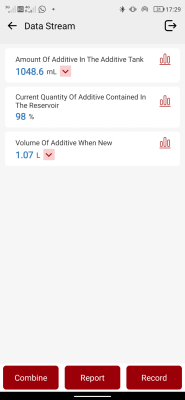

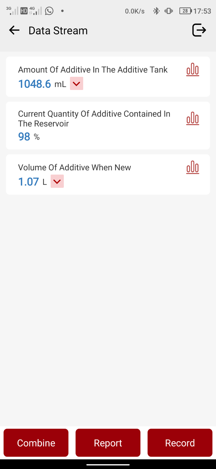

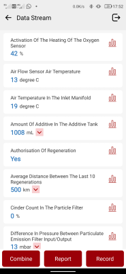

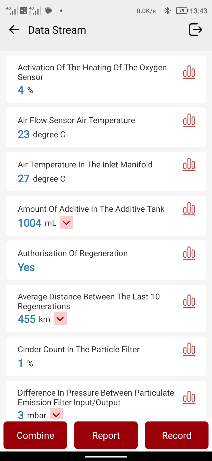

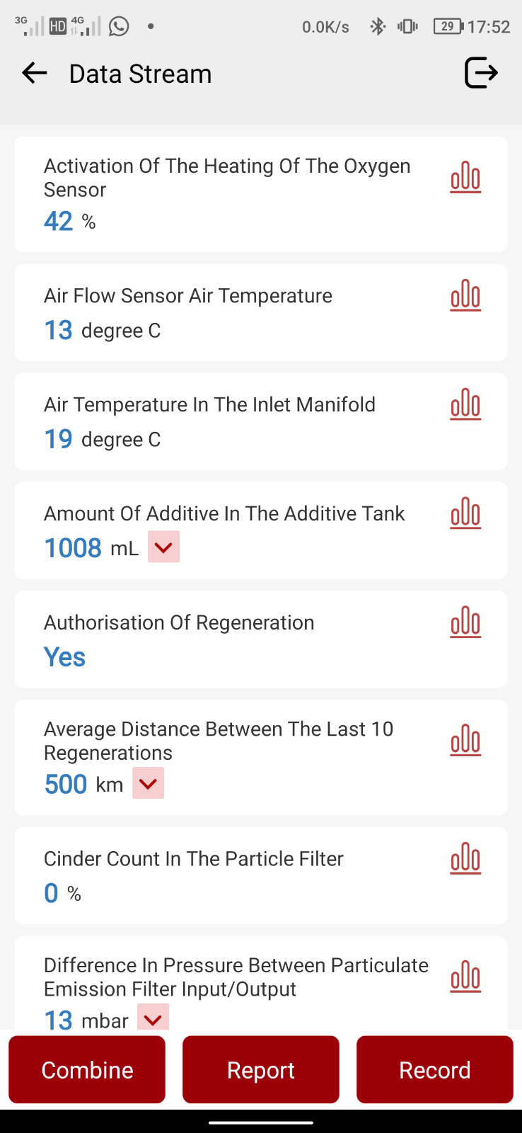

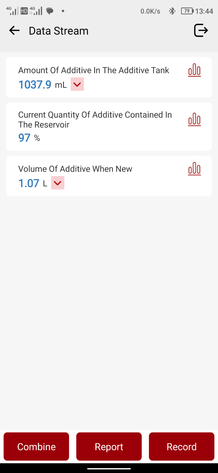

I don't know is this is correct or incorrect this is my experience with additive tank toping up.

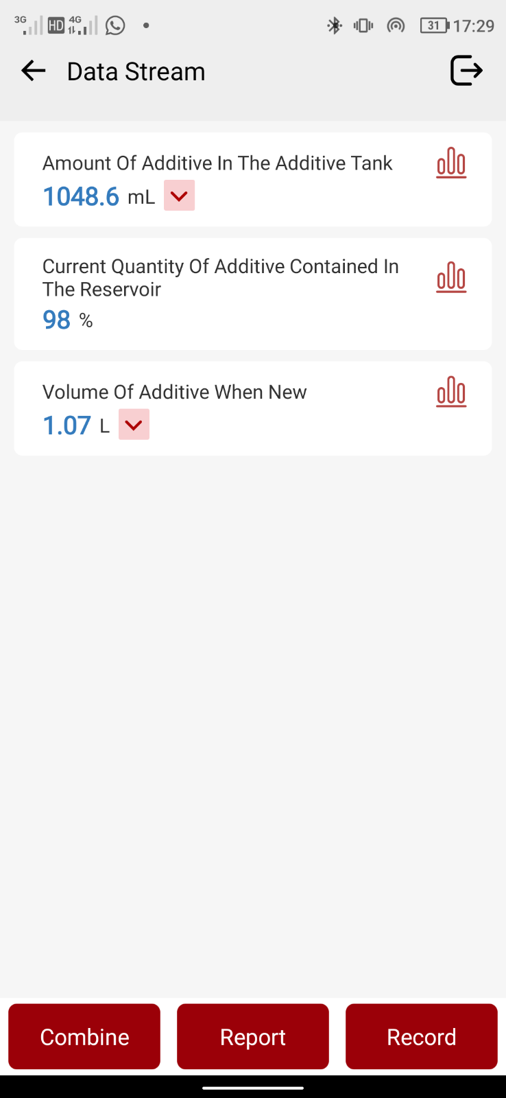

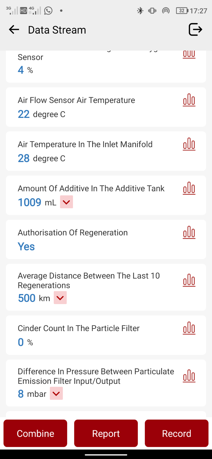

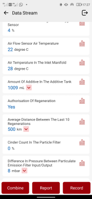

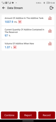

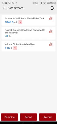

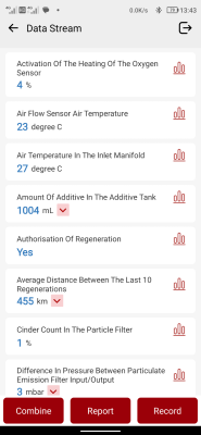

Look at the amount of additive in tank.
Straight after topping up
Reading from ECU Reading from Additive Tank Filled tank with 12 liters of diesel,
ECU Additive tank Filled half tank
Additive tank ECU, I
As you can see we are dealing with two independent counters which are not in line with same corellation.
I'm in the middle of resolving problem of P1409 error. In my case there is other underlaying problem which causing fast DPF sooth building.
It's looks on EGR problem as soon I run actuation test "Checking the function of the EGR circuit" it trough out P1409.
Also in past I had restarted amount of additive tank without toping up. Amount in additive tank was showing 5 ml in ECU aroung 900 ml I never got any low level warning simple DPF was blocked.
Any resources how to read EGR values and how to investgate it from interface ?
Thank a lot for
P.S. I'm not expert or mechanic so please take correction if I write something wrong.
Michal

So as I explained the eolys additive tank has no physical measuring device.
It knows how much it had in the tank from the factory.
This will last for a set amount of miles / KMs. How long it lasts depends on the driving conditions.
The engine ECU adds a very small amount of additive to the fuel tank whenever fuel is added, but as said it is a very small amount, so you may not see any measurable difference in the quantity of additive remaining in a short period of time with such a small amount of fuel added. I suggest you check it in a few months time.
Your diagnostic tool is presenting data as if the additive ECU is separate - which it is not, so don't think there is another ECU. It's all done by the engine ECU, but the level is only estimated based on known original known additive values, amount injected into the tank and distance travelled, as well as driving conditions.
If you have reset the additive counter without topping up the additive tank, then that's a big mistake. Doing this means the engine ECU thinks it has more additive in the tank than in reality. It also means that it will not put the 'low additive' warning up when the level would normally become too low.
When the engine ECU calculates (or thinks) that the level is getting low, it uses the information from the maintenance / service counter to determine if there is enough fluid between the trigger point and the miles / KMs before your next vehicle service is scheduled. If it thinks the fluid will run out before your next service, it will flag the warning up. In your case, if you have reset the counter without topping it up, then you could basically be running without any additive in the system. That then has consequences as the additive pump can burn out if it is dosing without any fluid.
