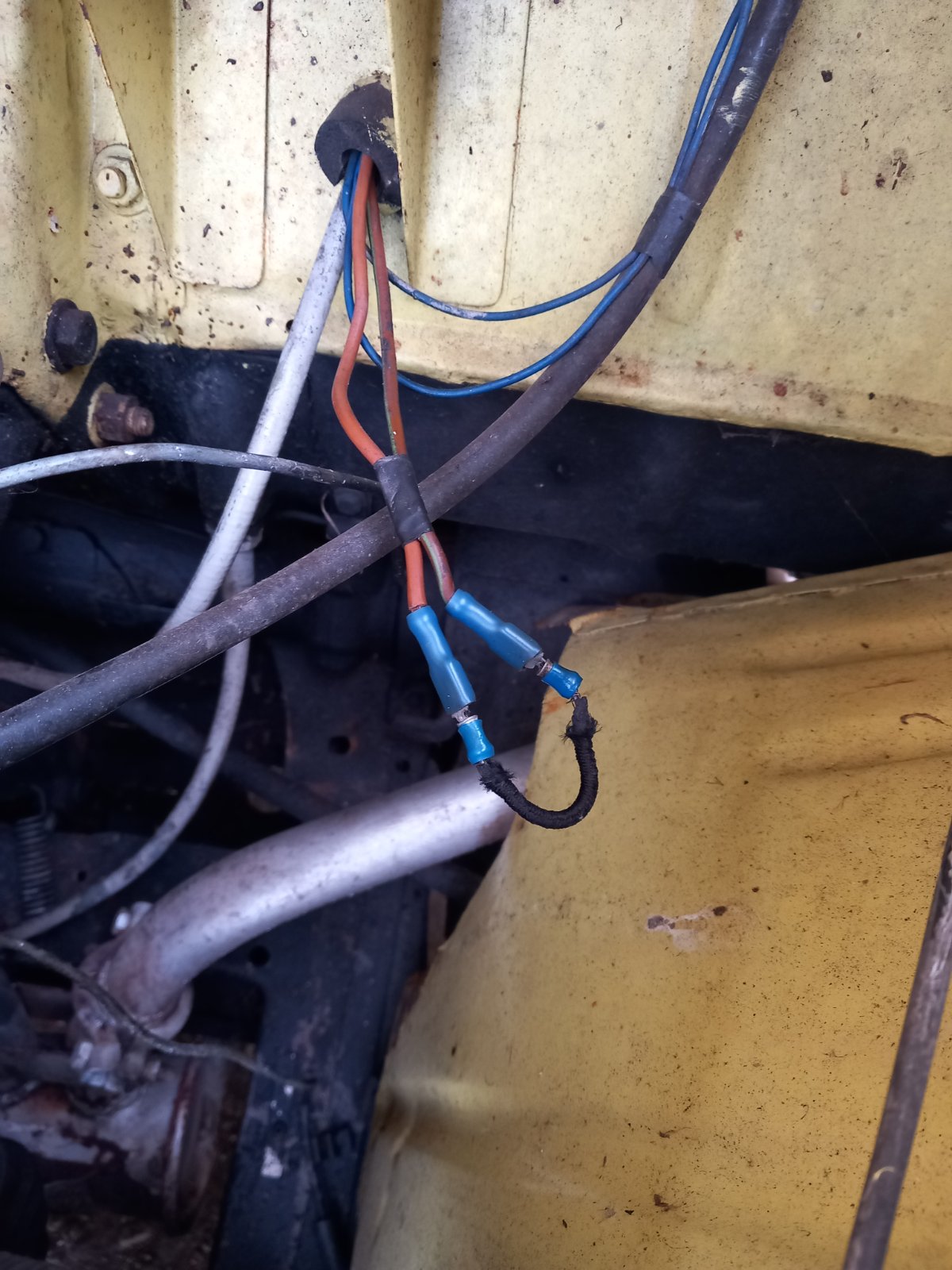

Hey. Yes still have points. Dunno whats i did but she started up 1st turn. was done for the day and just tried to see if anything changed... YAY. Power back to dash and oil pressure light works again as does the petrol guage. Turns out there is a pair of brown wires going through where the speedo cable goes through the bulkhead from inside. theyve been "jumped" together but the wire must have had corrosion or bad contact. Tomorrow im going to join the wires properly

I've had 5 2CVs. That wiring looks quite normal for a 2CV
