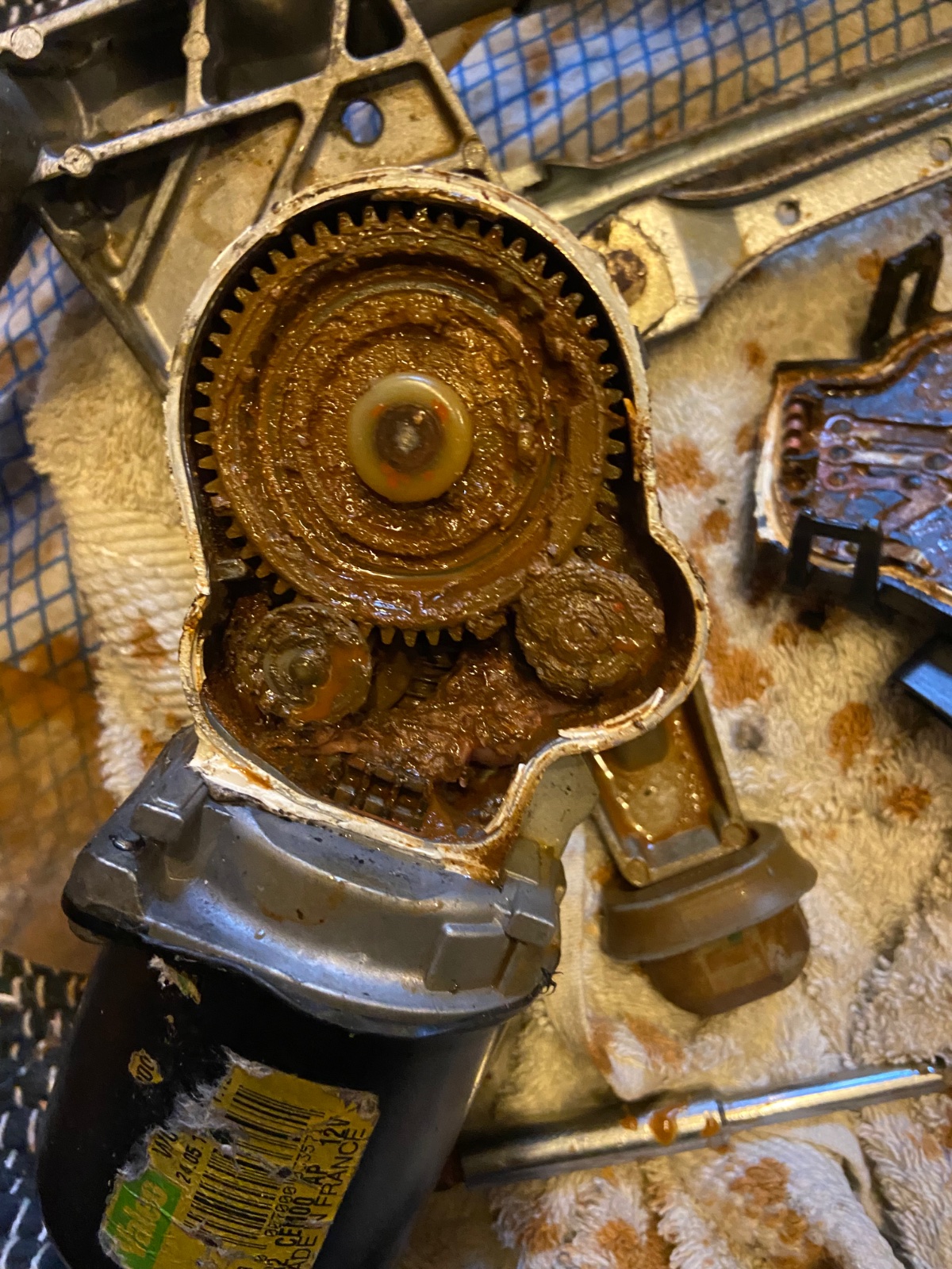

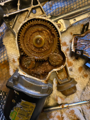

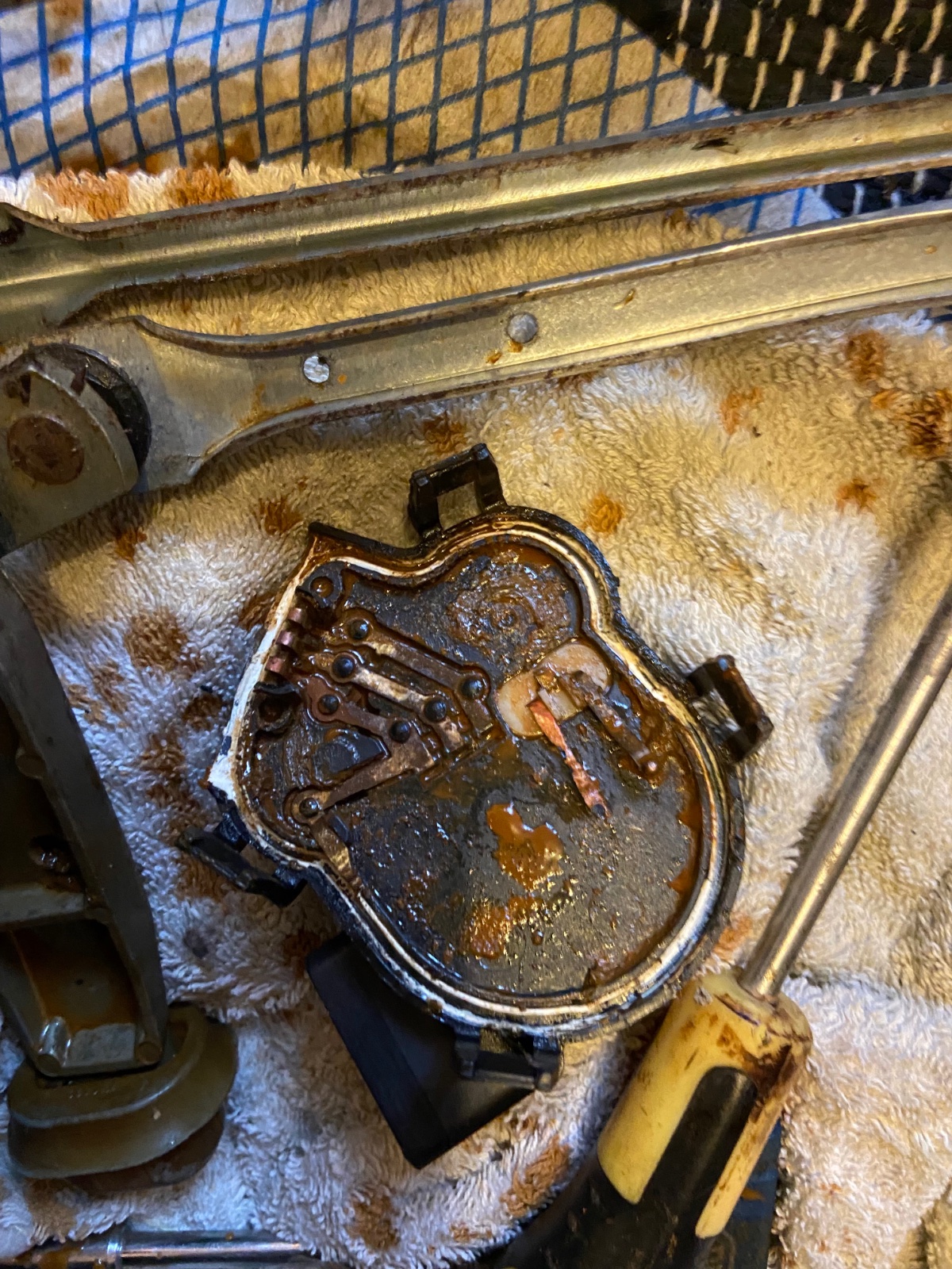

I took the motor out and disassembled it. This is what I found inside.
Posts: 28731
x 5672
Re: Citroen ds3 front wipers stop halfway
Not surprising that they didn't work.
