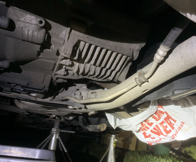

I’ve got to refill my ML6C gearbox, too. So, even if other changes aren’t present such as direct-acting concentric hydraulic release bearing instead of hydraulically operated fork, the ribs on the box are definitive for oil capacity?
image uploader
This is the end of my transmission, are those the mentioned ribs?
I lost at least 300ml+ when I accidentally pulled a driveshaft out and then drained 2.1 litres out, so I’m assuming when the clutch was changed a few years back, this capacity confusion caused the mechanic to overfill the box?
image uploader

Pop your VIN up so I can check the exact gearbox type.

Ok, so confirmed you have the 'reinforced' ML6C (the ML6C/R), on your 407 so:
| ML6C/R | Oil capacity |
| Drain and refill | 1,9 litre |
| After overhaul | 2,2 litres |

Thanks, that puts my mind at rest. Must’ve been overfilled before. I didn’t want to risk putting 1.9l in and destroying the box if it actually needed 2.6l.GiveMeABreak wrote: 04 Feb 2024, 11:48 Ok, so confirmed you have the 'reinforced' ML6C (the ML6C/R), on your 407 so:
ML6C/R Oil capacity Drain and refill 1,9 litre After overhaul 2,2 litres
Ironically, since I drained a total of 2.1 litres, I didn’t actually need to do anything after accidentally popping out the driveshaft. Oh well, it’ll benefit from the new oil I expect.
Thanks again
